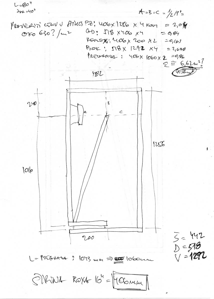

for Lorenz simple , common , 70L box but with extremely cunning and ingenious (hey , I'm ZM! ) DIY Variovent

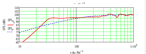

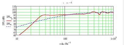

small ML TL will be so called bent construction , neto 240L , for tanns
those are ER 12" drivers
in fact , for my hearing (ZM is older than Dodo) they're FR
anyway - I still didn't hear anything (comparably by both size and philosophy ) from any other factory even close to them
these ARU-ed 70L boxes are most probably just temporary housing for them
they deserve best , so I'll made that one day, even if as just sport activity
