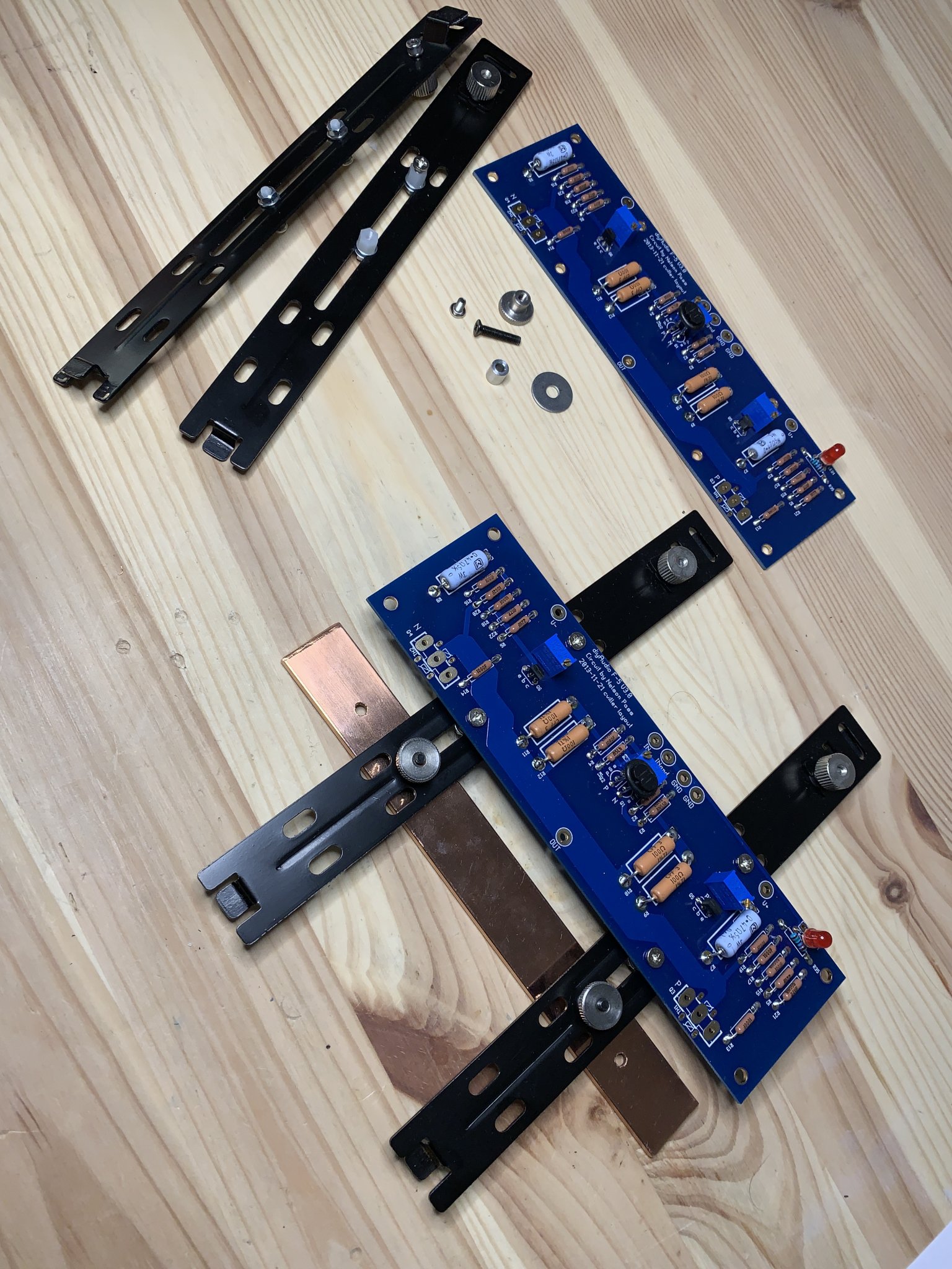

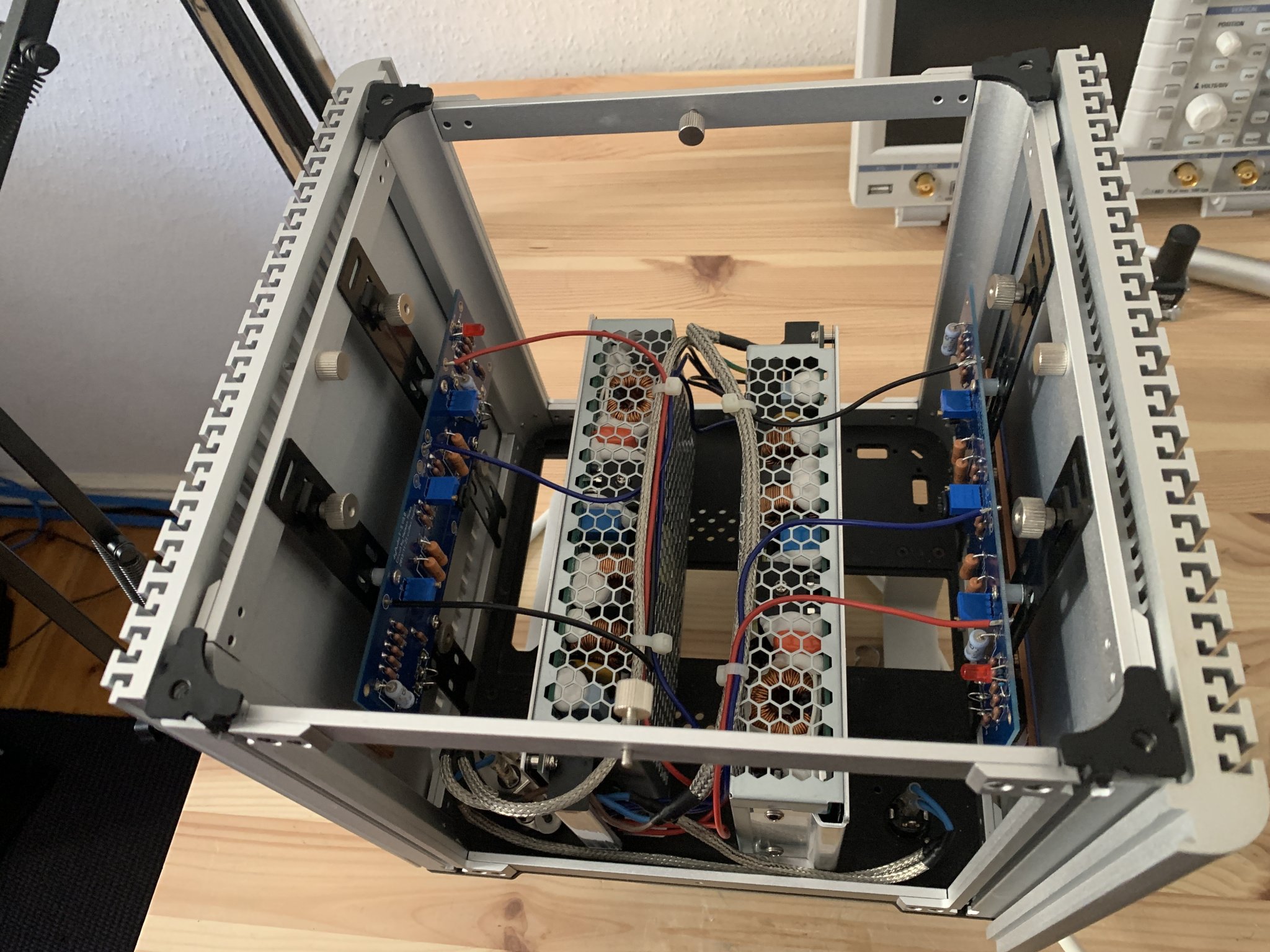

I am in process of completing my F5 build, which is based on the DB4. I am using two 200W switching mode PSUs, one for each 24V rail.
It appears to work and it is not getting too hot. Compared to the ACA it is a little bit hotter, but I have not installed the final thermal pads yet. So there is headroom.

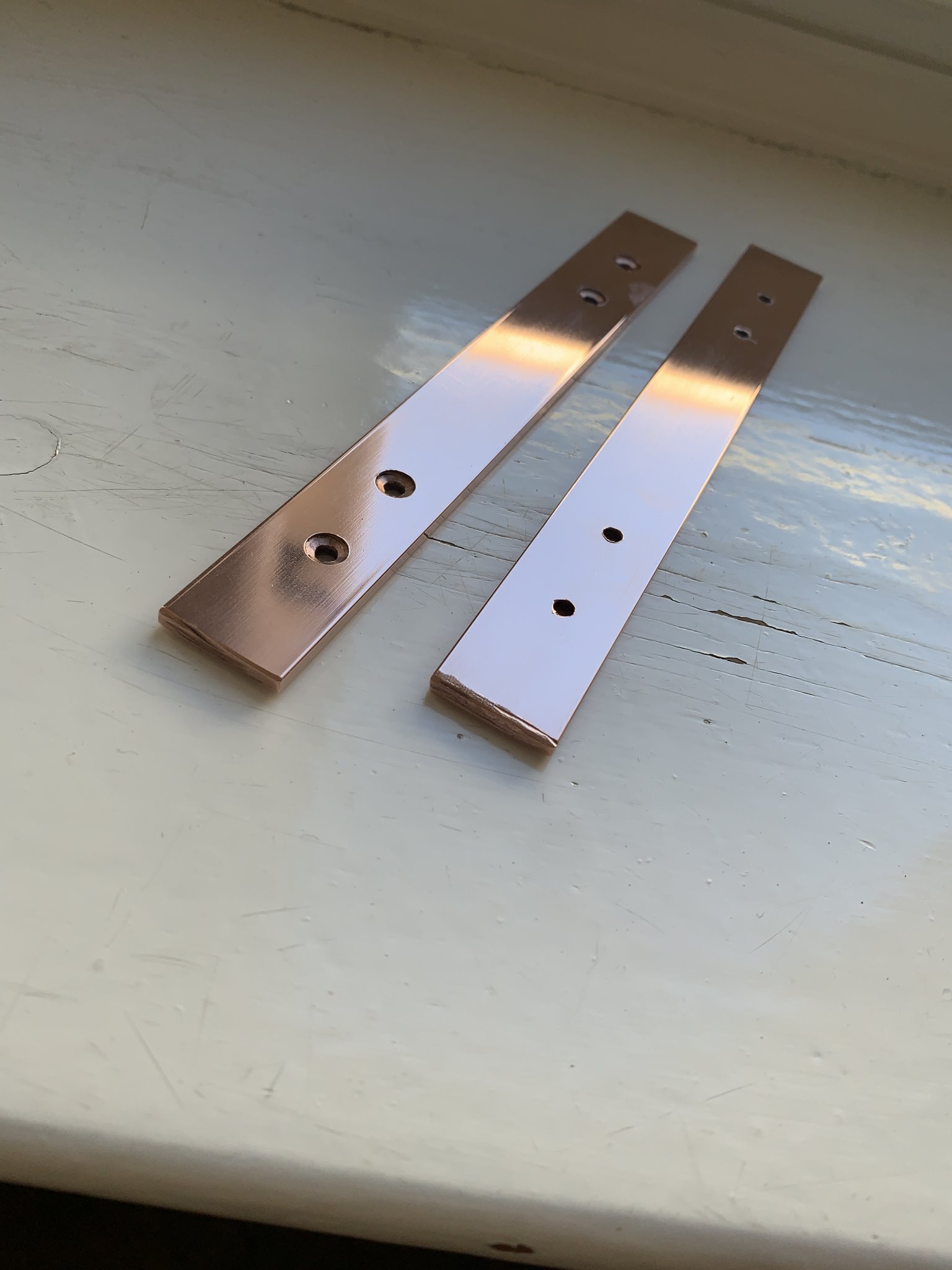

Yes, I did use the brackets, but only the brackets.Did you use Strecom’s system of brackets and clamps to connect the output fets to the chassis wall?
I polished two pieces of copper and drilled them, that's all. The copper connects to the case with large thermal pads.
