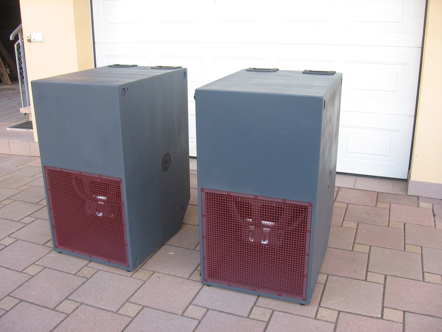

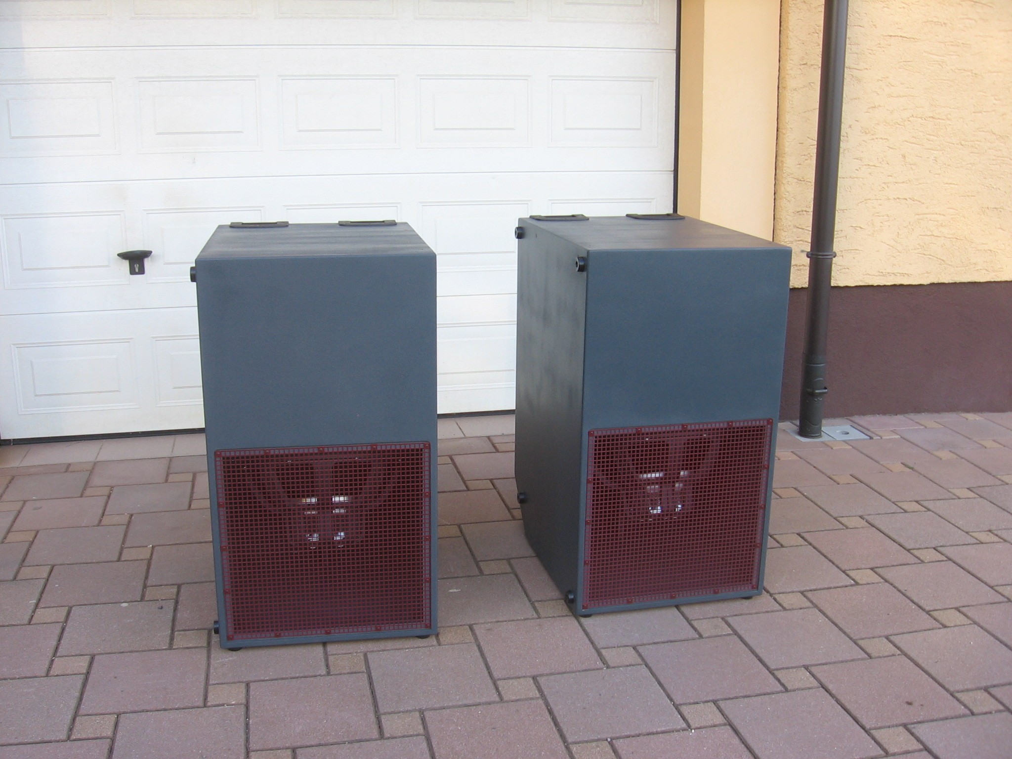

Hallo!
I'm new to the forum. Thanks to the administrator for signing up.
I made two TH 18. I used Faith pro 18xl1500 8ohm. Feelings are very good. They will be used to perform live music in the open air or in larger halls.
