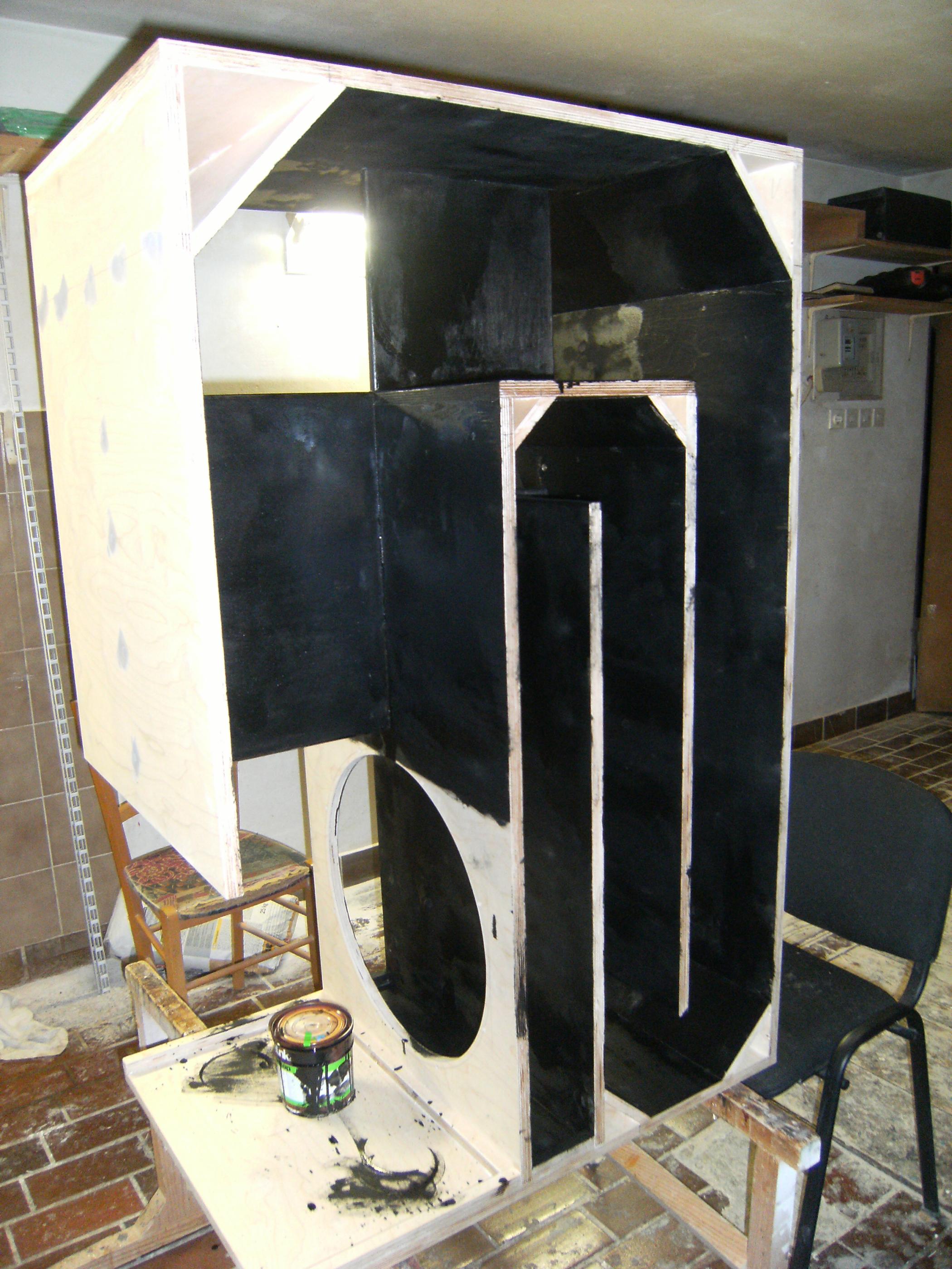

I have another good contender my TH-1819 vs Othorn
TH_1819 vs Othorn outside@1/2 space 1m (8 Ohm 2,83 Volts vs 4 Ohm 2,0 Volts driver)
TH_1819 vs Othorn delta TH_1819
20 Hz 88.09 81.34 + 6.75 dB
25 Hz 93.54 89.77 + 3.77 dB
30 Hz 95.74 96.12 - 0.38 dB
35 Hz 96.74 98.13 - 1.39 dB
40 Hz 97.44 97.86 - 0.42 dB
45 Hz 98.10 97.51 + 0.59 dB
50 Hz 98.76 97.38 + 1.38 dB
55 Hz 99.33 97.44 + 1.89 dB
60 Hz 99.53 97.61 + 1.92 dB
65 Hz 98.91 97.83 + 1.08 dB
70 Hz 97.38 98.04 - 0.66 dB
75 Hz 95.67 98.16 - 2.49 dB
do you have the fold layout?
