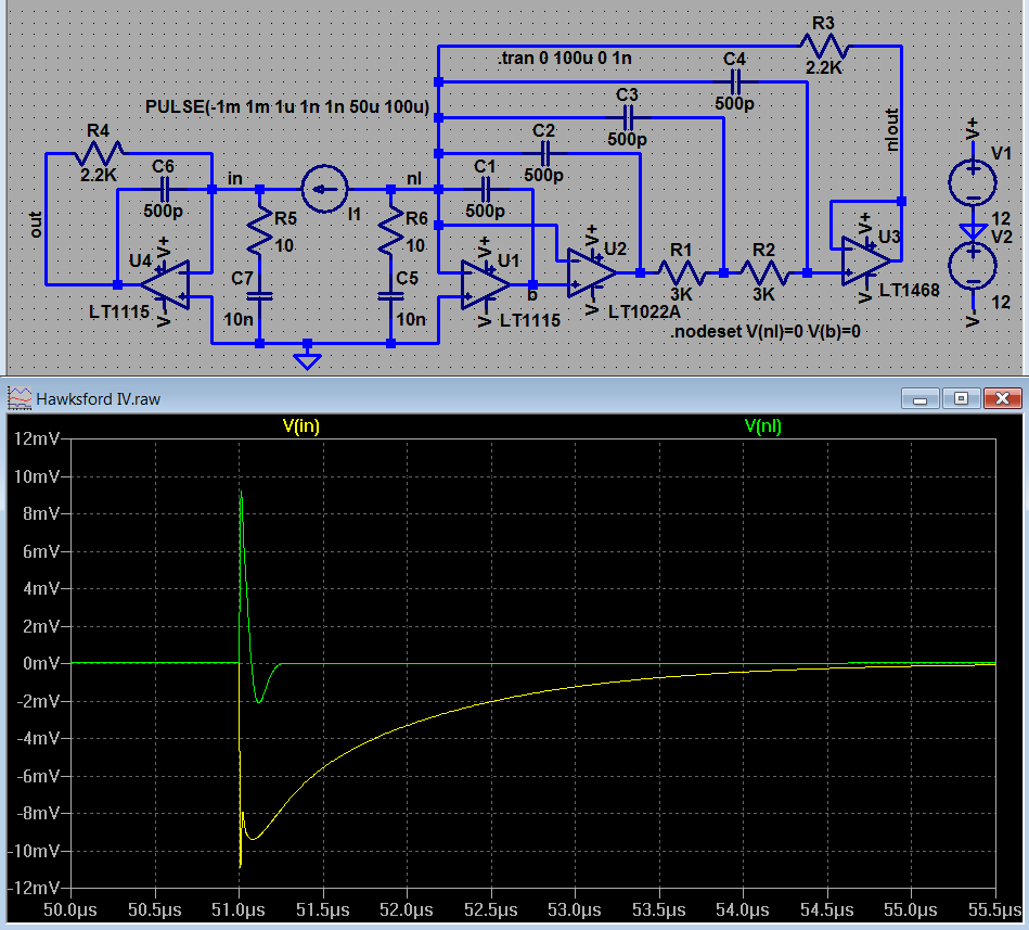

I found a way to make the sim of Hawksford's nested op amp I/V in the last section of the paper finally work: http://www.essex.ac.uk/csee/researc...Current steering transimpedance amplifier.pdf
people always want to make the discrete I/V but no one discusses the nested loop op amp I/V
adding the RC across the DAC input finally killed the oscillation I've always seen before in sim - clearly there are some constraints hidden in the "pre-filter" box
I juiced up the op amp choices with Lt supplied models - LT1115 is a low noise, fast, unity gain compensated LT1028 speced for audio
I moved the U2 op amp -in connection which seems to give better damping
the sim plots the input error V of the nested and a single LT1115 I/V with a 2 mA 1nS rise step input
the nested topology slightly reduces the peak error but hugely reduces the integrated error (green nested loop, yellow single op amp I/V, inverted response)

I don't think the noise gain is a problem for audio - the 10 nF * 2.2 KOhm corner is ~7 KHz, if you start multiplying ~ 1nV/sqrt(Hz) from there it won't impact weighted audio S/N
whether its an opportunity is a question - maybe decomp LT1028 or AD797 would work in the front end - personally I'd try the new ADA4898 with the Gilbert multi-tanh input linearization
the U2 op amp needed to be slower as you can see from the ~8 MHz GBW LT1022 there- but I can add local feedback and RC to cancel the zero and use a much hotter op amp in the sim in that position as well - higher output drive should be helpful in addition to allowing better tuning of the dynamics
so far I've just been poking around with the sim - obviously a analysis and design rules for filter pole position, stability would be good
- does seem to work with the "not exactly unity gain stable" LT1028 in U1 position

single pole is "droopy" and its possible stringing too many even >100 KHz 1st order poles will eventually have a effect on audio highs
Hawksford's nested op amp I/V is a 2nd order ~ Butterworth - I would always recommend designing in maximally flat filter responses, matching up any single pole with higher Q biquad sections to prevent audio frequency roll off
in sim, and likely real life the U3 unity buffer seems to limit audio frequency linearity - full signal common mode V causes input distortion with 6K source resistance

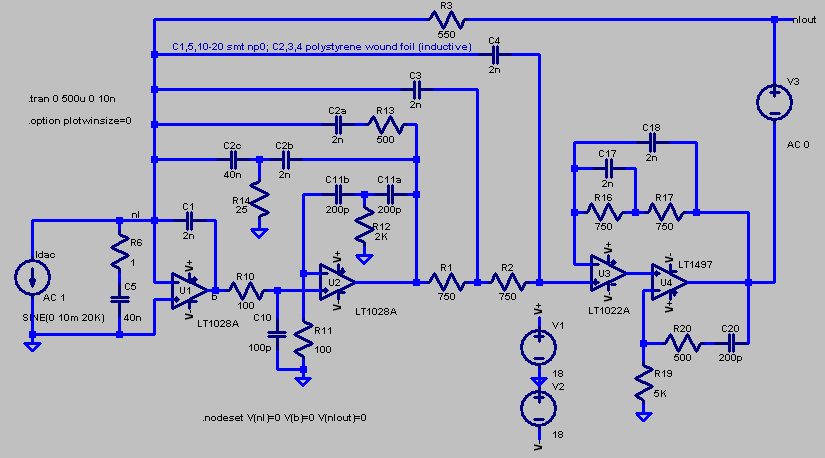

a little more circuit sim...
working towards a better implementation of the Hawksford nested loop I/V I’ve added a few tricks to the basic circuit
I impedance scaled the 1st post’s circuit values to be more appropriate for the PCM1794 under discussion in another thread
U1 op amp is the error summer for the whole loop – input linearity is paramount, intrinsic op amp input diff pair stage linearity and keeping error V low are the available tools
The ADA4898 is a new option for low V noise, extended input linearity with speed and high “linear output current”; definitely 1st choice on tech specs for U1 position – the sim uses LT1028 due to the unavailability of a ADA4898 spice model
The “noise gain” shunt R6,C5 can passively soak up some of the fast edge from the DAC – limited by the requirement for damping R8 and component/layout parasitic esl
At DAC switching glitch edge frequencies C1 (smt NP0/C0G) shorts the input to the U1 op amp output – creating fast rising current demand from the U1 output – indicating a need for fast op amp, possible Class A bias, or composite with extra buffer in loop – I choose a fast op amp for the sim
the Hawksford circuit’s additional gain loop reduces the error V at U1 input after a few 100 nS by adding current to the summing node through C2,3,4 and finally for audio frequencies the feedback R, R3
U1 output doesn’t swing more than 10s of mV so U1 can run at reduced supply V for lower self-heating and noise – local subregulated supplies for U1 are a practical audiophile tweak with possible benefits
again at high frequencies “C2” shorts the input to the U2 op amp output so the same op amp output impedance concerns apply as for U1 – but U2 needs to be slower for overall I/V circuit stability – I choose to use local feedback giving high frequency integrator response to allow a faster op amp to be used here in hopes that a high speed U2 op amp will have lower output Z, the sim shows U2 output current demand peaking @~150% the DAC input delta I step – simmed with fast LT1028 op amp
“C2” is a passive composite – C2b,c are the high speed path and these caps should be smt NP0/C0G
R14 shunts audio frequencies possibly distorted by C2b
the lower frequency signals pass thru C2a which can be a polystyrene wound foil type – which has excellent audio distortion properties but too much esl for the job of soaking up fast DAC edges
C3,4 also handle “slow” signals due to the series R1,2 and can be wound foil polystyrene
“U3” follower errors can limit the linearity of the circuit – so a composite is used in this position – by balancing the source/feedback impedance the nonlinear common mode input Z errors of FET input op amps are avoided, then the modified integrator U4 CFA amp inside the U3 feedback loop buffers the output load and provides high audio frequency loop gain, U3’s FET input diff pair is presumably more immune to the remaining feedthrough V spikes than a bjt diff pair – U3 LT1022 FET input op amp used in the sim is broadly similar to the popular OPA132/4 series
U4 provides gain and output buffering inside the U3 unity feedback loop - the sim's LT1497 is one of Linear's A/DSL driver CFA op amps
while many real op amp distortion generating mechanisms are not properly simulated some input stage and loop gain related issues are – with the measures taken the sim shows ~ -130 dB 2nd harmonic distortion, decreasing higher harmonics with “mono” PCM1794 DAC 20KHz full scale signal level

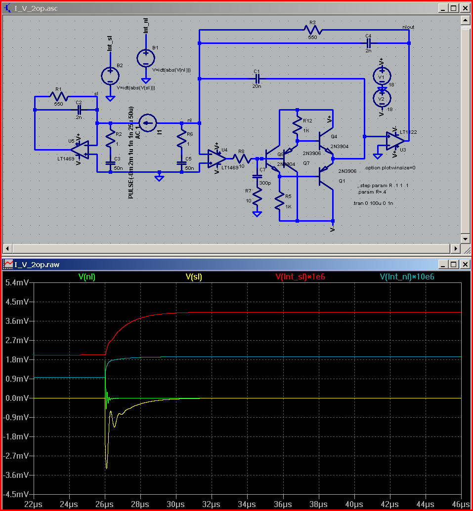

In response to some PM interest I'm posting a simpler 2 op amp nested I/V I hacked out of the earlier Hawksford nested feedback multiloop I/V sim
I am not as knowledgeable on these circuits as I'd like to be before posting circuits but I have lucked on a few configurations that appear to work in sim
I believe Hawksford is drawing inspiration from higher order Sigma-Delta converter noise shaping filters - I would look in that field's literature for guidance on these nested feedback topologies, their design equations for stability, transfer functions
below a fast (90 MHz GBW) input op amp is supplemented with a diamond buffer – mostly because I don't believe the Spice macromodel's output - many just use controlled ideal source connected to gnd internally
“noise gain” input shunting series RC, fast input op amp, heavy local C feedback are attempts to minimize the input delta V, magnitude*time product as a quality measure
the slower output op amp drives the outer feedback R || C giving a higher order response, reducing the input error transient duration vs the single fast op amp sim to the left added for comparison
clearly there are some stability conditions on relative op amp GBW, input, nested feedback component values - which I haven't worked out – I'm just playing around, inspired by Hawkford's example circuit
the “figure of merit” I am using is the input error transient, |magnitude|*time product – I've added a pair of BV to calculate the input transient absolute value time integral – the 2 op amp nested circuit improves this number by ~ 20x

free manufacturer macromodels can be far from realistic
the output is usually a spice controlled ideal source - no output transistor properties are simmed
which is poor for simming pulse performance of older op amp built on semi prcesses with slow pnp - if you look with a scope at the real chip' output for mA steps you can see the pnp pull down "feedthru zero" recovery edge is bigger, recovery is slower
even with the modern better complementary isolated Q processes the op amp models are often poor on output properties - more critical as Cload stability becomes an issue - I don't really trust the sims I've posted here due to the unrealistic output modeling

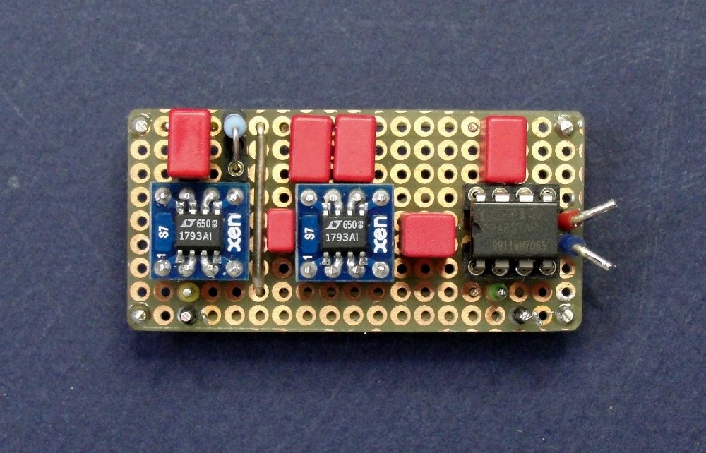

I was curious. So I built one (intended use measurement and not audio).
Tried a lot of opamp combinations.
Only managed to get it stable from oscillations with OPA627 / LT1793 / LT1793.
And even then only with one set of Riv / Civ values of 1k / 680p.
Changing to e.g. 499R and it oscillates again.
Too fiddly for me. ;)
Patrick

Yeah; ive gazed longingly at this design for years, always coming to the conclusion that it would be far too much work for my liking and even then not guaranteed to get the results I want with my level of experience; due to the obvious complexity. I revisit it every 12 months or so, but today I reached the same conclusion I always do; even though my skill level increases each time I look and Now that Patrick has reached the same end. I think this is the last time i'll do so :) thanks for the confirmation that its just too finicky to be truly useful.
LTSpice is quite capable of simulating many things, but the results are as good as the quality of the active models used.
For this type of nsec impulse response, the available models are totally inadequate and only measurements can reveal the true characteristics.
I did both in another thread for an I/V converter, but results between sim and measurement showed how useless the sims were.
