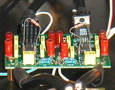

Nuuk said:I may have misunderstood what Joe is saying here but I thought the return wire from the speaker always went to the junction of the two 1000 uF caps anyway (as shown below where the thicker blue wire is the one in question).
[/IMG]
You are right Nick. This is good practice, but more than that, as I'm trying to illustrate. By having those caps right on the chip V+ and V- they now perform an additional task. Look at a lot of amps where big reservoir caps are many inches away. In ALL opamp ICs this becomes much more critical than discrete amps. It has to be because of the internal compensation used by all opamps. The way it's done means that one of the rails have to become a 'ground.' Normal grounding is bad enough, but in opamps... yikes!
The beauty of those 1000uF caps being so close to the 3878 power in pins, they now perform an additional task that normally reservoir caps/electros don't. It greatly simplifies critical opamp grounding. I use Panasonic, many others do as well. Does Sakura/47 Labs use 'naked' Black Gates or something? If they do, these are very good electro caps with good HF performance. Now HF return currents are ably dealt with and no additional components required. On the other hand, if we had remote reservoir caps, we would have to put our thinking caps on (the other kind of cap - or should I say 'hat').
BTW, the 3875 spec sheet shows clearly the internal comp cap has a negative' voltage across it, thus the V- is our pseudo ground, or Clayton's Ground, the ground you have when you don't have a ground.

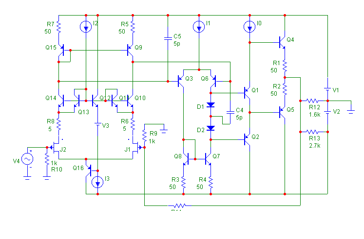

OK - I have done it. It does not work for every opamp. But it does work for the OPA627.
My application is the voltage stage in my new amplifier project (error correction amp). The opamp is supplied from +/-18.5V (LM117+LM337). I have chosen the 2.7k resistor from the opamp output to -Vs.
For OPA627, the improvement is substantial. The effect is in clearer mids and highs and the overall resolution for the complex music. The music is more liquid. And the "tail" dissappears. Absolutely positive, nothing to complain. Only very very well designed discrete circuit is capable to give same sound quality as OPA627 with increased Iq.
The biasing against -Vs does not work for AD797 and brings no effect for OPA134.

I have finally simulated the whole OPA627 circuitry and can confirm that resistor from output to -Vs changes the mode of operation of the output stage so that only upper transistor works, in SE class A. This is true until load does not suck that much current in negative polarity that lower transistor must open and deliver it. That means that proper value of biasing resistor depends on load resistor, heavier load needs lower value of biasing resistor. But do not overheat the chip.

You should bring any evidence for what you are saying, not only feelings. Me, I can show 2 images.
1st: this is an OPA627 circuit with NFB for gain +10. Rload = 1.6k, R bias = 2.7k.
