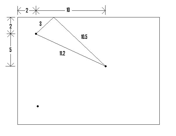

Rybaudio said:graaf, see attached
is Your normal "listening position" really two feet from the side-wall facing the speaker along the wall? and what about the other speaker?
or are You joking?

Example : if the speaker is at 2ft (0.6m) from walls and the listener at 16ft from speaker, the approximative difference between direct sound and the reflection from sidewall is about 2.1ft and the one from back wall is about 3.4ft.

I'm sorry - I got suggested by Rybaudio "attached image"
clearly what You have described is a different case
but I wonder how You got this result: "about 2.1ft and the one from back wall is about 3.4ft"?
after all it is a function of the listener's distance from the walls and that is also the question of the listener's distance from stereo base and of the angle of stereo triangle
What assumptions have You made?

(...) I simply posted an easy to calculate case that illustrates how a reflection can have a path length difference of less than the objects distance from the source. I think I misunderstood you; I thought you were asking something more basic than you were. The floor reflection is the only early reflection that is approximated by the previous drawing I attached.
If you are asking about the first horizontal reflections in typical configurations in rectangular rooms I'm inclined to agree with you that the reflections have a path length difference close to their distance from the walls. I've attached another image of a case of this.
thank You so much for clarification and for both drawings

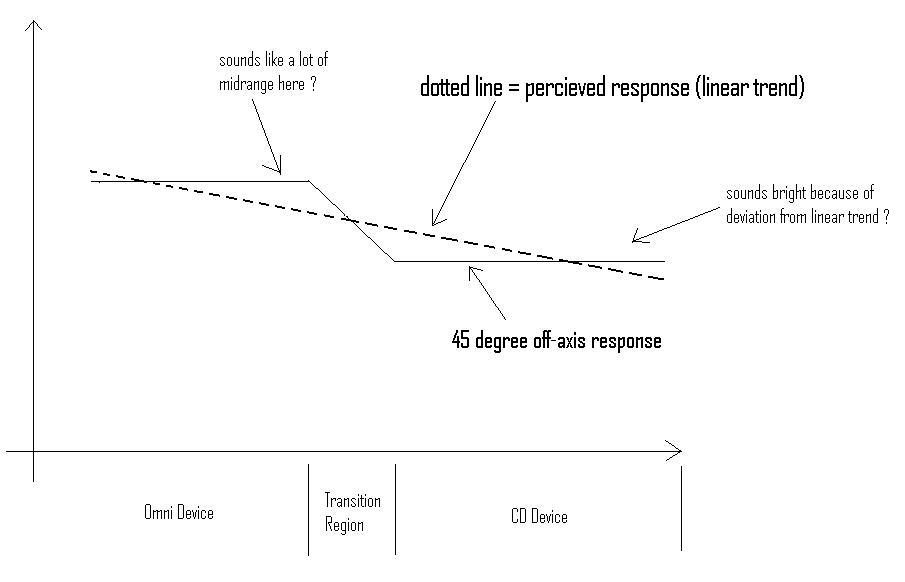

I'd like to bring this thread back to the top and pose a question that I've had in my mind for some time but haven't quite been able to word well. I still don't think I can but here's a shot.
For the most part there is a consensus that in order for a loudspeaker to sound good the sound it radiates in every direction needs to have a smooth and either flat or downward tilted frequency response, and the first copy of the sound coming in must be flat or slightly downward tilted. One thus designs a speaker such that the family of FRs in all directions are optimized together, with the listening window being approximately flat and the off-axis responses downward tilted. My question pertains to the off-axis responses that are downard tilted.
What I'm trying to ask is when we hear those reflections coming in, do we "hear" the general linear trend of the FR and then local anomolies are the deviations from that, or is it something else? Wow, unless you already have thought of this, it is probably not clear what I mean by that. A motivating example might help things. Suppose we use a woofer down low mated to a constant directivity device such as a horn. Off-axis the response is flat until the woofer narrows and then it is mated smoothly to the CD device where the directivity of the piston matches that of the device. There are no discontinuities in the response curves, and they are downward tilted, but what I am asking is do we "hear" the response in general as the line that would be fitted to the data and then deviations from that line are percieved as anomilies in the response just as anomolies from flat are heard in the listening window, or how exactly do we percieve this? I've attached a (crude) picture that may clarify what I am trying to ask. Maybe I can phrase this another way- is it bad for the off-axis responses to be concave up in any region? That doesn't fully capture what I am trying to ask but it is close.
I suppose what I really should do is just hook up a pair of headphones to an EQ and test this out, but I'm curious what you all have to say.

Rybaudio said:I'd like to bring this thread back to the top and pose a question that I've had in my mind for some time but haven't quite been able to word well. I still don't think I can but here's a shot.
In my opinion your premiss is wrong and hence the question has no answer. I DO NOT agree that an upward or downward tilt to the FR either on axis or off axis is acceptable. I claim that all the curves must be smooth AND flat and that they must have lower amplitudes as they progress off axis. This then makes your question mute doesn't it?

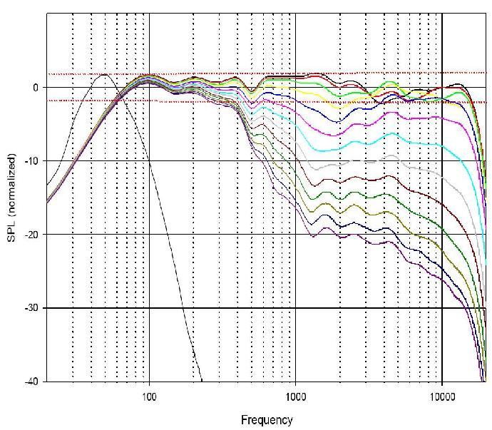

I have attached a copy of the picture you attached in the other thread of the set of responses for your Summa system. It certainly looks to me like the curves are more and more downward tilted as you go further and further off-axis. For example, in the furthest curve (90 deg?) there is a ~26 dB drop from 100 Hz to 10 kHz. Is that not a spectral tilt? Maybe we are working under different definitions of spectral tilt.
Rybaudio said:I have attached a copy of the picture you attached in the other thread of the set of responses for your Summa system. It certainly looks to me like the curves are more and more downward tilted as you go further and further off-axis. For example, in the furthest curve (90 deg?) there is a ~26 dB drop from 100 Hz to 10 kHz. Is that not a spectral tilt? Maybe we are working under different definitions of spectral tilt.
This "tilt" as you call it, implies "beaming" which the Summa does do to a certain extent. But you must consider that virtually any other speaker available will "beam" even more than this. It was your comment "a HUGE spectral tilt beyond 30 degrees " that got my attention, simply because the "spectral tilt" of the Summa is less than virtually any other loudspeaker made. So where does your comment come from?
You obviously have not seen polar maps for many other speakers if you can think that the Summa has a "HUGE (Bold in your original) spectral tilt. You cannot use 100 Hz as a basis, since that is below the waveguides usage. Use 1000 Hz. to 10 kHz and compare this difference with any direct radiator loudspeaker. This is the frequency range that matters and in this range I would put the Summa up against any loudspeaker that you want to name for "spectral flatness" across the polar range.
Perhaps we are working from different deffinitions, Mine are based on what matters subjectively not some "concept" of perfection.

gedlee said:This "tilt" as you call it, implies "beaming" which the Summa does do to a certain extent. But you must consider that virtually any other speaker available will "beam" even more than this. It was your comment "a HUGE spectral tilt beyond 30 degrees " that got my attention, simply because the "spectral tilt" of the Summa is less than virtually any other loudspeaker made. So where does your comment come from?
That comment was in response to your comment that "I DO NOT agree that an upward or downward tilt to the FR either on axis or off axis is acceptable." I just thought it was strange that you would say that given the design of your speaker. I'm guessing that you meant that comment to apply strictly to the 1-10 kHz region.
If the 1-10 kHz region is considered, yes I suppose it is less than virtually any speaker out there. I was thinking globally (100-10k), where the wide radiation of the dome tweeter would give less tilt. For example, if you mated a 1" dome with a 4" midrange at 2.5 kHz and that to a 15 at 400 Hz you would have a system that at 45 degrees off axis was flat to about 5k and then gently sloped down to about -3dB at 10k, which corresponds to less "global" spectral tilt than the Summa (-3 dB as opposed to -6 dB), but more tilt in the 1-10k region. I guess I am just used to thinking of the full 100-10k and this affects the language I use to describe the behavior of the speaker.
gedlee said:You obviously have not seen polar maps for many other speakers if you can think that the Summa has a "HUGE (Bold in your original) spectral tilt.
I have worked for a Harman company on a couple occasions and had access to their measurement database. Does 500+ speakers count? Sorry to be a wise-a$$ In all honesty though, I only examined maybe 200 of them. I made the HUGE comment just because you said no upward or downward tilt is acceptable, and compared to flat, a 6 dB tilt seems like quite a bit to me (imagine a speaker that had that slope on-axis).
gedlee said:You cannot use 100 Hz as a basis, since that is below the waveguides usage. Use 1000 Hz. to 10 kHz and compare this difference with any direct radiator loudspeaker. This is the frequency range that matters and in this range I would put the Summa up against any loudspeaker that you want to name for "spectral flatness" across the polar range.
Sure; save for a really small tweeter that is omnidirectional past 10k, it looks as consistent as can be to me. My main concern is this range in the context of the entire spectrum. That gets back to the original question of mine, and if I'm understanding you correctly, your answer is to forget about the global linear trend and make sure 1-10k is flat, even if it means the power response of the speaker has a shape like that I posted above which is not a downward sloped line but a couple regions that are flat connected by a slope. For example, in your speaker your off-axis responses from 1-10k are flat, as opposed to putting a say 2-3 dB boost in the 1.5-2k region (not that you would want to do that anyway because it would put a sizable peak on axis) so that the off-axis responses more closely fit a downward sloped line in the context of the response from 100-10k Hz? Am I being clear what I am asking? Maybe it just doesn't make any sense.
I guess I just see closer to a line as smoother. If I remember correctly, Toole and Olive put out a paper in 2004 regarding a metric they developed for predicting subjective preference based on their measurements (direct, list wind, first refl, power, dir ind), and fits of these curves to lines (good if the curve fits a line well, and good if the line is shallowly sloped, but the fits were global). Maybe I just read the paper, heard them talk about it, and have continued to think that way since. I'll have to think about this more and take it into account in my future observations. Thanks.
graaf said:the point is that we NEVER hear those reflections (approximately 2 ms<50 ms) as such
what we hear is total SOUND and in normal room and with normal speaker placement those reflections above 2 ms contribute to the perceived level of sound (SPL) that is amplitude/frequency response and to nothing more
I'm not sure that it was clear what I meant by "hear" in that case. I did not mean that I can discern the sound as a reflection. I meant that it affects my perception of the overall tonality of the system, and based on your response I think we agree on that.
My question in the above post is essentially this- we can't make the off-axis response of the speaker globally flat. What shape should it have? Dr. Geddes as far as I can tell is reccomending that the highest priority be given to the 1-10k region where we want the off-axis response be as flat as possible, and to drop off amplitude wise as we go further and further off-axis. What I was trying to point out is that this leads to a power response that falls and then has a sort of plateau from 1-10k. My question is when we hear this do we percieve it compared to a downward tilted line (as in the above drawing) or not?
surely we do
my answer is that it is not at all necessary
what we need is "flat enough" plus much more important horizontal and vertical polar response "general pattern" plus most important "correct positioning" of the loudspeakers in the room
