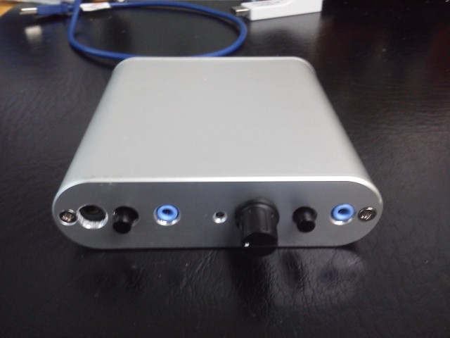

Just wanted to post some pictures. I find it cute, considering that is done by hand. I would comment that this is really an easy project, I did it, no brainer in two hours, ordering parts from Mouser. Case was purchased locally, and needed a bit of filing to allow the connectors in.
If you are wondering why you should not DC couple a battery operated preamp with something is not battery operated, look at the other picture. Still not sure what happened, but no other damage than what you see.
I had the signal generator of the pico tech 4262 connected to the O2 and the output of the O2 connected to a test channel of the F5.
I also did some measurement with my limited instrument, and this thing behaves really well. I also like the sound with my Audio Technica ATH-900 (40 ohm).

I'm guessing you created some sort of ugly ground loop with your test equipment. If both channels were connected you might want to replace the other 4556 as well just in case.

No, only one channel was connected. My scope has a generator that can give only 1V output, and I was thinking of using the O2 to have a bit more voltage to test amps with not much gain. Maybe I have to think it better, probably putting coupling caps on the cable I use for testing would make.
D.
Unlike amps with virtual grounds, the O2 has all the grounds at the same "true ground" potential (assuming you're not using a bench DC supply to run it). So there shouldn't be any DC risk with ground loops--i.e. coupling caps may not help. And you can safely put up to +/- 7 volts of DC into the input of the O2 without harm and none of it will make it to the 4556 op amps or output. So DC on the input is not a problem.
One big problem with Pico's instruments is most of them share the instrument ground with the PC's USB ground. And you mentioned other test equipment as well. If whatever was hooked to the O2's output was in any way connected to the PC or back to AC-line ground, you created a mammoth ground loop and all bets are off. You might have made it self oscillate that way.
It's also possible the input of the O2 was grounded back through the USB connection and whatever was on the output had significant AC leakage current (that "fuzzy" feeling when you touch something running on AC power that's not grounded). If you measure from such equipment to ground it's not uncommon to find 60+ volts of AC but at a high impedance so it's not actually dangerous to humans, but it can be to electronic gear caught in the middle.
That's why I use isolated scope inputs, isolated generator outputs, and why the dScope has fully isolated inputs and outputs not just from ground but from each other. Oftenn with grounded equipment like the Picoscope, the only way to break that loop is to use an audio ground loop isolator with a transformer in it (which will somewhat degrade the signal) or, and this is pretty cheesy, run the Picoscope from a battery powered laptop.
