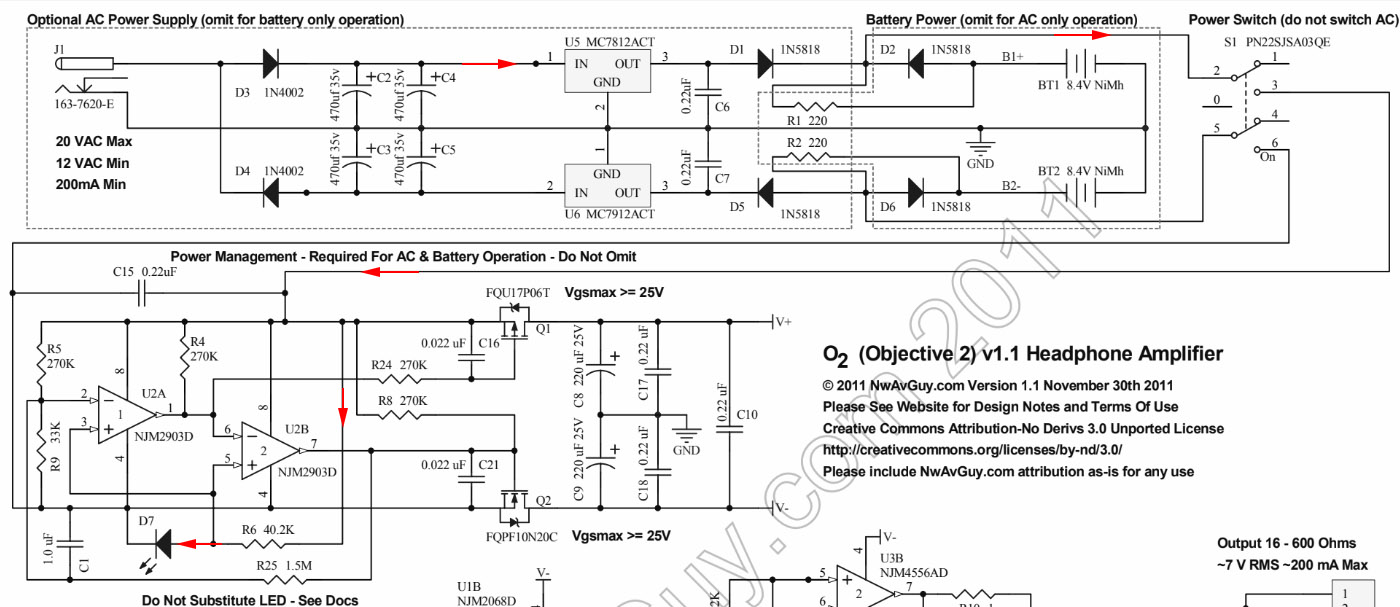

I'm having some hard time understanding the negative voltage rail and the 7912 voltage regulator operation in the circuit. I don't know if this is a dumb question, but where does the current flow after going through the led D7? (see attachment)

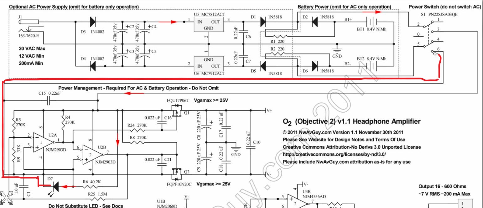

Thanks Mooly for your reply (post 5144)
The LED current returns into the negative rail like this. The 7812 generates a stable and clean plus 12 volt rail and the 7912 generates a minus 12 volt rail.
The LED and its series resistor are wired across this supply which is 24 volts in total.

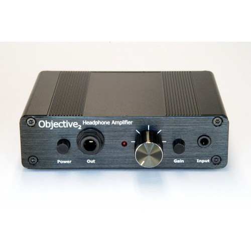

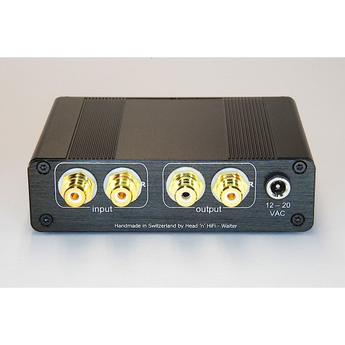

As Stefan has not seen fit to reply to my email, I wonder if anyone here can ID the type of bit used to open the case on Stefan's Head n HiFi desktop O2?
Anyone else notice the rear RCA in/outs are around backward to the way they should be? PCB layout should be from the front/top, and like a book it reads from the left, which puts Stefan's RCA sockets around backward to other HiFi gear.
Anyway, I've a fairly large selection of screwdriver bits, hex, torx and others but I've not been able to locate one that fits the O2 desktop amp.
If anyone can ID the type of bit required, or has opened one of these before, that would be great!
Any info appreciated.

About the screws, usually these are torx T8. And I don't understand why you think your RCAs are backward, they seem to reed L - R from left to right?
Rgrds
Thanks for the reply CHiroshi!
I couldn't find that piece of text at NwAvGuy's site, even though I'm sure I had read it before. Thanks again.
I will look into those torx bits (my set were too large) and that mod you mention and see if it is indeed the problem I have and report back with pics and repairs. Torx is not as common in Australia really, as other places. I see torx mostly on European imported cars here.
Edit: Aha, I've just heard from Stefan, a Torx T8 and a 1.27mm allen key for the volume knob, excellent work Stefan!
Re: RCA orientation
The RCA orientation is probably a silk screening error on Head n Hifi desktop O2s, it's a minor quibble really.
I carry my O2 with a mobile recording rig and often I am fumbling around the rear panel of USB interfaces (in the dark) and the O2 and notice their RCA orientation is inverted.

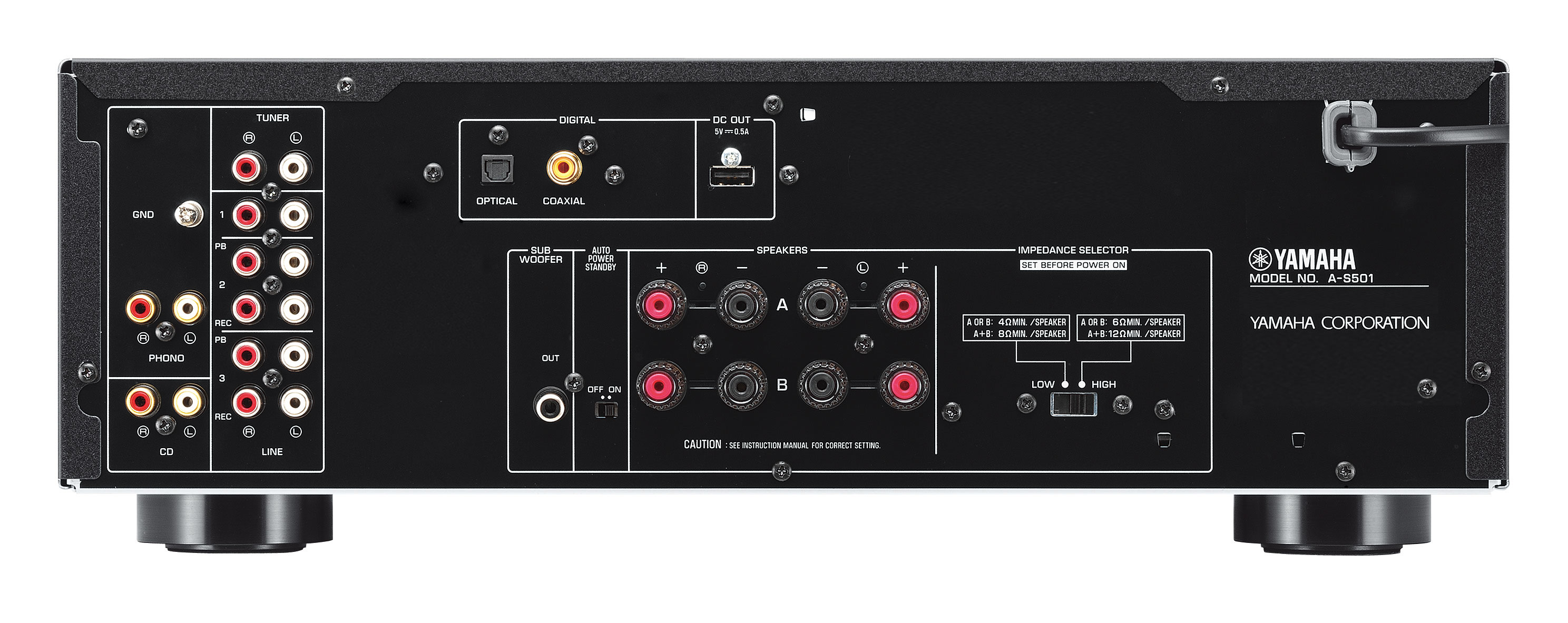

Just plugging in HiFi gear and mixing consoles for decades, when one leans over the back of gear to plug RCA cables in/out, rear RCAs are viewed (when viewed from above the piece of gear) from Left to right, (following PCB orientation) not when the gear is turned around with the rear panel facing the user, which is kind of inconvenient for remotes and control access! RCAs in rows usually look - White, Red, White Red, White, Red, for Amps, interfaces, DACs, all in rows, until you look at the O2 and it's the other way around, Red, White... if I've explained that well enough...
The O2 just looks odd sitting in a stack where it has the RCA cables colour codes inverted, makes me want to check polarity all the time!
Pics will show an example of standard RCA layouts (Yamaha).vs the O2.
