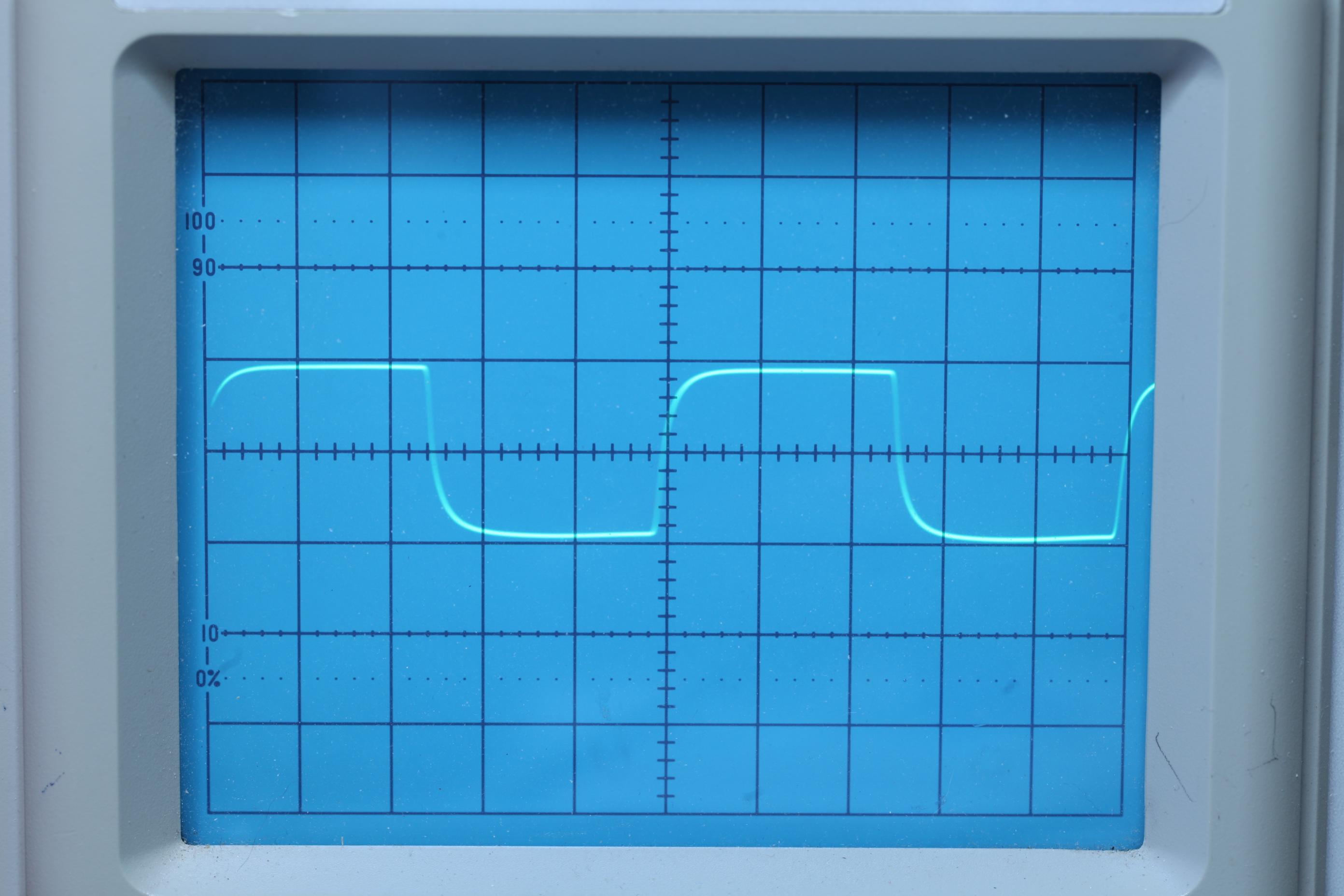

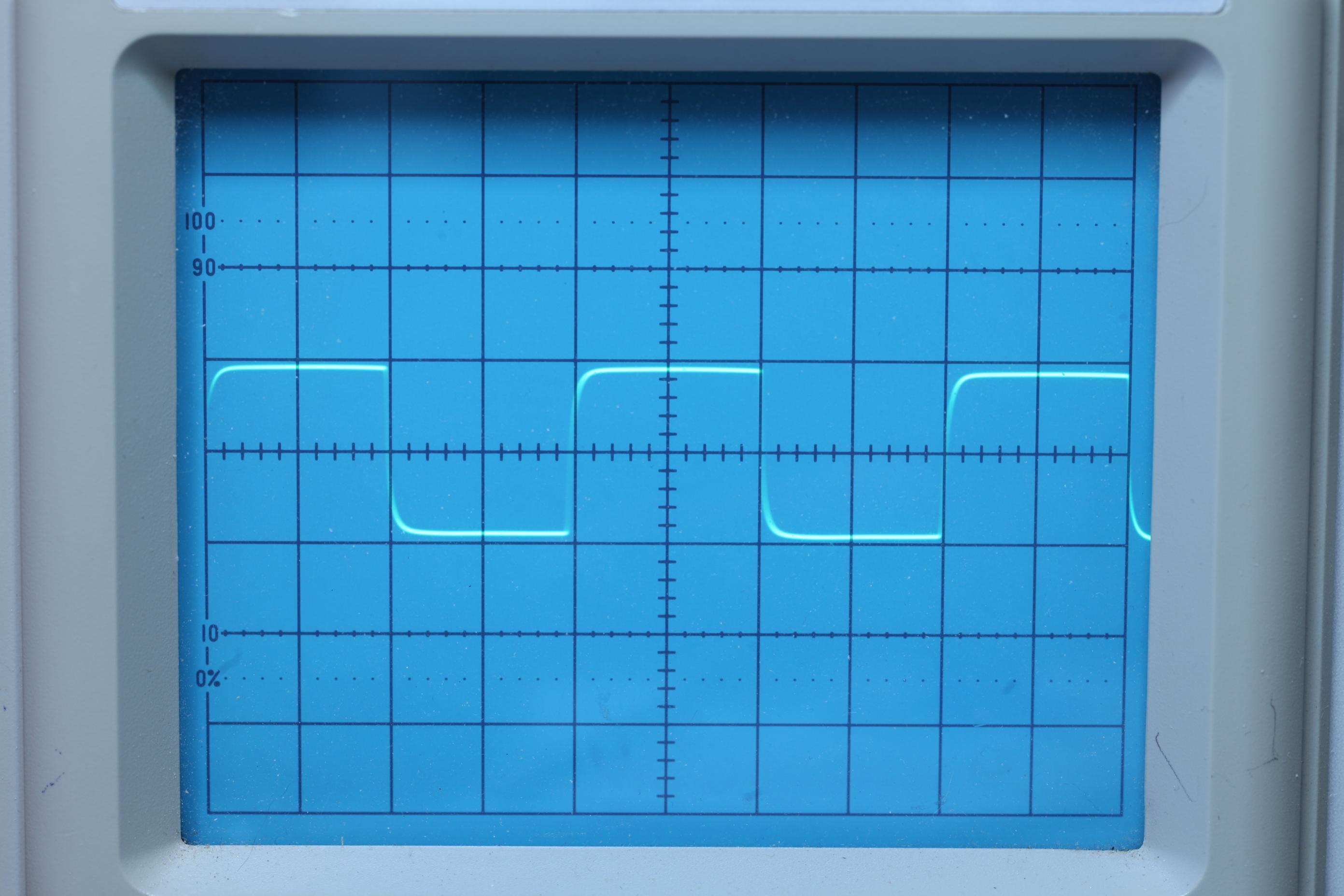

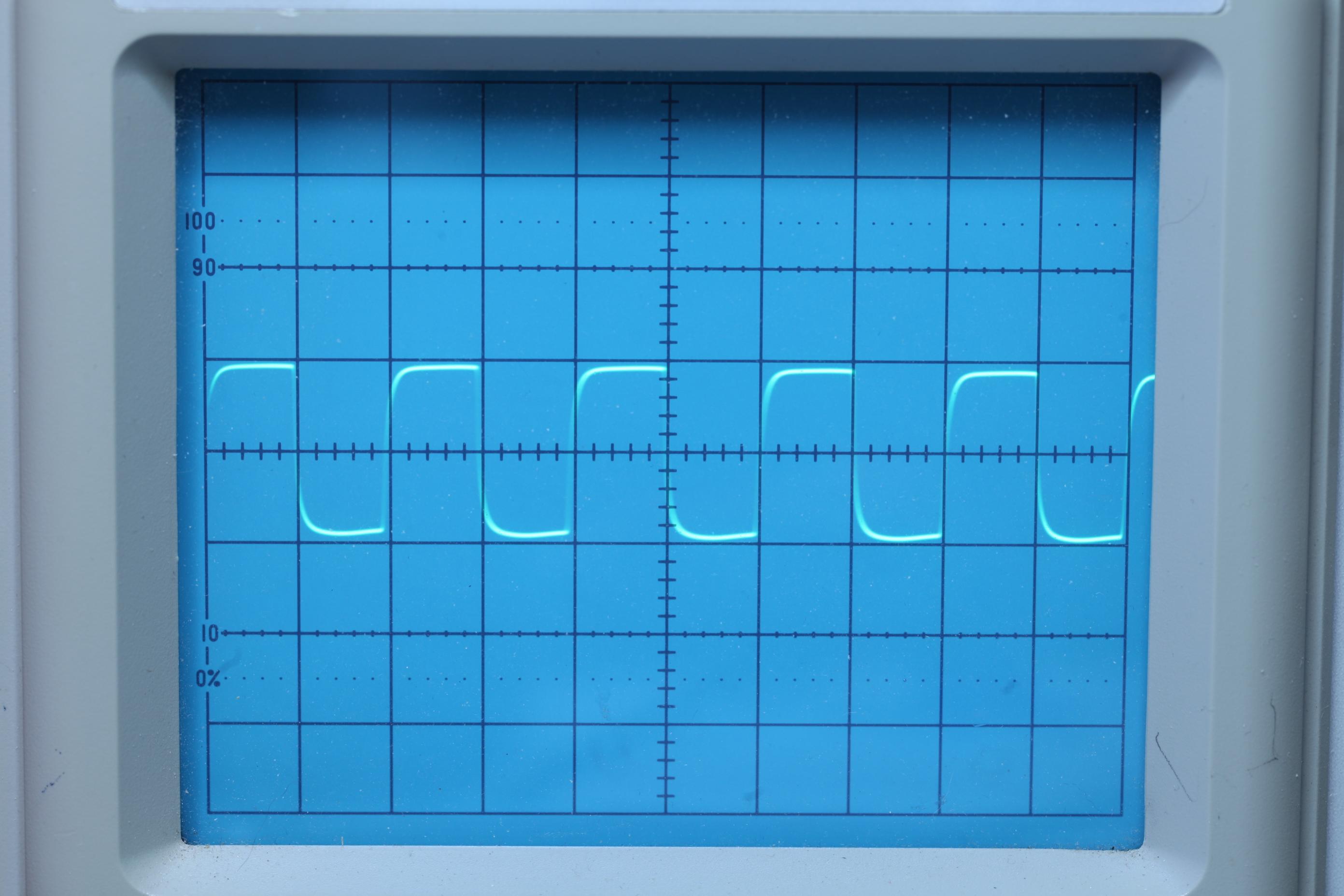

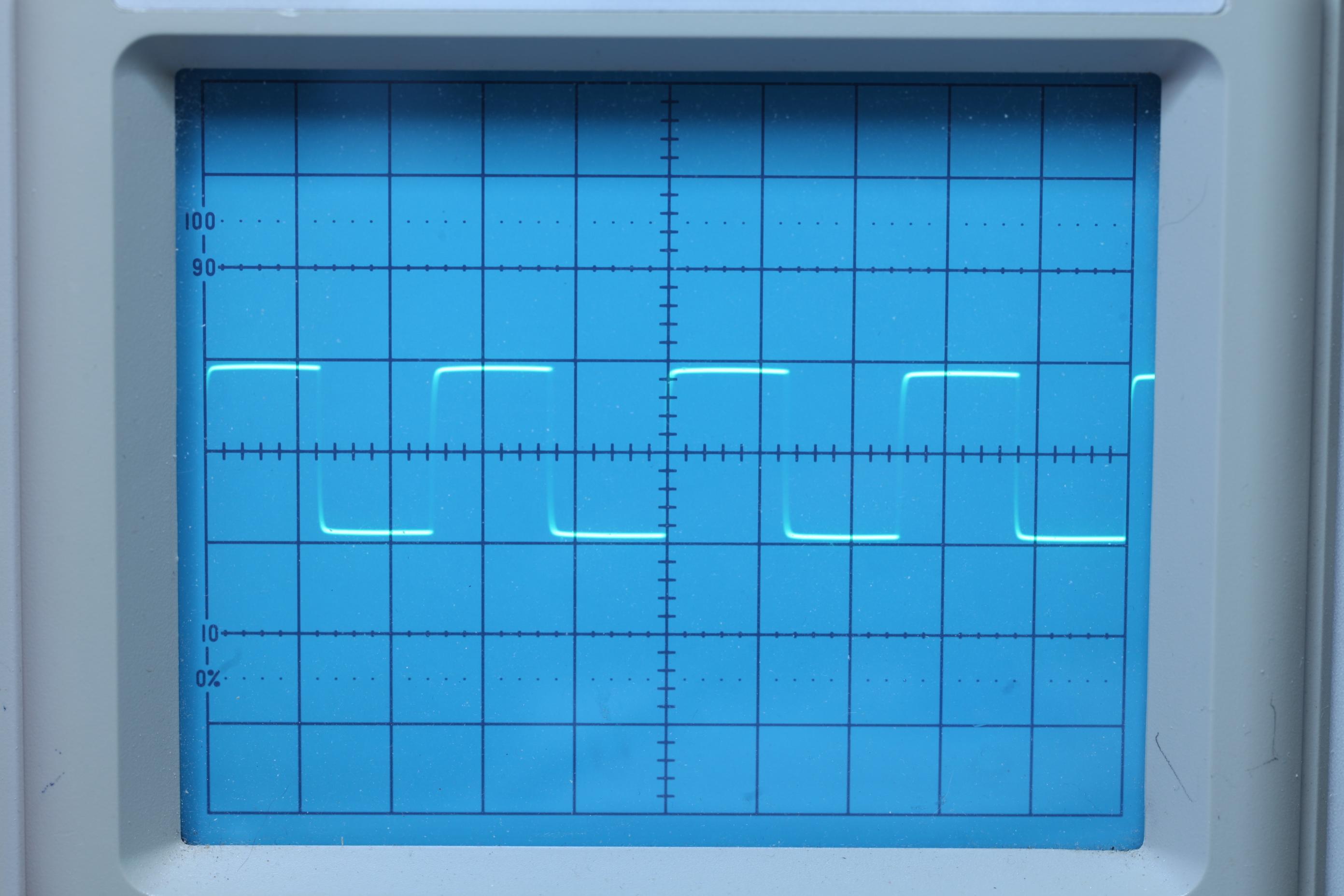

OPA1688
I've been following agdr's OPA1688 cmoy thread and have been planning to build his new cmoy for use at the office. I ordered 2 ea OPA1688 for that project, but instead they ended up in my O2 amp. It started as an experiment, but I'm sure I like the change so I'm going to order 2 more.
I removed the 2 ea NJM4556 and replaced them with 2 ea OPA1688s on DIP8 adapters. No other changes. To my ears it's clearly a sonic improvement. There is more bass, deeper and more solid. There might be a slight mid-range emphasis, I can;t tell about that, I only have one amp and can't switch back and forth quickly. But I do like the low end much better than before.
I did take some measurements. DC offset less than 1mV (100uV and 50uV). Square waves at 20KHz, 50KHz, and 100KHz look good, nice and fast, no ringing or other signs of instability (see attached).
Recommended if you would like more bass from your O2 amp.
Hey you tried it!! :D Great work. Very interesting results & square wave tests! Here are my ramblings about this swap to mlackey's good question a few days ago:
http://www.diyaudio.com/forums/head...round-headphone-relay-pcbs-4.html#post4842185
I have decided over the years that those NJM4556A's are "the problem" with the O2, especially regarding bass reproduction. Completely subjective on my part, admittedly, which I know would make NwAvGuy bang his head on the table. His detailed objective tests in his blog on the O2 all came out great across the full audio spectrum. But I've heard the difference with a Booster Board replacing those 4556A chips (OPA827 around LME49600 buffers) and something is up there, sonically, that isn't showing up in his measurements for some reason. Probably means there is some other measurement that matters which isn't being done. I have no idea what that would be though.
I'll have to try the OPA1688 swap-out myself!
Something to try: load the output with 470pF and 1nf with both 32R and 150R. It would be interesting to see how much Cload the paralleled OPA1688s on each channel can take before it loses phase margin, without that datasheet 47pF compensation cap. Being in parallel they should be half as sensitive as the single chip case in the OPA1688 datasheet, I would think.
