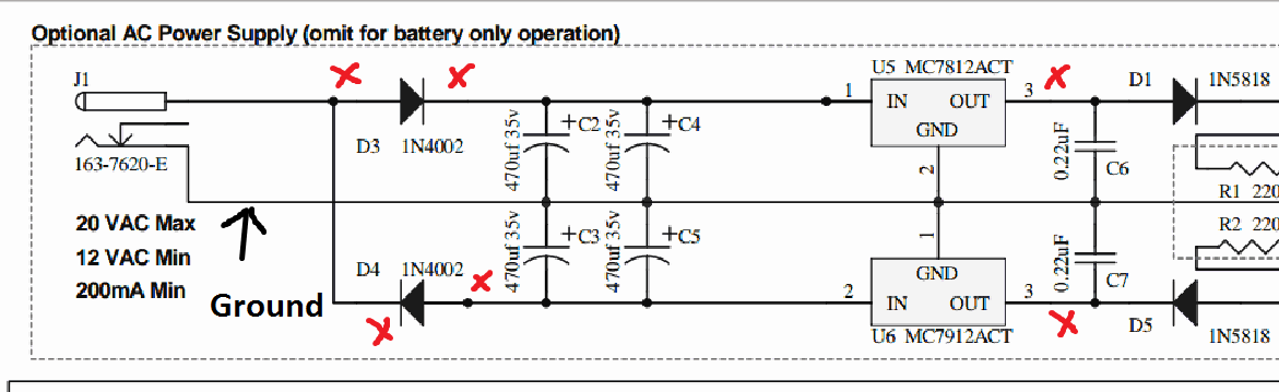

Ground is the point I have marked on the diagram here. So that carries through to the batteries where you have measured from which is fine. Reading from ground to all the points marked with a red cross should not give a 'short circuit reading'.
So the striped end of D3 (that should be the end that goes to C3 and C4) should not read as low as you are getting. That indicates a short which is either caused by something physical (a solder blob) or a faulty reg or a faulty cap (C3/C4).

alright i have my new psu hooked up with the low volt bulb (and its glowing but not much), here's the result:
  • non-striped end of D3: -6,6
  • striped end of D3: 0, no response on DMM :confused:
  • non-striped end of D4: -18,52
  • Striped end of D1: 0, no response on DMM :confused:
  • non-striped end of D5: -11,87
readings are done with no U1-U4 and no batteries with S1 Off.

Your readings show the minus 12 volt rail is OK. That's D4, U6 and D5. So that looks good to go.
The plus 12 volts is missing but the readings are little odd.
D4 striped end and D3 non striped end should have continuity between them. So check that is OK. I'm assuming D3 is running cold (it should). Check continuity between D3 striped end and pin 1 of the 12 volt regulator.
If all that is OK then D3 looks to be faulty in some way.

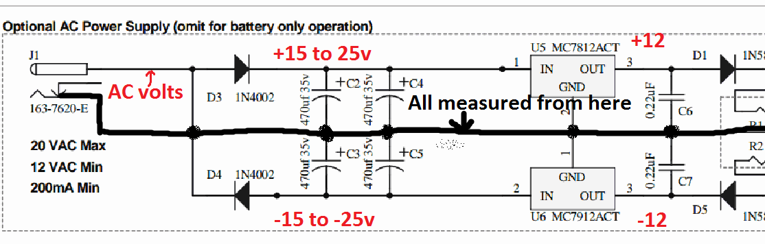

Beep mode isn't always good enough because it will beep even with significant resistance although I don't think that is the case here. Using the ohms range can be better. You should be seeing essentially 0.00 ohms although the meter leads will add to that by around say 0.3 ohms.
With the black of the meter on ground and the meter set to AC volts you should be seeing the same voltage on D3 (non striped) and D4 (striped). That's proof enough that the AC voltage is reaching the diode. Measure on the diode itself, not on the print because that eliminates any possibility of open circuit print.
If the same AC is present above then you should see around plus 18 volts on the striped end. Measure on the diode itself and remember this time we are measuring DC volts.
If you look at the circuit, then the voltages should mirror each other, -18 at the bottom, plus 18 at the top. Minus 12 volts from the lower reg, plus 12 volts from the upper.
i get the same voltage on both - 005. (supposed to be that low?)
The striped end of D4? actually striped end of D4 gives the same reading as non-striped end of D3: -6,6 :confused:
edit: oh wait you mean striped end of D3 that currently gives no reading should be at +18v right?

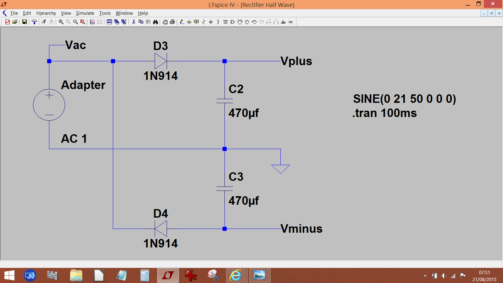

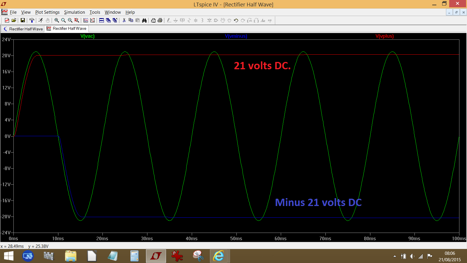

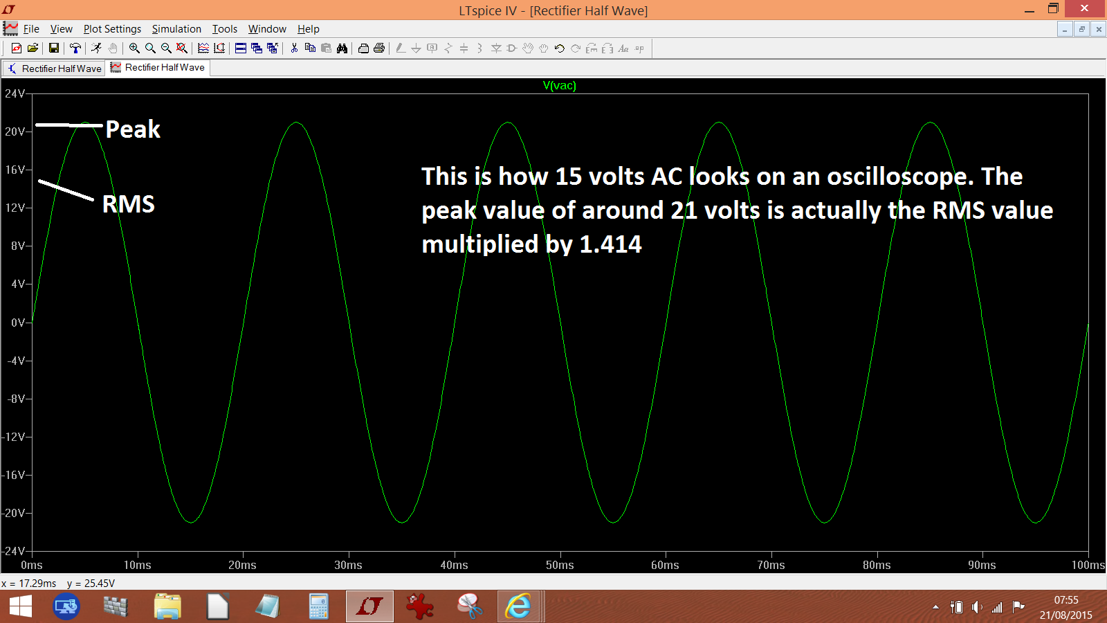

These diagrams should help explain how it works and allow you to pin down the fault.
Firstly, you need to understand that 15 volts AC is actually a sine wave that swings above and below a notional zero point. The meter measures what we call the RMS value of the sine but the reality is the sine has peaks that are 1.414 times that value as shown here.
So that is what a 15 volt AC adapter produces.
This is the circuit of the 02 power supply. Look at the points I have marked showing the voltages of Vplus, Vminus and Vac.
This shows in real time how the circuit works. The top diode conducts as the sine wave goes up and the lower diode conducts when it goes down. Look at the first cycle of the AC and follow how the diodes conduct, and how the DC voltage is then 'held' or stored by the capacitors.
If the adapter were DC then only one of the two rails would appear. Reverse the adapter connection and the rails would swap over.
