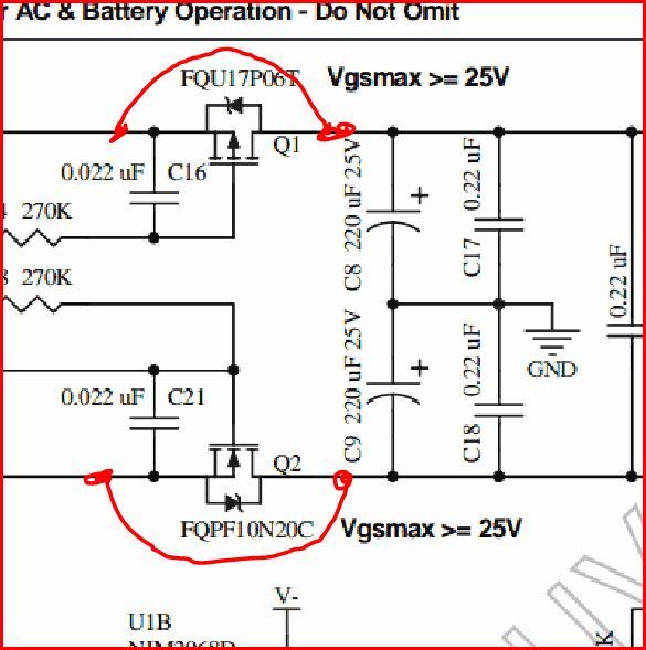

OK... leave those caps out and now short out the two FET's as shown. There is no need to remove them.

Doing this is to try and prove that its not the FET's rapidly switching and "chopping the supply" although its very unlikely and the rail capacitance would even that out even if they were. But... the noise has to be coming from somewhere. And if its not the supply then there isn't much else left.
