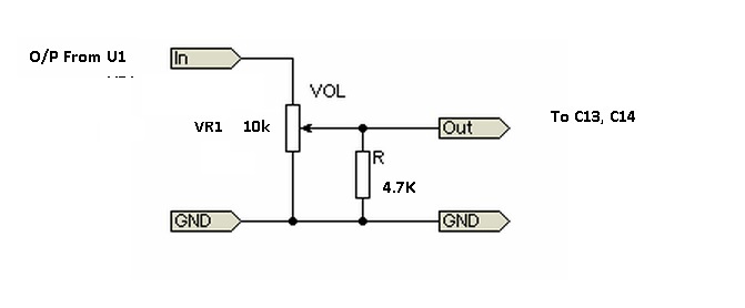

This can't work, you just increase the load of the preamp. You have to create a voltage divider somehow.
Sorry for the unintended confusion.
With 4.7K (connected from centre to gnd of pot)
You get 3.2K pot
With 10K
You get 5K pot
With 40.2K
You get 8K pot

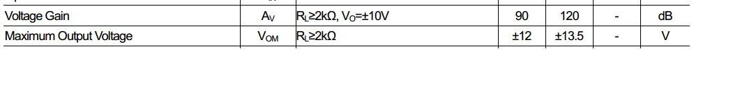

All combinations are above JRC 2068 lowest RL limit of 2K.I would highly recommend 10K as you may have extra pair in hands from BOM.No harm in trying. If this doesn't works for you can always clip the resistors.
BTW pot linearity will be thrown out of window.
Pls refer to attch. schematic.

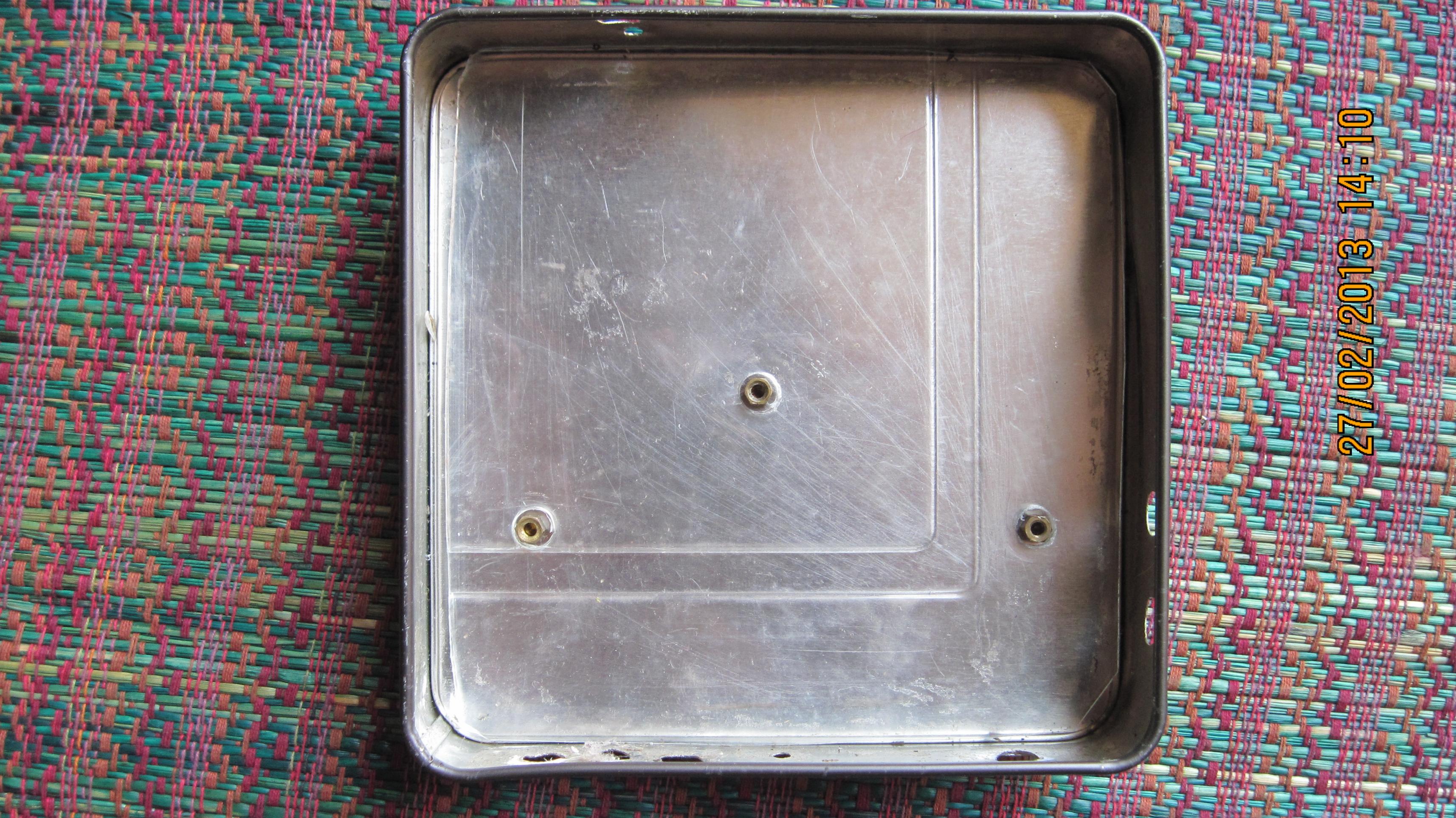

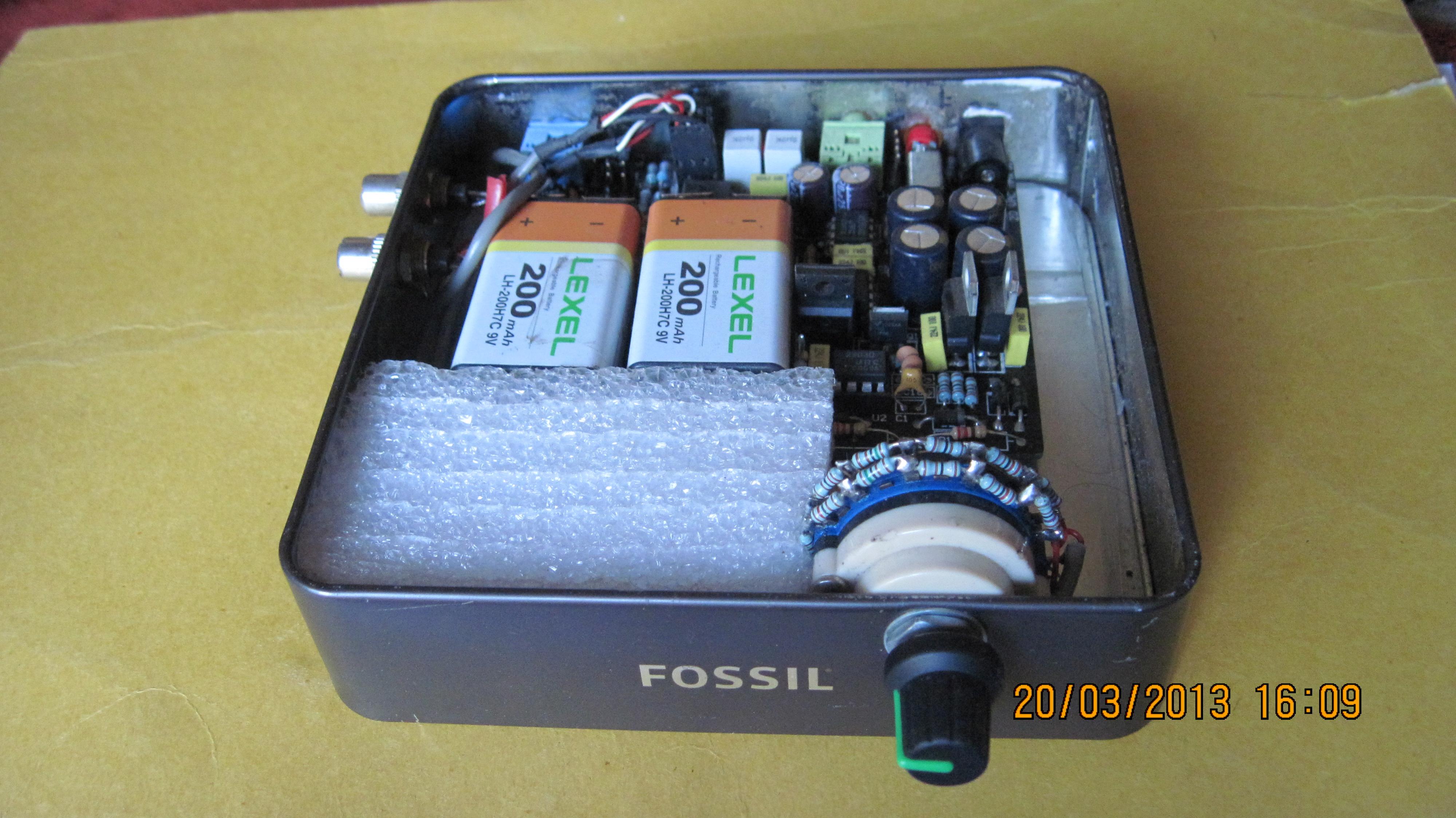

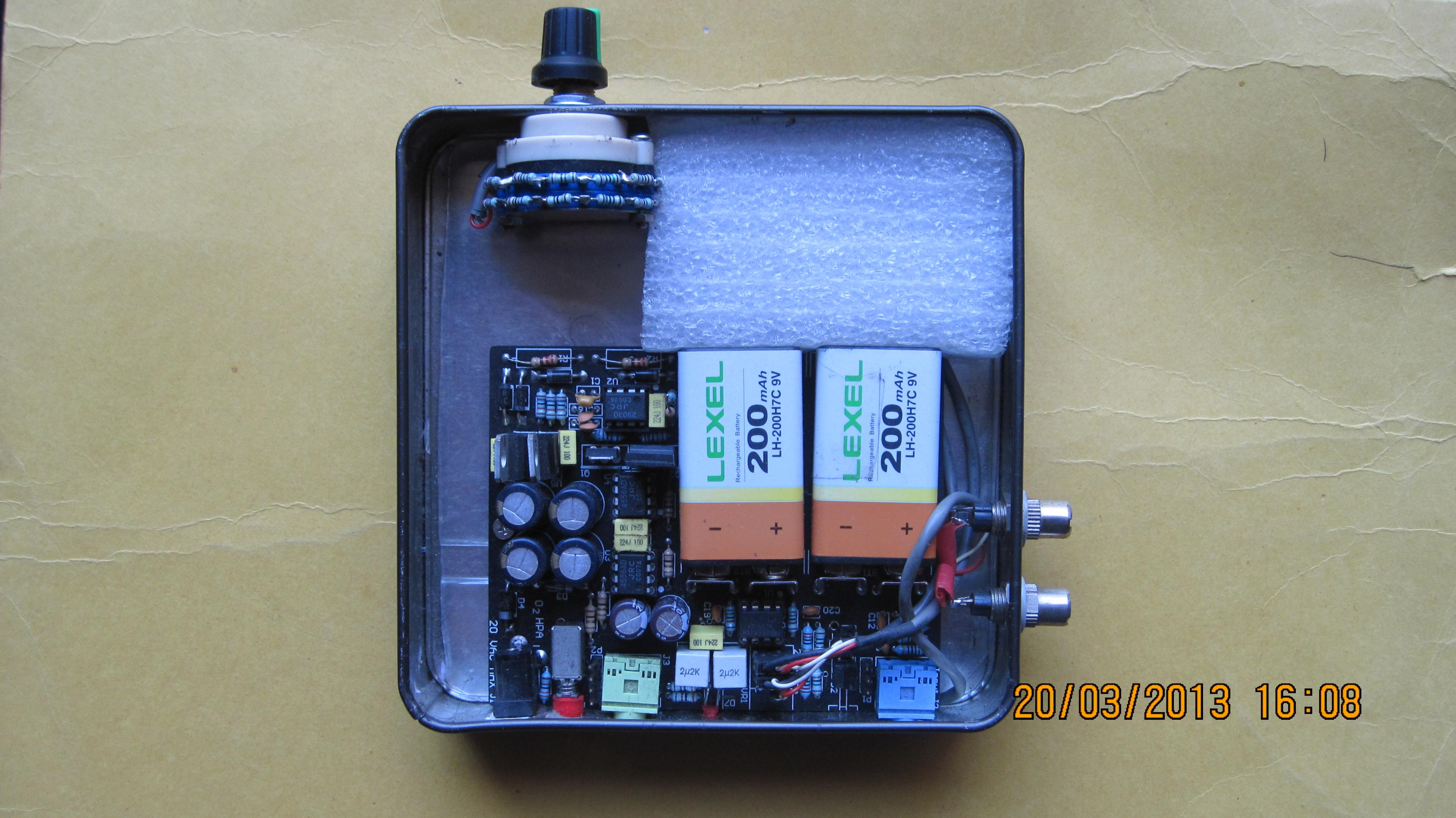

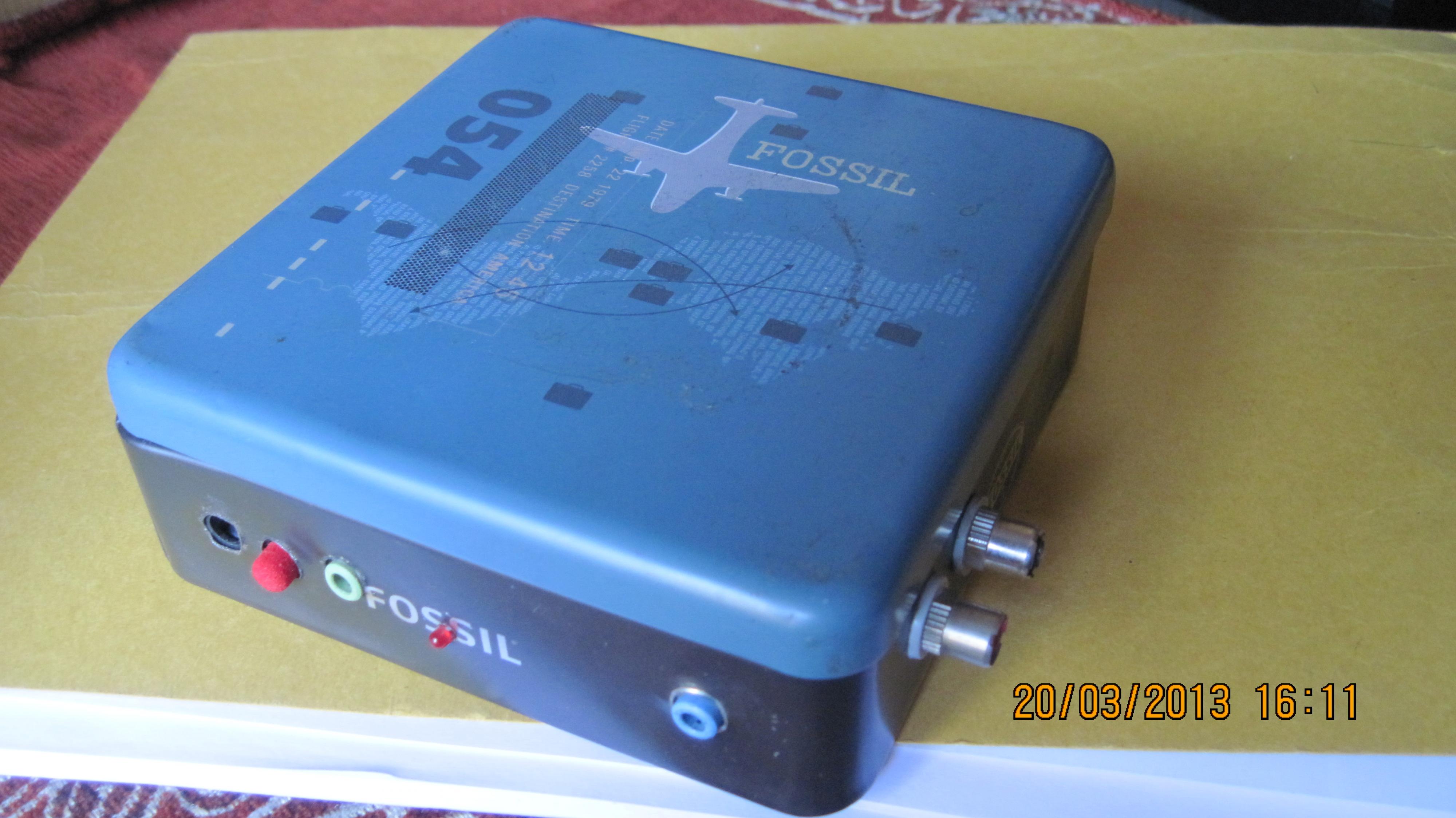

Here are some photographs of my "Fossilised" O2 with stepped attenuator(11+1 steps)
PCB is mounted on brass studs separated by anti-static plastic sheet from the main body to prevent any accidental shorts. It has RCA i/p which are automatically disabled when 3.5mm i/p connector is inserted from front panel. The bare outer ring of RCA i/p connects i/p Gnd. to tin box reducing noise. Jumpers are used instead of gain switch giving me 3 gain options(1X,2X,8X).
Resistor values used in stepped attenuator 100,180,390,680,910,1K,1.2K,1.5K,1.8K,2.2K,2.7K (hand-matched).
It gets comfortably loud at 1X gain with RCA i/p from consumer DVD player , 2X from my laptop & 8X from ipod touch for my Superlux HD668B(56 Ohms, Sensitivity 98dB)
The vacant space(foam)will be used for installing DC protection relay circuit & 1/4" socket. Non-standard red LED used (fwd. drop of 1.78V) with R6 (33K) as suggested by agdr. PM circuit works like a charm.

This does not work that way. You basically would get another taper characteristic and an uneven load with this. Mostly it would just attenuate the higher gain settings. With 4.7k parallel and the volume at 50% you would get about 16% less voltage which would just be 0.75dB at lower gain settings it is even less than that.
Yes you are right on "uneven load" as seen by 2068 with added non linearity issues, but I've seen those type of implementation in electronic fan regulators:eek:
Chk this for more info
ESP - A Better Volume Control
BTW What is your music source? Can't you control vol. from there?
