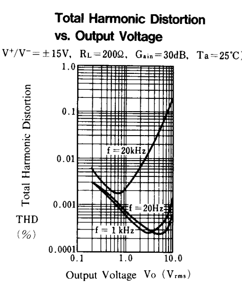

The other problem though is the AC specs of the NJM4556A output chips are rather hideous compared to the LME49990 and would likely cover up any improvements. Check out the THD vs. output voltage graph in the NJM4556A data sheet:

That is for a gain of 30dB, so luckily things get better at unity gain as RocketScientist's measurements showed.
But... I'm always one for trying things! From the specs the 49990 should work, and at that relatively low price it would be fun just to try.
THD graphs are well known for not giving much insight into how things actually sound. Nobody that I know of can hear 0.01% THD. Music is made up of a lot of low-level signals rather than a few high level ones so what matters is more what's going on on the left-hand side of that graph. I have a hypothesis that what we need there is the distortion has to disappear below the noise as the level goes down. The LF distortion probably does but that 20kHz distortion curve which remains stubbornly above the LF ones is problematic for SQ. With a normal opamp what's limiting that HF distortion is the input (LTP) stage, so biassing it into class A at the output has little effect. We really need an opamp with a different architecture.
I just had a look at the LME49990 DS but they're too coy, they don't show what JRC show here - how THD vs level varies with frequency. But the THD plots do show a rise at 20kHz.
