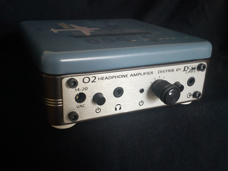

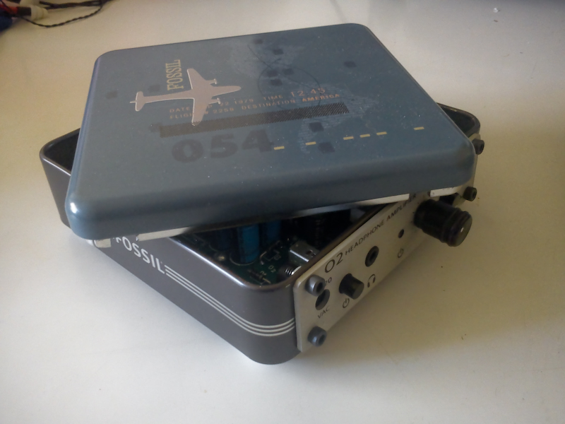

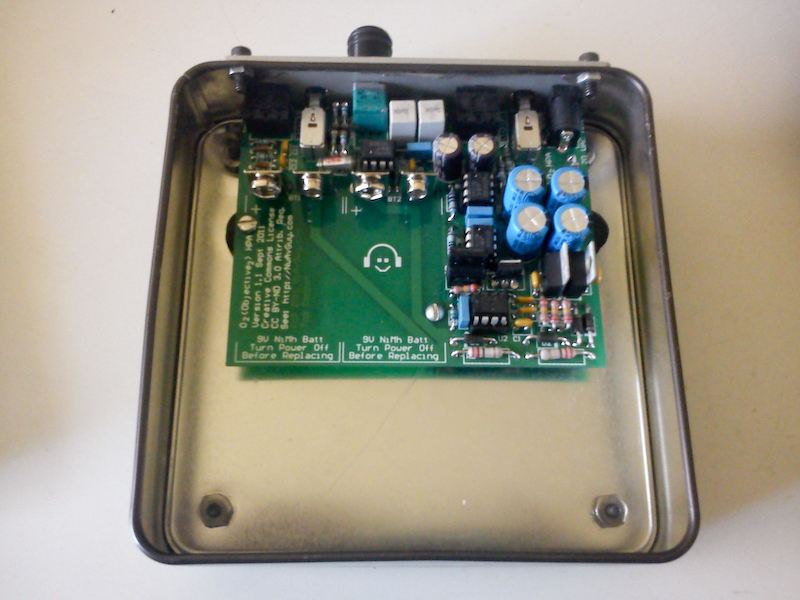

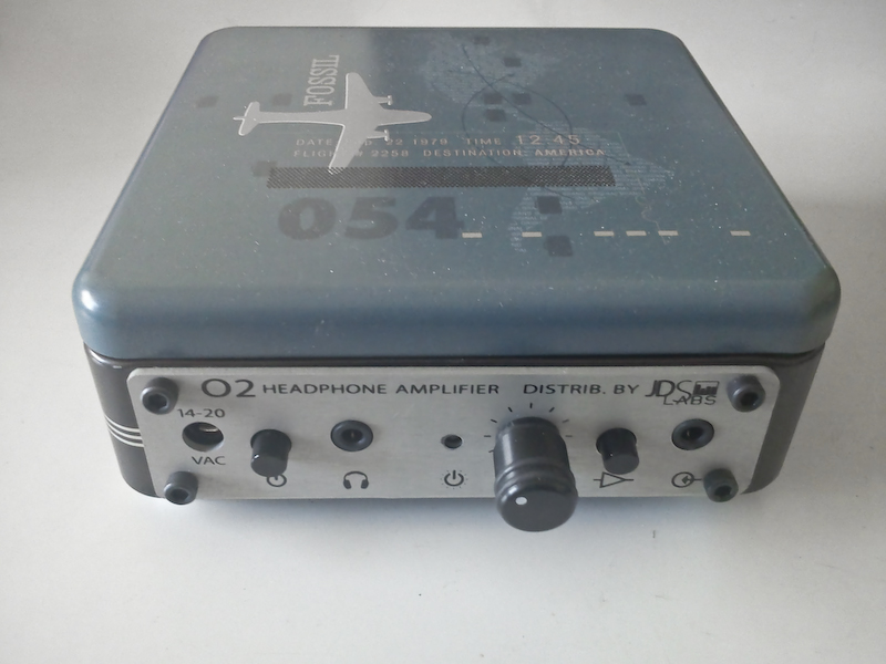

Fossilized O2 amp
All assembled and sounding great!:hphones:
I used a box from a wallet I bought some time ago and modded it as an O2 enclosure. Finished, light, perfect sized for further additions like RCA´s, Bass Boost switch, ODAC, etc, and free :D
Just did a cut on the front end of the box, drilled some holes for the torx screws to hold the JDS aluminum panel, some mounting holes for the PCB and added some white rubber feet to compliment the bundle.
Pretty happy with the final result...sexy!:rofl:

that looks good.. going to steal this idea :p

Hey BlueRob.
Please send me 12 of these, I pay for the freight and a few pints!
Brgds
@BlueRob - Great job - nice retro look, very stylish. However, the knob looks too modern, might be better with a pointer knob, something like this : Pointer Potentiometer Knob Black Hard Plastic (2 Pack) | eBay
Think I have one of those some where, I´ll look for it to see if it fits, THB I like this round one but I´m trying to find something similar but a bit bigger and flatter. I took this one from my Mini3 (cof cof)
-joe
Stealing an idea is called plagiarism and I must say the design is copyrighted...not!:D Go for it and don't forget to post some pics of your amp ;)
Hey BlueRob.
Brgds
Soldering as fast as I can... I´ll let you know when your order is ready LOL.
Glad you liked it mate ;)
