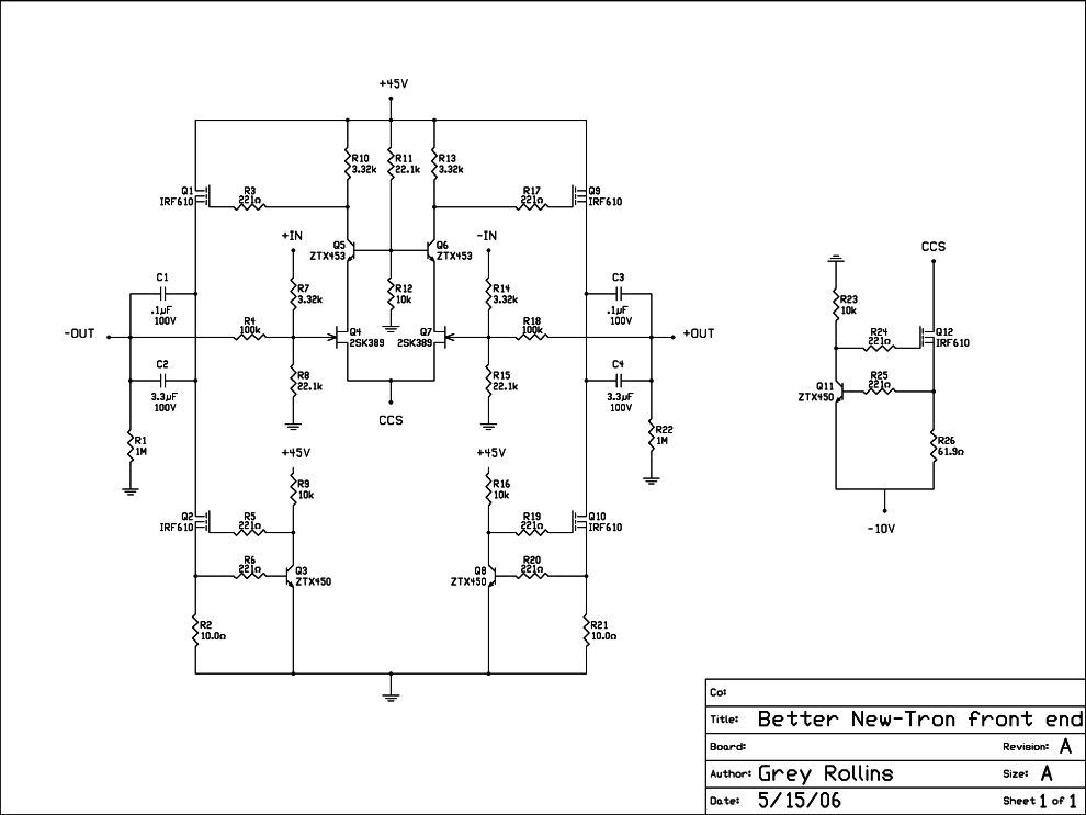

t looks as though you're using negative feedback at the cascode's Gate...
Yes, balanced negative feedback is being used here.
Earlier, I should have given the cross-coupling resistor a higher value commensurate with the change to 1.2k bias resistors. I've attached a new drawing showing all of these changes. Please note that this is still experimental, and all values are ballpark. I hope this makes things a little easier to follow.

I looked again at Nelson's ZV9 article this morning, and I do note an important difference. He modulates the cascode solely using the voltage across FET source resistor, which varies directly with output current. The circuit I propose includes this mechanism, but has the addition of FET drain modulation as a function of output voltage. This may trade off some distortion reduction for improved bilateral control - which could be just the ticket, given the strong and weak points of the circlotron.
If not, simply remove the cross-coupling resistor altogether, and you will have ZV9-style cascode modulation independently on each side of the circuit.
I'm on the run, so this will have to be quick.
Joe,
I believe that negative feedback would be more appropriately applied to the Gates of the Lovoltech JFETs; two resistors, one from each output line to the opposite side's Lovoltech Gate, thus forming a resistive divider with the Gate's grounding resistor.
Give your circuit a try and let me know how things go. I'm open to being convinced.

NewT-FE2
Crossed fingers...if nothing goes wrong, I'm going to try to squeeze in a new front end schematic while things are quiet.
This one is based on the 2SK389. If you don't have those or can't get them, it's a curable problem. The Toshiba parts are still kinda sorta available, but there is a second source for them now and if there's enough interest, perhaps we can do a buy on them to save money. Every time I look at the Toshiba parts, the price has risen again--supply (out of production, inventory falling) and demand (from what I can tell, demand is more or less stable). The newer parts are in a different case and are expensive, but perhaps a buy would help with the price. I don't care about the case as long as I know ahead of time what I'm dealing with so I can get the PCB artwork to come out right.
Failing that, I have run the circuit with J310s, which are both available and affordable. The gain is lower and performance suffers a bit, but it works just fine. Other JFETs should work well, too.
This circuit is a little more elaborate than NewT-FE1. I've got a cascoded JFET front end feeding a MOSFET follower output. The outputs are biased hard, so use heatsinks on the MOSFETs or cut back on the bias a bit. The rails are asymmetrical at +45 and -10V. If you want to run +-45V, that's fine. The CCS can take it.

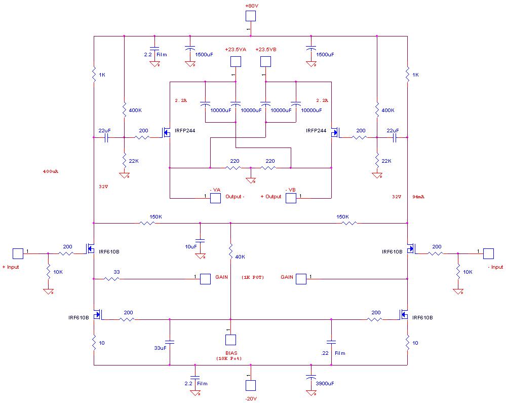

EUVL,
That's a pretty straight forward Circlotron. As such, it looks workable to me. I classify "X" feedback into two categories: Same Side Feedback (SSF), and Opposite Side Feedback (OSF). The Aleph-X is an example of OSF. The NewT-FE1 and NewT-FE2 front ends fall into the SSF category. I have other front end circuits which are OSF.
Incidentally, with minimal changes, the NewT-FE2 makes a pretty decent line stage.
Grey
I thought that is the Pass philosophy ? Certainly cannot be simpler than what he has drawn. What are the srawbacks of that circuit ?
Patrick

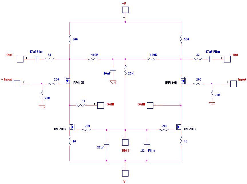

The Pass Philosophy??? Crrently I have a couple prototype line amps that you see below. I think it deffinatly has it's roots in the Pass Philosophy... It is my first answer to the "How to drive the New-Tron" question... I've also been thinking in bridged circles for a while and the topology below will do the job. It simulates pretty good and an unmatched component version measures about 10X the sim data so I'm anctous to measure the second "matched" prototype...
Comments:D :D :D
