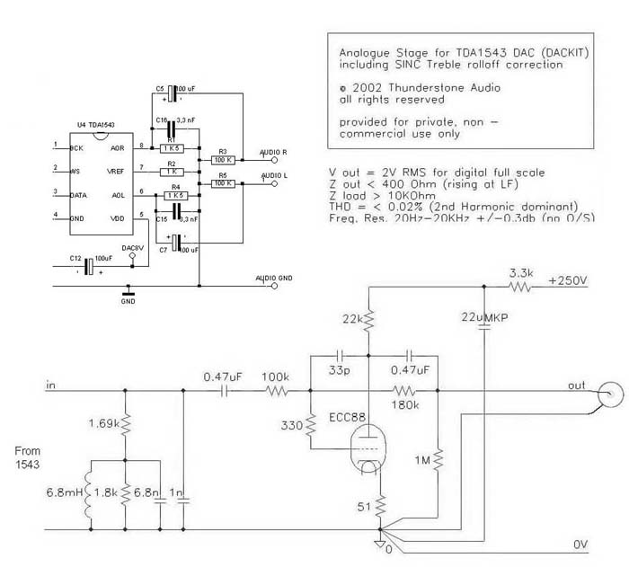

NONOZII DAC Output Stage
Hello,
I think I will try to build a NONOZII DAC, but I will try a tube output stage. I have found a Thunderstone Audio Schematic for TDA1543.
Does somebody can help me to find the best connection between pins 6,7,8 of TDA1543 and thunderstone output stage ?
My question could be seem stupid, but I'm not a specialist of DAC and I prefer to ask
Thank you

You need two of these tube circuits, one on pin 6 and one on pin 8. The 1.5 k resistors and the rest of the Nonoz II schematic at pin 6 and 8 is replaced by Thorstens design. Make a 1k pot between pin 7 and earth with a 500 ohm in series and adjust the pot for 4.3 V on pin 6&8 in rest.
Good luck!
Fedde
