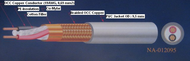

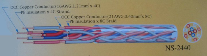

That's exactly the last lead I've tried! (PartsConnexion?)
I'm using Neotech NS-2440 as speaker cable and NA-012095 for interconnects and both are very good sounding, I didn't noticed any bathroom effect.
But when I've connected that solid core timbre was wrong from the start!
Apart timbre that cable is resolving, detailed and not harsh at all.

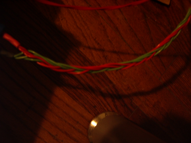

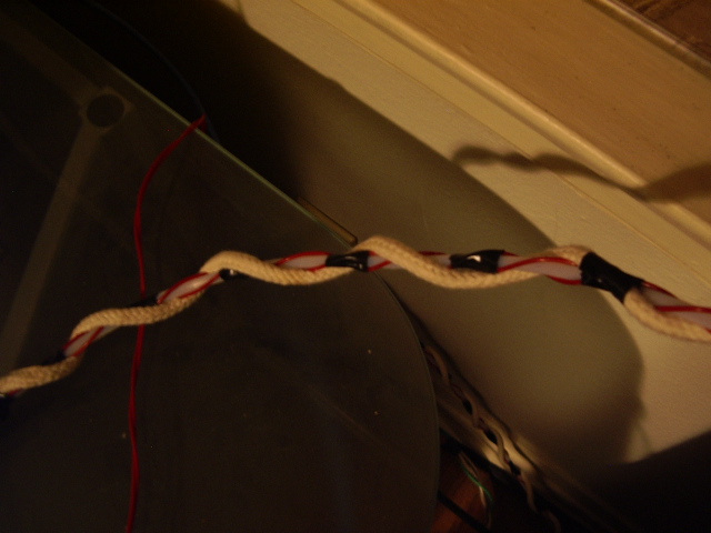

I buy OCC copper teflon-insulated chassis wire of various gauges, depending on the application, and build my own IC's and speaker cables. These poor quality pics show my balanced IC, a simple, spaced twisted pair with a counter-spiral ground. Each 24ga insulated signal wire is spiraled around opposite sides of a teflon tube. This provides separation to reduce capacitance. The ground is inside a cotton tube, which spaces it farther from the signal wires. When I was running the MyRef's full range, I used this same construction technique in single-ended format (no separate ground). Now these balanced IC's go to the active xover.
The speaker cable is a simple braid, two 18ga conductors for each leg, four wires total, no jacket. It doesn't get any easier.
I have owned and heard some very nice, expensive IC's and speaker cables. Only one IC was very slightly better than these, and no speaker cable was better. I'm sure there are, but I haven't heard them.

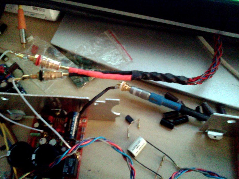

Hi Tom,
I'm using Neotech cables outside of the MyRef and I'm satisfied by their performance, no problem with them...
The problem arose when I've tried a Neotech teflon insulated solid core wire (single run) inside the MyRef.
