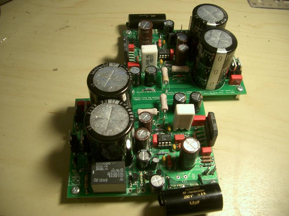

While trying to diagnose my broken amp, I took voltage readings at lots of points and compared them to the working amp. Interesting that the working amp has 16.5 volts at C14, not 24 as noted on the schematic. Has anyone else ever measured the voltage there? There is 24 volts at the junction of D2 and D3, but 16.5 volts after R14.
On the broken amp, I am getting 30 volts all over the place: BOTH ends of D2 and D3, both ends of R3 (should be zero, I believe), at C14, etc. Voltages on the transistors are all weird, too. The only normal readings are at ZD1, ZD2, R1, R4, C3, C6, C8 and C11, so I know the power supply is okay. I checked all diodes and they seem okay, and all 3 transistors seem to be okay. I used the diode checker on my DVM but didn't pull any off the board. Something is putting 30 volts in lots of places where it shouldn't be. Any ideas? Does this sound like a short somewhere? Bad LM3886 or 318? The amp is out of the case (using a temporary heatsink that touches only the chip), so it's got nothing to do with mounting or connections.
C'mon, guys, I need some help.

Troy,
Thanks very much for responding.
Main caps check okay--zero ohms to ground on one pin, lots on the other (reading keeps increasing).
By solder bridge, you mean a short to ground? Where I have C21 mounted from under the board, there is a very narrow insulated (open) area around the top of the pad and the surrounding ground plane. If I bridged that space with too much solder on the top of the pad and it touched the ground plane, could that be the problem?

madisonears said:While trying to diagnose my broken amp, I took voltage readings at lots of points and compared them to the working amp. Interesting that the working amp has 16.5 volts at C14, not 24 as noted on the schematic. Has anyone else ever measured the voltage there? There is 24 volts at the junction of D2 and D3, but 16.5 volts after R14.
Here are some voltages I took earlier:
bluegti said:
Well I swapped boards and compared the voltages. They are pretty much the same (recommended voltages in parenthesis), so whatever is happening is happening on both boards:

Went over my broken amp with a magnifying glass, checking every solder joint. No bridges, nothing compromised. This amp was assembled at the same time as the working one, every component matched for value, location, and orientation. I am confident this is not an assembly issue.

Sorry dealing with some issues right now so replies will be sporadic.
If main caps are good and you are confident that there are NO solder bridges between pins or across traces then it is pretty safe to assume that your chip is bad.
But at the same time, the uninsulated chips are notorious for
'bleeding" voltage through the heat sink.

Hurray! I got my amps working tonight. I'm surprised that I didn't see the issue before and I'm surprised that nobody else caught the problem either. Its sort of obvious now that I know. Click on the picture to see if you can see the problem.
Look at the top-most leg of the LM3886 - Not even in the hole. Amazing how everything works when you have all the connections soldered.
The issue with the screeching sound seems to have been the heat sinks. Thanks to Troy for helping me out with those. I just got done playing the amps at a fairly loud volume for 45 minutes and they are barely above room temperature. My first impression is these sound great.

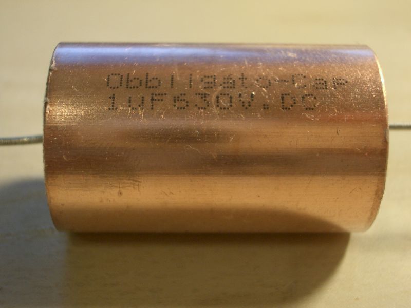

Assuming the buzz isn't in the amps, I want to swap out the C13 caps for something better that the Solen's I have in there now, secure the boards in the enclosures then close 'em up. I bought a couple of flavors of Obbligatos to try - 2.2 Copper Case Film caps, 2.0 Film Oil caps (big black cans), and 2.2 Tinfoil/Film caps. Just realized the tinfoil caps are rated at 250V, will that be an issue? Maybe I'll have to get some of those posts that ClaveFremen uses so I can compare. What do people think would be best?

bluegti said:Hurray! I got my amps working tonight.
Well done!
250 V rating is not a problem (apart dimensions ), probably it sounds better than the 160V counterpart.
The Obbligatos sounds very good but IMHO Mundorf Zns are better, more transparent.
Are you comparing the sound of the Mundorf Zn's to the Obbligato copper case or to their Tinfoil/Film caps? I haven't read of anyone using their Tinfoil caps before. I just saw them and thought I would give them a try. From the description, it sounds like the Obbligato Tinfoil/Film caps are comparable to the Mundorf Zn's. They aren't much bigger than the Solens so I don't think size will be an issue.
I tracked down the buzzing problem to the Lightspeed Attenuator. I must admit that my soldering job was a bit rough on the perfboard I put together. And I'm not sure if I have things grounded entirely right so that will be my next project to debug on a different thread.
bluegti said:Are you comparing the sound of the Mundorf Zn's to the Obbligato copper case or to their Tinfoil/Film caps?
The Obbligatos that I've tried are the copper ones, they're tin foil too.
If you listen Obbligatos and Mundorfs alone the Obbligatos seems better but when you compare both caps with DC couple the Mundorfs are clearly more transparent and Obbligatos a bit coloured (the famous 'analog' sound ).
