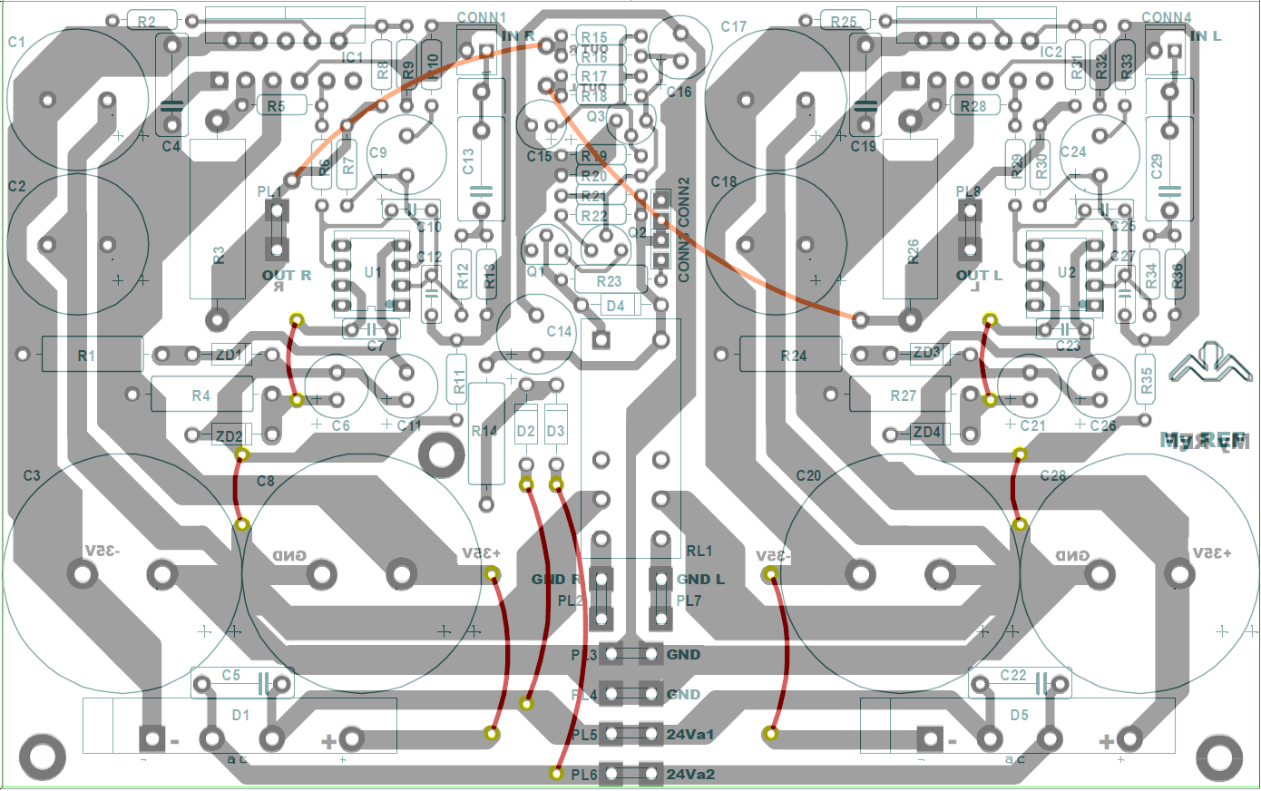

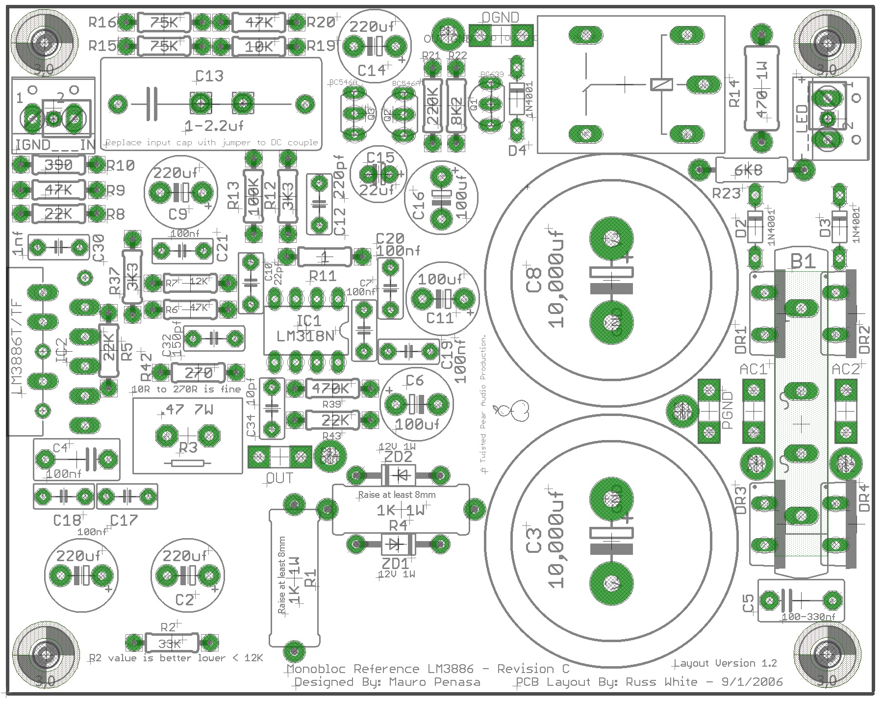

Puffin... where did you took this BOM? It looks wrong to me, it seems not for Twisted Pear boards but for the original Penasa's stereo board...
I can't also find the compensation caps... and as I've said in the FE threads I suspect the problem is in the compensation...
Can you post some pictures of your populated boards so that we can check which ones they are?
This is a TP board:
attachment.php
This is an original stereo Penasa's board:
attachment.php
You will notice that components numbering is different...
Hi Dario, thanks for your reply. I followed the values for the components from both the BOM and the silk screen printing on the board. It is unlikely (but possible) that I used one or more incorrect values when soldering them. I normally check all resistor values with a multimeter before soldering even if the strip of resistors is marked with the value.
I have a capacitor and semiconductor checker that I also use to confirm values before installing.
I will take some good pics of the boards and post them later. Would I be right in saying that you feel that the lack of HF is more than simply trying a different flavour of C9?
I removed C13 and DC coupled to see if this made any difference....it didn't.
Rob.

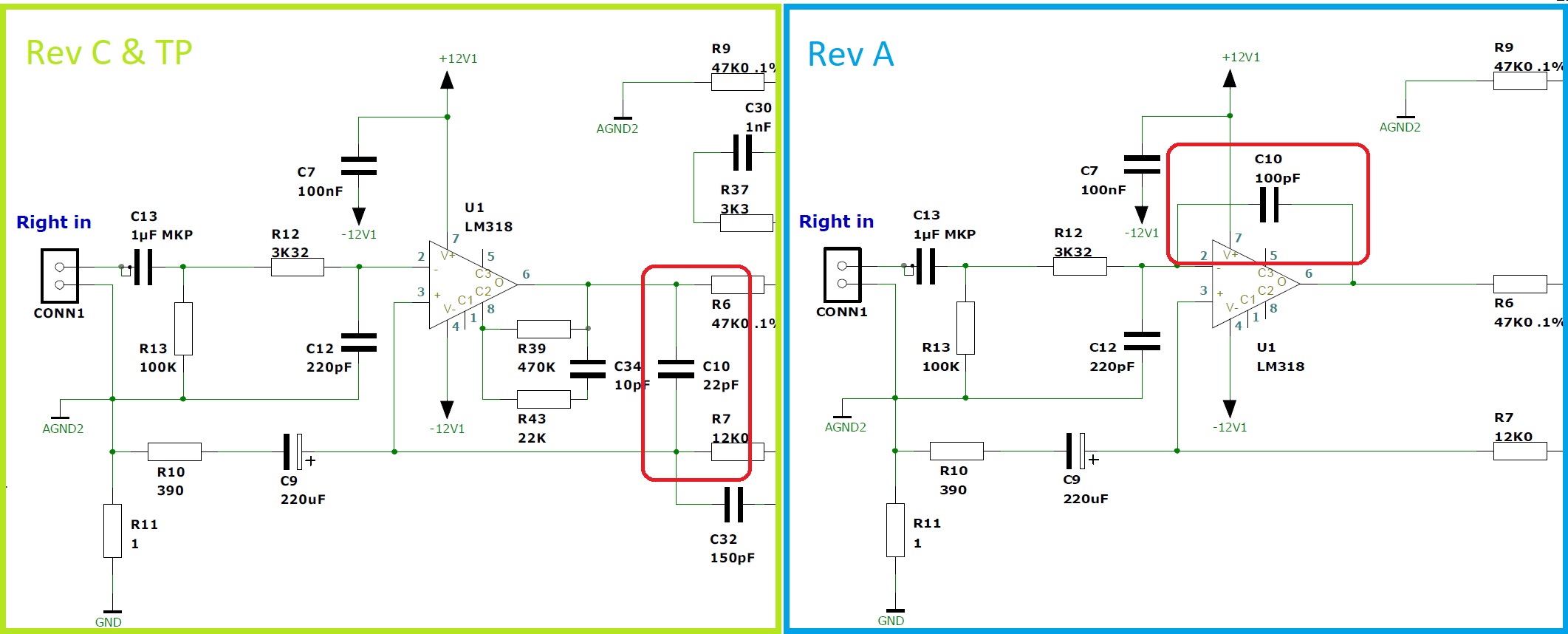

My feeling in particular is that your compensation capacitors are all MKT versions. That is in itself an explanation to what You hear now..
Ciao, george
George, you're right about the MKTs but I think it's much worse...
attachment.php
On Puffin's BOM he has 100pf on C10...Can you imagine how disrupted would be the amp performace if the Rev C C10 is 100pF? ;)
Ah ok!!
That is the famous RevA compensation scheme..
I am even hesitating to write down Rev A, because todays it means something totally different, like the state of the art..
Yes, Puffin, that was the very first version, realization of this MyRef project.
Mauro Penasa himself had proceeded forward from that vompensation scheme, very quickly.
And there had been always fans of that scheme, because it gave a 'mellow' sound character, with respect to the RevC compensation scheme, which is much more resolutive..
Just to put it in a historical context...
Ciao, George
