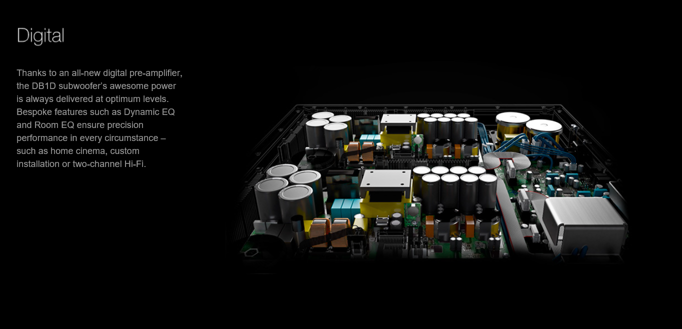

So this must be the B&W subwoofer series with the Hypex MP series amps:
DB Subwoofers | Bowers & Wilkins

Wow looks nice! Is that a custom unit for B&W?
