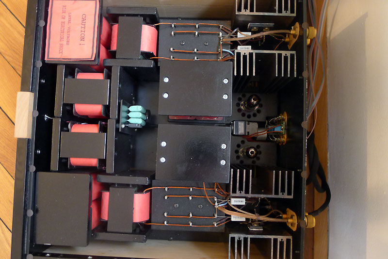

I happen to know Andrejs, he came to visit Kaunas a few times and brought that amp with him, so I had a chance to hear the thing on a few occasions. It is quite a beast, and with practically zero coloration of the sound in any direction I could notice. The many transformers are needed because of the design principle utilized. This was explained in the 6moons article better than I have the understanding to expand upon, but from what Andrejs told me, each transformer is custom made to the exact spec it will be used in the circuitry. (Not merely custom wound, but measured with an oscilloscope until it is perfect). The amp runs surprisingly cool. And it weighs like a tank. It has a remote controlled discrete volume control built in. I would be willing to bet it is the best value for the money out there. (I mean, they compared it to a Luxman which costs 10 times as much). Andrejs tells me that even Luxman didn't go to the extent that this NEM amp takes the PS.

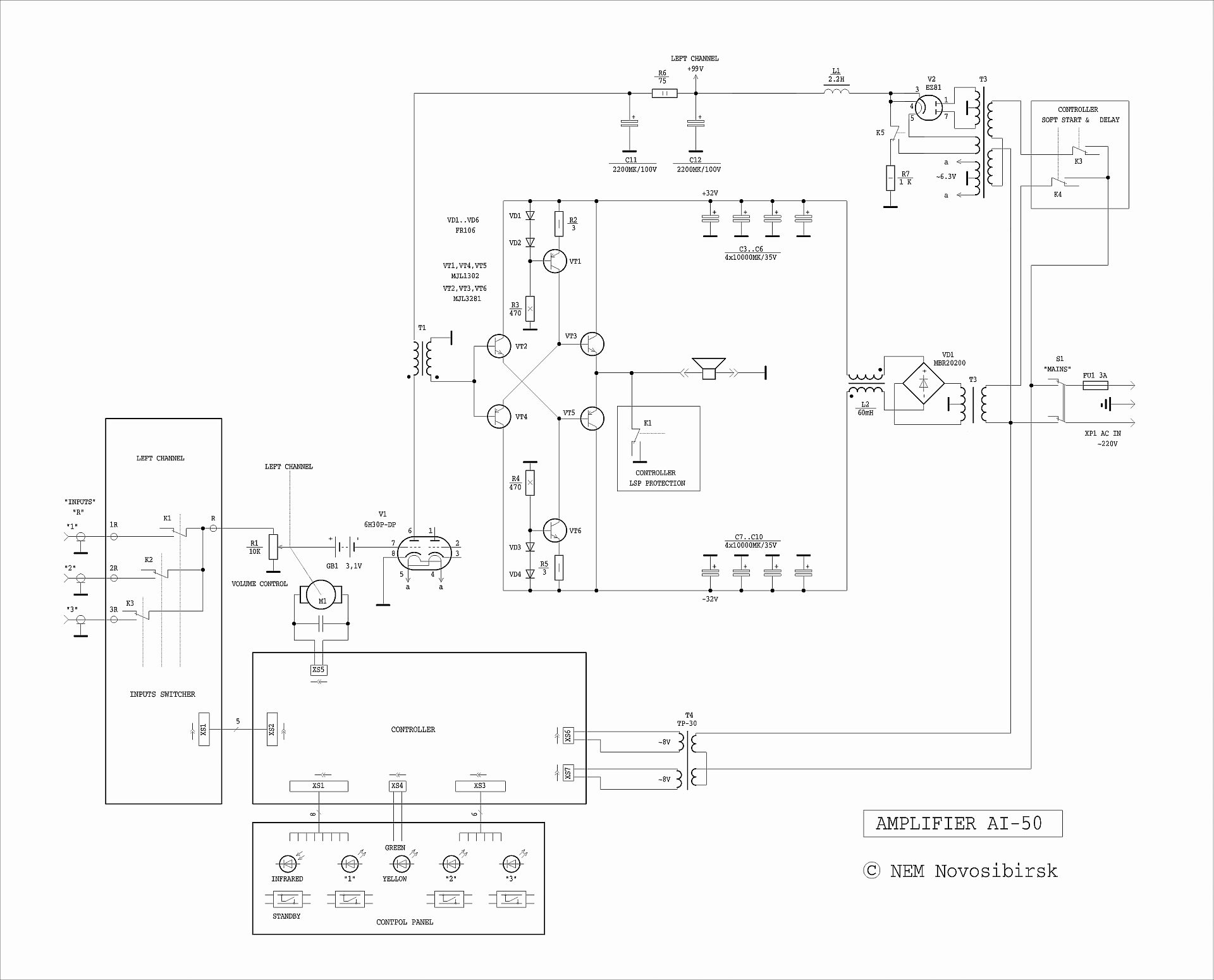

Hello NEM audio
I've read the review on 6M with great interest, and I have a couple of questions.
What is the rise time for the amp?
In its THD plot, what flares out most: even or odd order harmonics?
Is the frequency range limited by you or is it the max the amp capable of?
How much AC filtration/regulation is needed?

Hi!
Sigmal rate is 10V/microsec and is restricted by the parameters of interstage transformer. We do not use feedbacks in the amplifier, and thus SR determines the upper frequency at nominal power, which is 80 kHz -3 dB.
The frequency range depends almost on interstage transformer. We specially design the transformer such that the wide bandwidth is not the primary goal, as in our opinion the transformers with middle frequency (sqrt(Fb*Ff)) 400-600 hz are the most musical.
The low frequency limit is 2.5 Hz - 3 dB.
The most important goal in our transformer design are the efficiency and low electric and magnetic losses, so the primary winding has typical DC resistance less than 3-5% of internal impedance of driving tube, and the core has big cross-section area, 16 sq.cm.

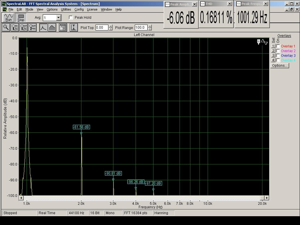

The number and spectrum of harmonics is determined almost only by the driver tube, typically it is less than 0.2%. I have attached the pic with spectrum of harmonics.
