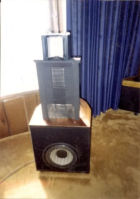

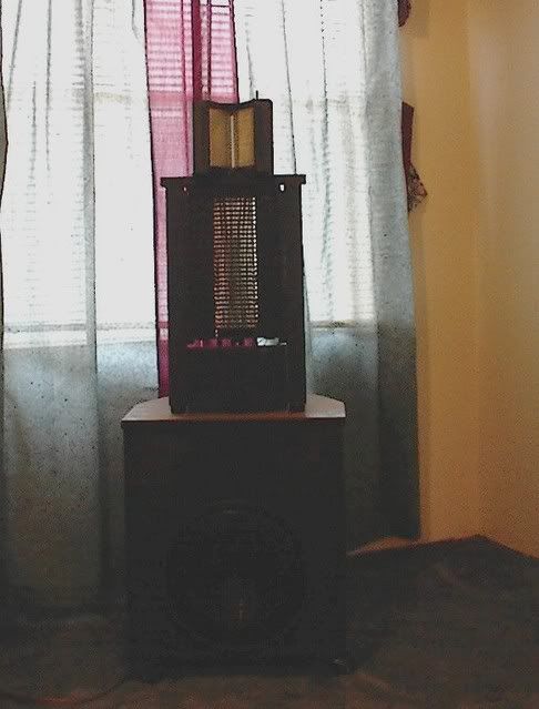

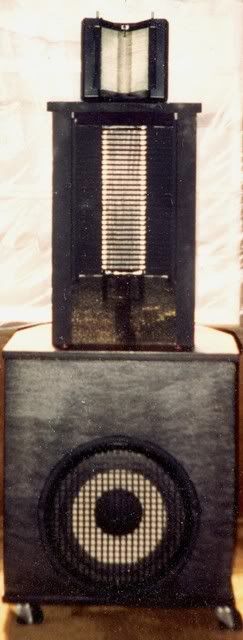

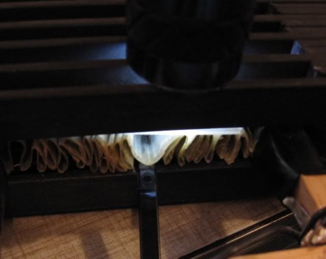

Hello, I too am an Amt enthusiast in search of a stronger magnetic field
These are prototypes I built in the mid-1990's, patterned from the Audio Amateur how-to, and scaled up in size:
I still have the drivers except for the bass units, which had some design flaws. I loved the sound of the mids, but they are very inefficient (and heavy).
I hope it's ok to put the pics in directly, not sure of the forum rules.

Hi Greg, and welcome to the forum. That's a seriously big AMT you have there. The trick seems to be to develop enough force to get the pleats moving sufficiently. Compared to products in the market place you seem to have rather generous pleat widths, where most designs really cram the diaphragm into the the available space.
What pleat depth are you using on the mid AMT? You may find the thread called "Electrostatic AMT?" of interest. In there we concluded that the force that can be generated is really crucial to the sucess or failure of an AMT; or put another way, what F number (depth/width ratio) can be supported.

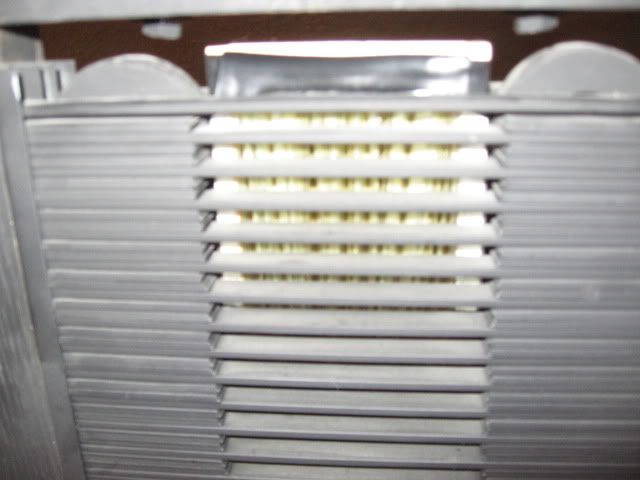

I would say the pleats are 3/8 inch depth (actual foil strip size) and about 3/32 inch width. The width varies due to the somewhat sloppy construction. Radiating area is about 2.25 x 10 inches. DC resistance 4-5 ohms.
The diaphragm sits in a 1/2 inch gap formed by two rows of round magnetron magnets sandwiched between strips of mild steel. The strips are 1/8 x 1/2 inch stock :
What took me totally by surprise here was that in spite of the large size, the low frequency range of these things is only 700 Hz, below which the response drops like a stone. Near-field response on center axis is a curiosity, with a straight but rapidly rising tilt to about 8 kHz, and a smooth gentle roll-off above that.
But if you go off center axis a few degrees horizontally or vertically, the response flattens out nicely, as good as most anything I’ve seen. With a 0.25 mh coil and 80 mfd cap, the minus 3 db corners are about 700 Hz and 10 kHz, and extremely flat in between, when measured just a few degrees off the vertical.
So the lack of low freq range precluded their effective use in that particular system, and the project went on the back burner. But their sound had been so good, especially considering the crude construction, that I always hoped I could someday construct a better set of them.
Any ideas on how to extend the lower range?
Greg, you appear to have a depth/width ratio of a modest 2:1. Trying to increase this by adding more pleats may not help the sensitivity, as with a 1/2 inch gap you may not have enough force to move the air mass when bounded by (say) 4:1 pleats.
The 700Hz LF cut off is a bit of a mystery. If it were dipole loss you would expect it to start higher up and be 12 dB/octave. I am wondering if you have a good seal between the frame and the magnets, or indeed, between the diaphragm and the frame. Something like beads of silicon sealer could be a quick fix but will make the frame hard to remove.
HF performance should be related to the pleat depth. Lambda (the wavelength) is 43mm at 8kHz, so Lambda/4 is 10.75mm which equates with your 3/8" pleat depth. One theory has it that comb filter like artefacts should appear above this frequency, but practice seems to suggest otherwise? The cavities formed by the 1/2" deep pole pieces in front of, and behind the diaphragm could have significant acoustic implications. A comprehensive treatise on pleated diaphragm loudspeakers is long overdue. Part of the reason that one has not appeared is that the knowledge is likely to reside in more than one discipline such as acoustics and fluid dynamics for starters.

I'm not sure of the calculation there, do you use the actual dimensions when the diaphragm is laid out flat, or the width when folded? Here I've propped open a pleat for a better look; the actual foil is 3/8 with 1/8 spacing between strips, but slightly less when folded:
One theory has it that comb filter like artefacts should appear above this frequency, but practice seems to suggest otherwise? The cavities formed by the 1/2" deep pole pieces in front of, and behind the diaphragm could have significant acoustic implications. ....................
I'm seeing a smooth HF rolloff. I did not detect any nastiness at the extreme top. If there are any diffractive effects, they seem to be helping. However, I have acquired some Earthworks QTC-1 mics recently, which should be more accurate than the Audix TR-40's I was using, and will retest and check for ripples in response.
Even though the LF range is not extended, the power handling seems to be much higher than the standard Heil dipole. A simple 6 db/octave network bandpass, and no sign of distress, no having to resort to trickery in the network, as with the AMT-1 (another topic for discussion )
The radiation pattern is different as well, leaning just a bit toward an electrostatic.
In any event, I would settle for having more efficiency at this point, and keep the present frequency response. How much more would the latest magnets offer over the ceramic/ferrite ones I have now?

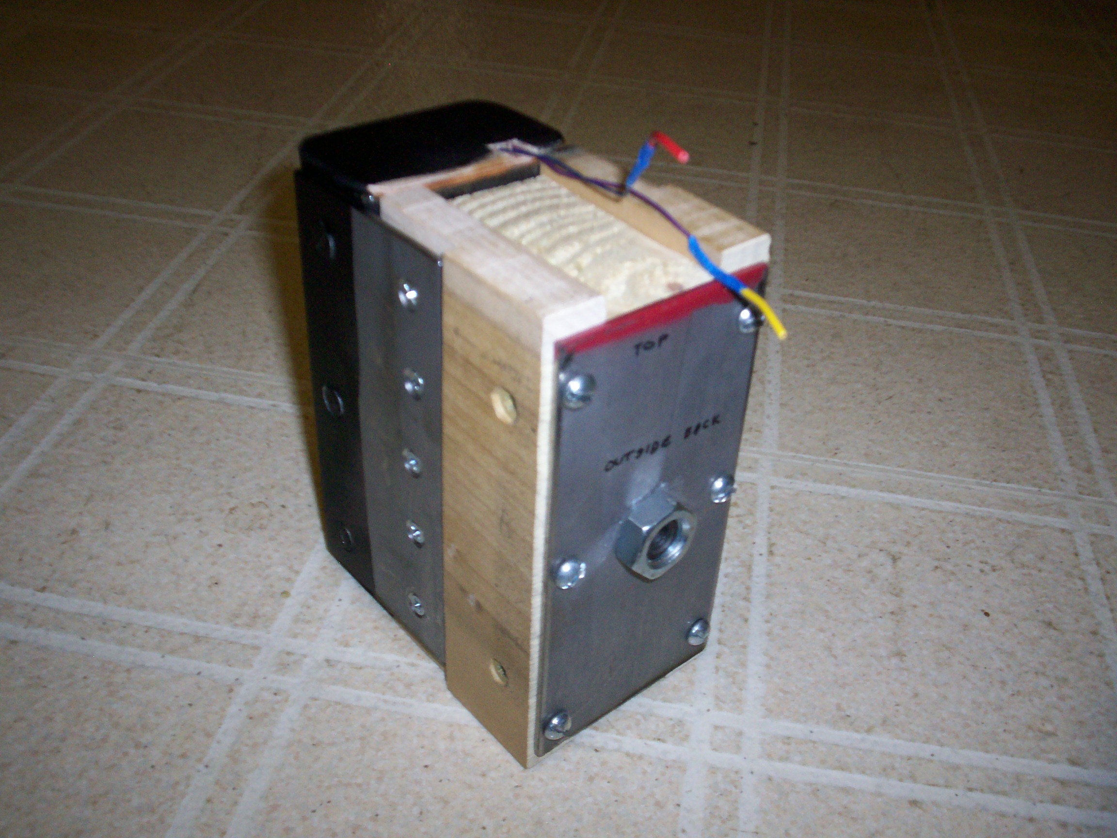

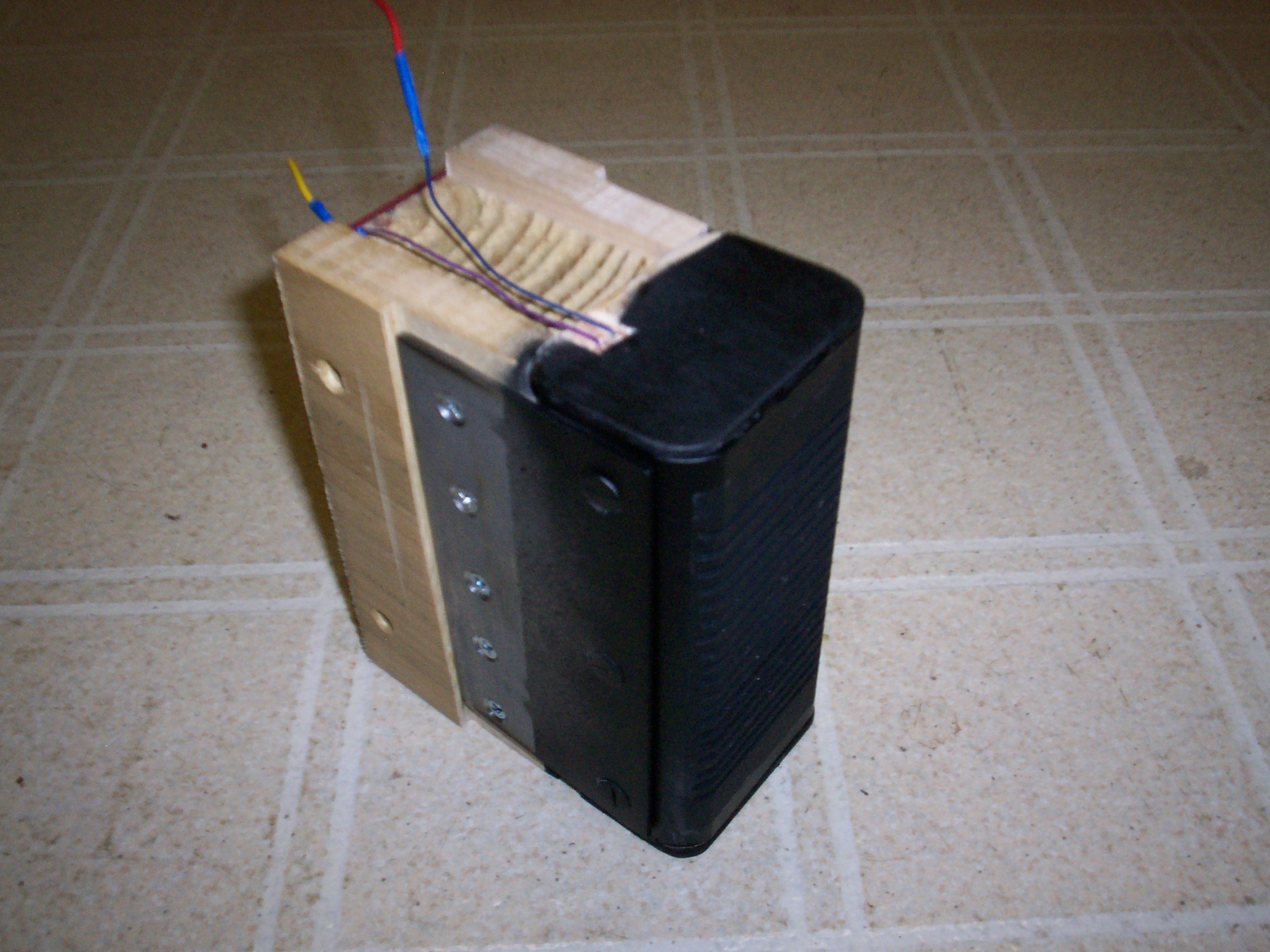

Before in this thread I mentioned one corner of the diaphragm came unstuck, this despite choosing the extra-sticky 3M tape with some care. I seems the warpage works on the adhesive over time and slowly pulls it apart.
1/4 inch dowell to the rescue - I carved a notch on the diaphragm side and ground the other until it fit with enough extra length to prop up the side ends, almost to the corners, gently but firmly against the sticky tape bezel. A half-drop of silicone adhesive on each end keeps it situated.
It probably came apart from vibration - - this driver went loud when I tested it. Glad I didn't seal it up right away. Adhesive just isn't enough for the ESS stock replacement. Also my first listening impressions and tests above are with a corner of the diaphragm flapping in the breeze.
Next time (if ever there is a next time), I'll tap in 4 holes in the front of the outer pole during the carving and grinding and hold it on with 4 nylon screws and clips. Maybe 4 notches and a long clamped thingo down each side holding the diaphragm snug against a sticky gasket.
Tape alone is not enough.

I just built one of these DIY AMT tweeters, it sounds very nice! IMO better than most of the exotic dome tweeters I've tried and almost as good as a Raven R-2.
Just have a question about the pole piece, I made mine out of slotted 10mm steel threaded rod (see pics). Also, tried it without the pole piece and filled the gap with five small block ferrite magnets. Both ways sound good, with the pole piece in place it sounds smooth and sweet, with the the pole piece removed and block magnets in place its sounds more powerful and dynamic (maybe a little brash and forward?). My question is, theoretically do you even need a steel/iron pole piece?? why not just fill the gap with magnets??
Also, the amount of wadding/stuffing inside the tube makes a big difference, put too much in there and the whole tweeter becomes very tame/dull sounding (too much absorption).

OK so how is the block magnet in the right 1/2 of the first pic sitting inside the unit on the left 1/2 of the first pic.
Also how did you arrive at the third pic from the second.

The large ferrite bar magnet sits flat stuck magnetically to the steel housing of the whole tweeter assembly, directly behind the ribbon.
The second and third pics are to simply show the two alternatives discussed, the first shows the steel threaded pole piece, the second the alternative where the pole piece is substituted with five magnets - both setups work and sound good.

To do a powered AMT midrange. I really should finish my other audio projects first. As big as that other beauty from the nineties on this thread. What I's like to do is try to design it for a resonant frequency. Come to think of it, has anyone seen any research on Thiele-Small parameters for these beasties?
After a Break -
Mounted the AMT on a block so that it can slide in or out an inch from equidistant from the listener, relative to the B-G mids which will be on either side. A threaded insert in the back takes a jack screw.
