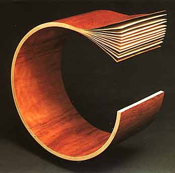

It would be interesting to realize the internal shape in plywood as for drum shells:
www.sonormuseum.com/1987/features/sigshell.jpg
Inviato dal mio Droid DNA utilizzando Tapatalk
How does one make a drum shell ? Heat and steam plywood or is it made using many layers of curved ply that are then bonded and clamped together a curve? I think use foam core internally and wood on outside. That makes it way to bend and the foam core also provides some damping. I think the ultimate Nautaloss would be a long 3 ft tapered glass flask that a glass blower heats and coils into a spiral. The mouth could then be fitted with either a nice wooden baffle or a clear plexiglass baffle could be fitted. The clear glass would only look cool with no stuffing in the line.

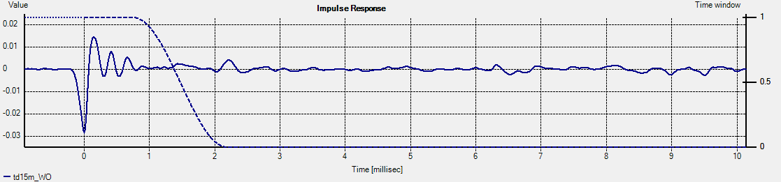

The frequency response is a graph of the power distribution vs frequency space. Frequency space and time domain are related by the Fourier transform. The raw data from most frequency response curves is obtained by sweeping the frequency generator of the source signal and measuring system response. The software then does an inverse Fourier transform of the response (actually implemented with what is known as the Fast Fourier Transform (FFT) - an algorithm to do the Fourier transform on a discrete set of data points quickly in computer code). This produces the impulse response (IR) or response of the system as a function of time. Note that the IR contains all the information to derive the frequency response and in fact, a better (but more difficult) way to get the FR is to have a setup that produces impulse step functions and a high speed microphone to measure the temporal pulse, then take the FFT of the time response to get the frequency response.
I did show spectrogram (like a 2d waterfall contour plot) plot of the Nautaloss early on - although I may not have set the time gating properly. Look at this post: http://www.diyaudio.com/forums/full-range/247598-nautaloss-ref-monitor-11.html#post3766222

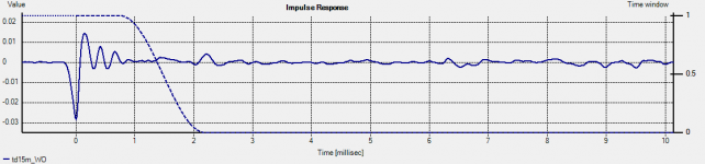

The FR of the Nautaloss II is here:
The corresponding IR is this:
Here, the phase appears to be backwards either on the mic or the amp/speaker. But look at how quickly the driver hits a peak and returns to zero (with overshoot). The main impulse peak and return occurs in about 100 microseconds (or 10 kHz equivalent frequency). So that is the IR derived impulse response of the TC9FD in a Nautaloss II enclosure. It is dominated by the flatness of the FR curve and the smoothness of the tails of the curve. Every little ripple and dip in the IR is a corresponding frequency peak or dip in the FR.
A sloppy or bumpy FR cannot produce a sharp IR with minimal ringing. The ugglier the FR, the more rippled the IR will be and vice versa.
I hope that helps.

yep that help's a lot thx for taking your time to explain that to me..
for the "fastest" decay driver i was more talking about the 2" to 5" ones.. or even the 5,6,7,8" ... because i'm used to electrostatics mids fast transient, fast decay and vanishing low distortion.. =) i think a saw a CSD plot of the Vifa and it wasnt near that decay you have on your build.. what is the crossover points used for the vifa..
actually when i look at the ripple in your impulse it still kinda too slow decay for me. I want full stop in the 500u or 1.0m..

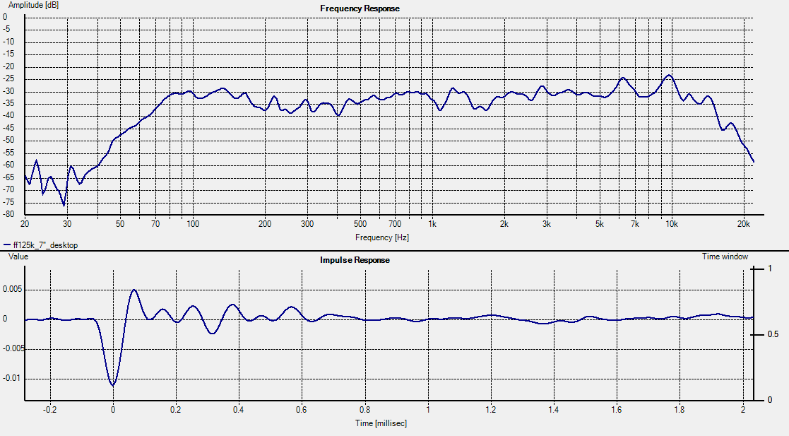

Since we're talking IR, here's the little FF125K's pictured on stands in my previous post. Enclsosures are ~8L/69Hz. Calibrated UMM-6, ~7" away, speaker in its desktop position:
FWIW, there is ~2-3ohm of drive impedance from the SE 6GW8 amp.
In any case, when can we call the impulse response settled? <10% of the initial peak value? Less?

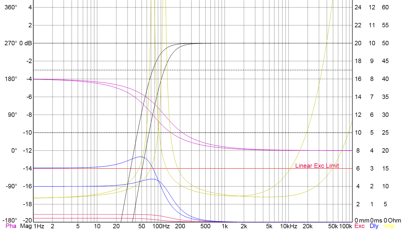

Funny see here picture-1 FF125WK verse Vifa set up in "WinspeakerZ" sealed Qtc 0,78, though in SPL mode FF125WK is approximately +3dB. IG81 thanks for sharing inspiration and data, very fine mans corner you have there in living room "HIFI/fishing gear" .

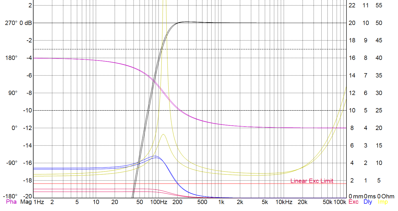

Could imagine some DSP bring FF125WK and TD15M in same phase domain would make a great FAST. Picture-2 FF125WK/TD15M sealed Qtc 0,707 though in SPL mode bass is +8,8dB.

Funny see here picture-1 FF125WK verse Vifa set up in "WinspeakerZ" sealed Qtc 0,78, though in SPL mode FF125WK is approximately 3dB better. IG81 thanks for sharing inspiration and data, very fine mans corner you have there in living room "HIFI/fishing gear" .

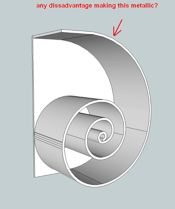

metallic spiral
i'm interesting for building something like this cheap loudspeaker.
I want to have some recommendations about this.
making this metallic is the easy way for me,but i want opinions about this.
Thimios.
Thimios.
