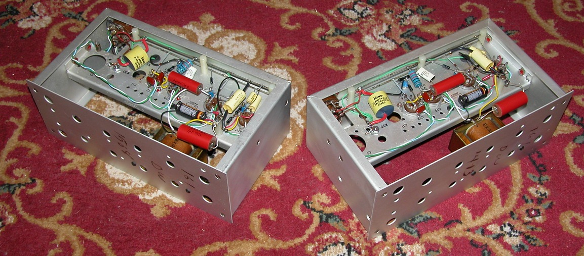

This project got started for no other reason than I needed another phono stage to use with my second turntable. I named it the Muscovite simply because it uses the Russian 6S3P-EV high frequency triode.

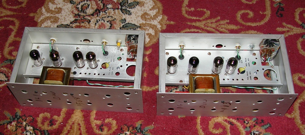

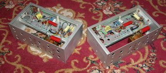

The design is built on a couple of repurposed Tektronix vacuum tube pulse generator chassis.
I thought I would have some fun with this design so it literally includes everything but the kitchen sink. The input stage is what I would term a mixed bias cascode with diode and grid leak bias. The second stage is a choke perverted version of the mu-follower which uses a combination of battery and diode bias.
It was also intended to be cheap and use parts I have in my stash.. (mostly)
The design has minimal PSRR and must run from a very quiet power supply - in my case tube preferred, but I suspect the Salas HV shunt regulator could be a good choice.
The gain is deliberately insanely high (>54dB) as I use a line stage with 4dB of voltage gain, and I wanted CD reference level output. It also had to be quiet.

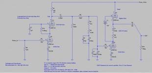

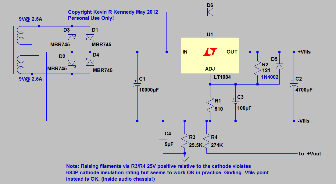

Edit 2013-05-12: Please see later posts in thread for current HV supply and audio circuit designs.

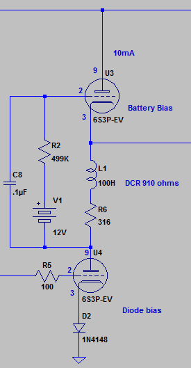

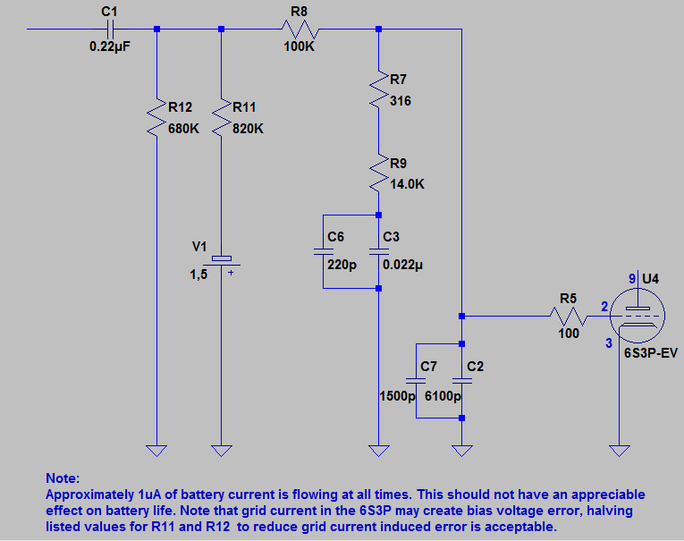

I am now using this with my TD-124/II/Schick/SPU set up and much prefer it to the one it unintentionally has replaced.
There are a couple of variants to the circuitry that I have not explored, but will share here for those who are interested.
I have included an alternative biasing arrangement for the mu-follower upper triode for those concerned about possible battery induced audio colorations. In practice I have not had a problem with this issue and was not looking to spend too much on this design so it's economical. No detectable downside so far.
I have also included a way to apply battery bias to the lower tube in the mu follower. This would eliminate potential distortion in the mu-follower due to modulation of the 1N4148 dynamic impedance due to variations in the audio signal current. Again I have not heard or measured a problem with this, and have not tried this approach and probably won't.

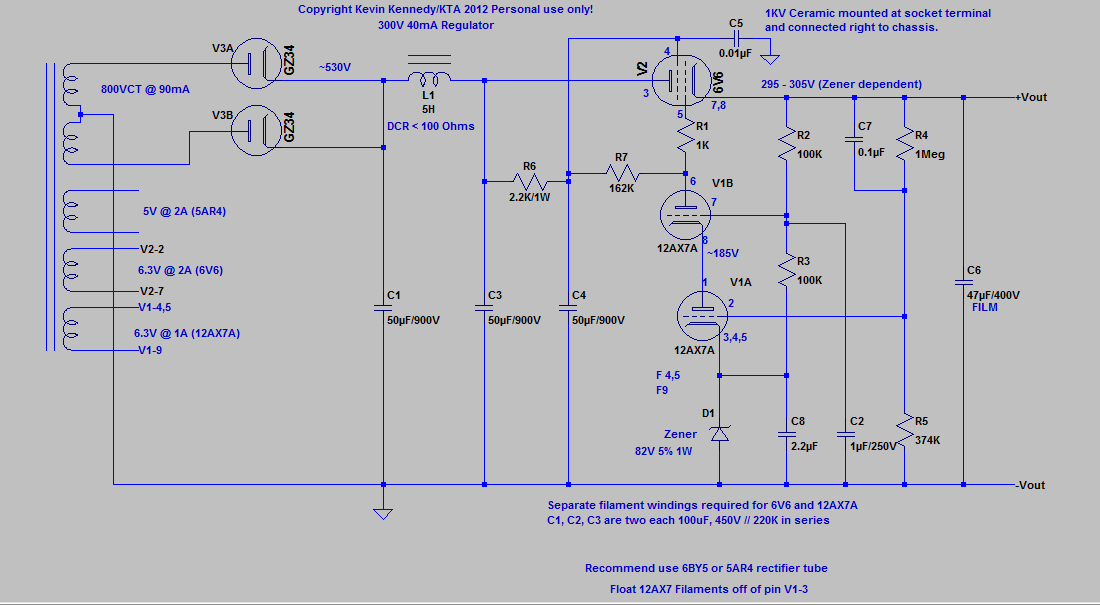

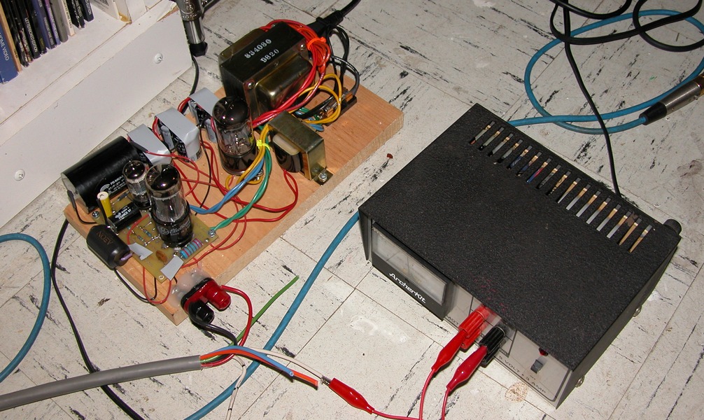

Power Supply (Breadboard Version)
This is the power supply as it currently (and temporarily) exists. Note that despite my best efforts there are a few exposed high voltage points so this is definitely not recommended except in a lab situation..
Should note that as this phono stage design operates on 300V and the raw supply to the regulator is well over 500V that care in its construction and testing are required. (Construction, testing, and use at own risk.)
The design shown in the photograph utilizes a 1.5H choke, and manages a measured output noise and ripple level of 0.35mVrms (300V/35mA load/120Vin @ 60Hz) which is acceptably quiet, with the 5H choke specified in the schematic above the noise levels will be significantly lower if care in construction is taken.

Why burning a huge drop? Utilizing an existing Tx reason?
Pass tube requires a minimum of 200V for proper operation, it is a series pass after all. I actually get transformers built to spec for most of my designs. Based on ongoing listening experience I still find I prefer this design sonically to some more recent designs. I have not tried the shunt yet..
