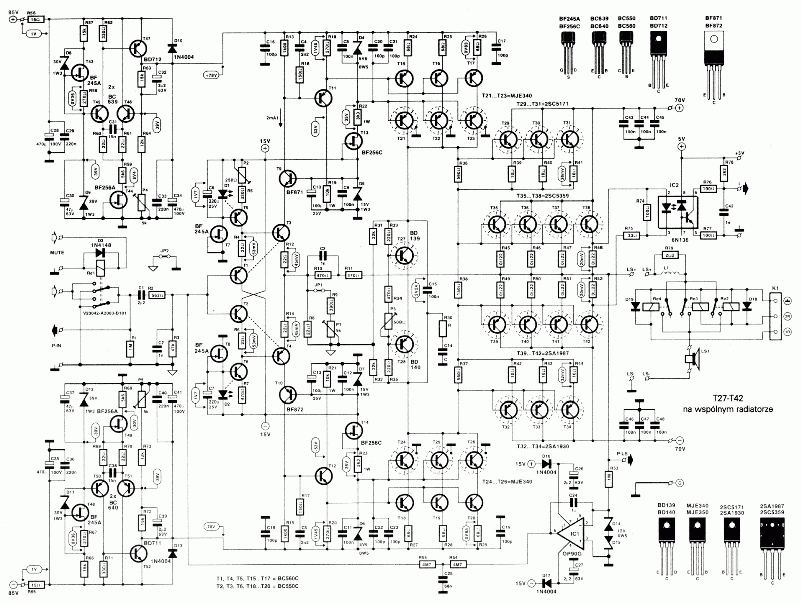

The most complex amplifier that you ever see
GainWire mk3 CFA pre/phone amp with very low distortion
It is so complex that I can't get myself to finish building it.
569144d1473523097-gainwire-mk3-cfa-pre-phone-amp-low-distortion-gainwire-mk3-gnfb-cfa-sch-jpg
You can't call it complex, it's quite simple. Push yourself to finish it and you are going to be surprised by its sound. It's full stereo and power supply on one board (not showed in this schematic), that's way it looks complex.;)

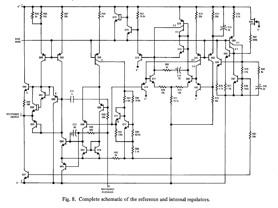

I think I recognize the drawing style in post #4 (kind wanna say "schematic font") from old National Semiconductor ...
Also, I think there's more to it. Another page?
Where does the net Bias Buss go?
Schematic in post #4 comes from the IEEE Journal of Solid State Circuits, December 1978. There is indeed a second page of schematics. The schematic attached to Post #4 above, is the amplifier itself; the second schematic page (attached below) shows the only bias circuitry.
This 39 year old amplifier is still in production; DigiKey has hundreds on the shelf, and the TI Store will gladly sell you thousands.

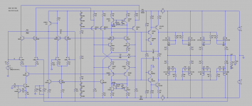

Really anything that uses a monolithic opamp, either in the signal path or as a DC servo, is going to have >50 transistors.
Even without using monolithic parts it's possible to build the transistor count up fairly quickly. Symmetrical differential topology involves plenty of transistors, and more so with copious cascoding. An amplifier that I've been playing with in simulation (that once upon a time bore some semblance to David Tilbrook's AEM6000) has 44 transistors, though I'm cheating a little by including a DC servo in that count.
