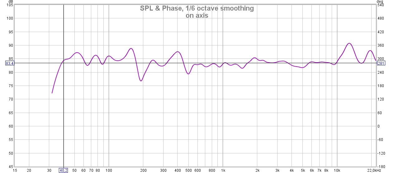

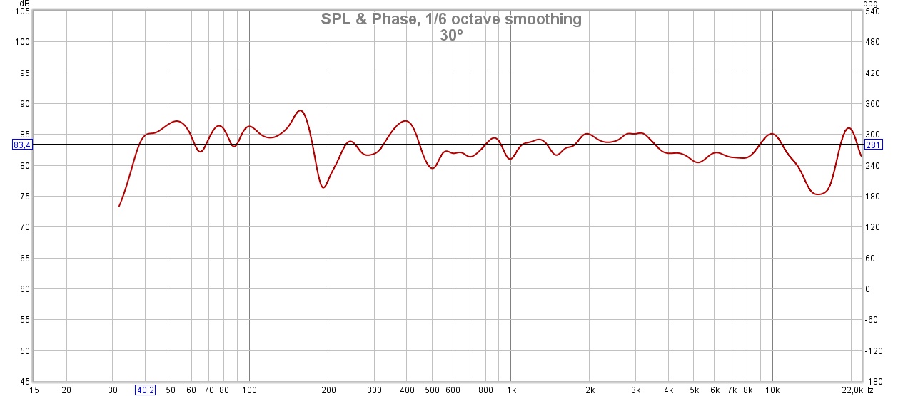

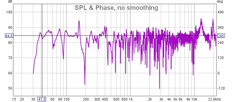

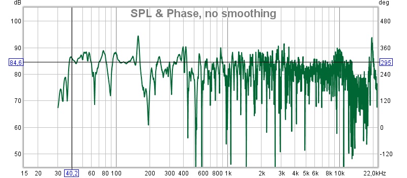

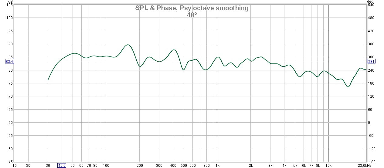

Today I measured frequency response. REW+Dayton UMM-6 (calibrated). My listening room makes very strange bass response, then I measured Metronomes outside.
Mic is bolted to a post, leveled and 1m from the speaker. The amplifier is setted to 2.0v, which I believe equals to 1w for this driver. No fiber inside the box, just felt in back and top panels.
These are raw graphics on axis and 30º:
Dave, please, tell me which smoothing is most useful and I'll post. And if you like to see any other measurement.
I'm really happy with this measurements. The driver goes very low and is more sensitive that I thought, amazing for a 4". This Pluvia 7HD works well in the Alpair Metronome and is a very good driver for the money. :D :lickface:
Víctor

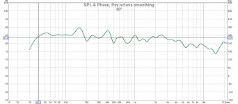

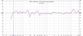

Measurements with 1/6 smoothing. Like previous, 1.98v, mic at 1m, open air.
Nice to see how treble response varies when turning speakers, is a easy way to fix rising frequencies.

Thanks Dave :D
Like I said before, I'm very happy with these speakers. This pair will go as a present to a friend.
This Pluvia 7HD is a good driver, and the price is right. Markaudio solds them as matched pairs, with wood screws and good rubber seals. The new thin bezel is better than old Alpair because no rebate needed. Highly recommended.
