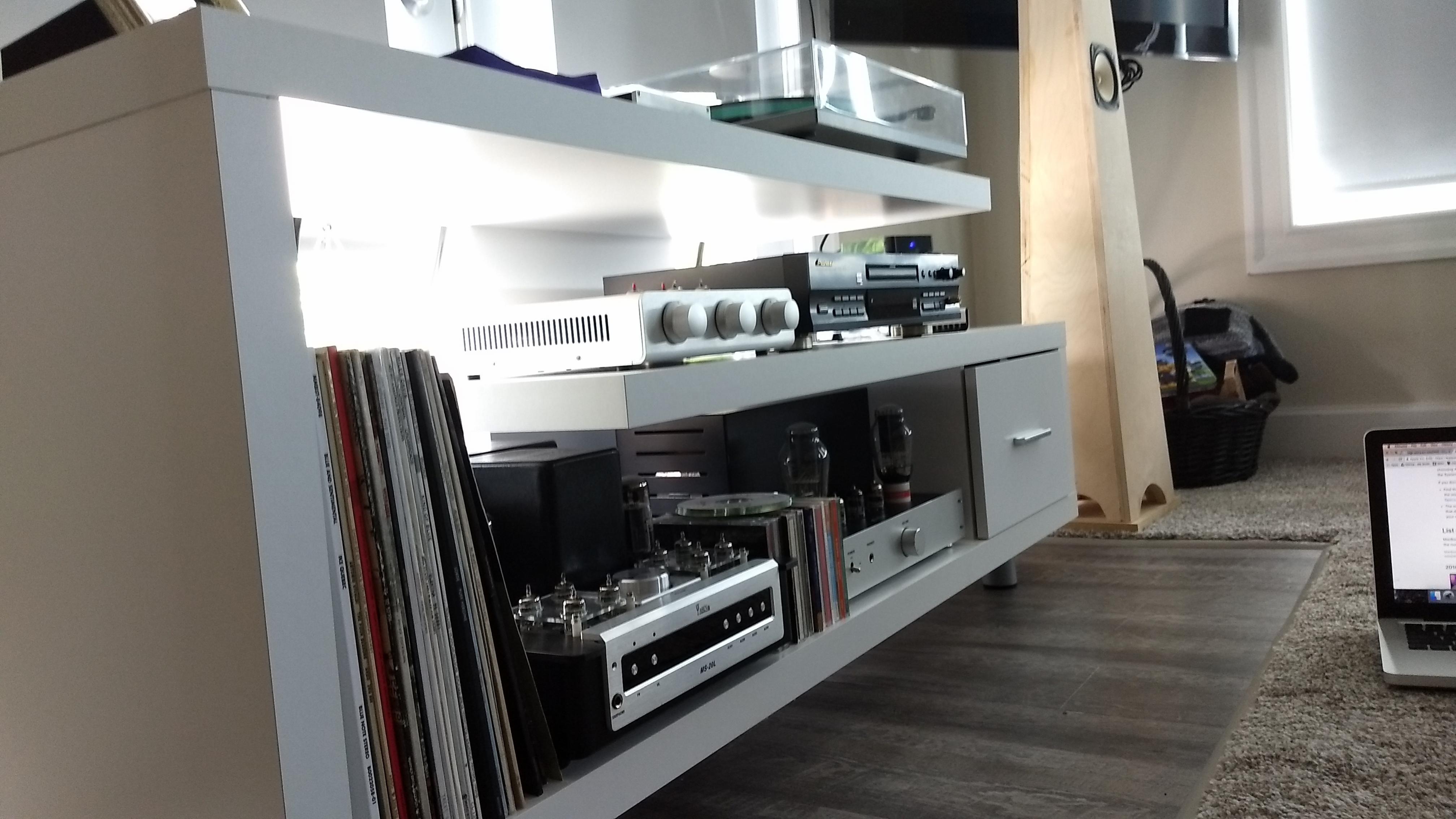

I have about 50-60 hours on my FE127 Metronomes now, I have to say they sound exceptionally good. They load my small-ish room very well. They seem to like the PP EL34 amp more than the 300B SE. I've had numerous Fostex systems over the years, but none this good. I have a $2k pair of speakers sitting on the bench now, and I haven't been tempted to pull them back in yet.
(not sure why the left speaker looks like a leaning tower in the second pic! Thankfully looks ok IRL. )
I have about 50-60 hours on my FE127 Metronomes .....They seem to like the PP EL34 amp more than the 300B SE.
These are medium Qts drivers whereas the 300B 'wants to feel' what we nowadays refer to as a horn driver [low Qts], such as Lowther, etc..
