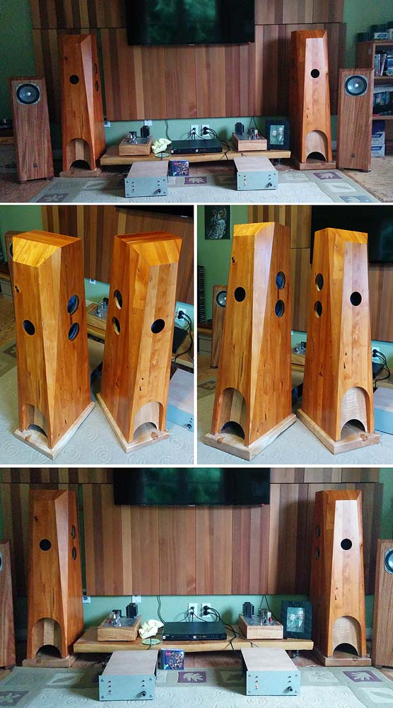

Grilles came this morning. Have got them fitted.
They're....er....strong and practical, but essential. :)
I tore myself away from the speakers and dismantled them for finishing.
Veneering is now completed:
They will be left to stand 24 hours, after which the deep mahogany Danish Oil
finish will be applied.
Apologies for the grainy picture, but the crappy camera on my iPad is garbage in artificial light.
It also distorts perectives. The tops of the pyramids are smaller than they appear
and the bases are wider than they appear. IOW these speakers are a lot more "pyramidy" than they look in this pic.

These are the early stages of assembly, way before final trimming and shaping of the legs and arches. The pics show the interior partitions that form the two tapers for each half of the line.
View from wide end, up through the cab:
View from top of pyramid, down through the cab:
In the above images on the top one, the line can be seen expanding up, towards the cabinet base, whilst on the bottom image the line can be seen contracting downward, towards the cabinet base.
All this took a lot head scratching to translate my plans into actual bits of wood that were the right shape and had the correct angles cut into them. But we got there.
