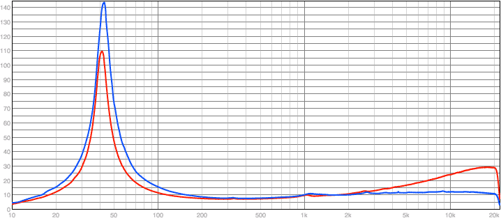

Just to clarify, regarding the BSC. I only need it if the speaker is not against the wall? ... does that include the Zobel Network part of the circuit? I take it that is still needed with the 207's ..
What impedance should I be driving it with 4..8 ohms?

The Fostex is an 8Ohm driver.
The BSC will not be needed if the speaker is placed next to a wall.
If you have them out in the room, then BSC is needed. Jim Shearer has built quite a few Mets and as far as I know he has not used the Zobel network with his BSC experiments. You could PM him for his opinion.
If it helps, my own Mets use Fostex FF225WK drivers with a helper ribbon tweeter. They were built into the cabinet designed for the FE207E, the only change was the port length. They do not use BSC and sound great next to my wall.
Try them without the BSC and if you find the speakers too in-your-face then try out the BSC from the starting points given in the tables.

Yep, I realise that. But with an 8 Ohm resistor and 6uF cap Zobel across it, won't it's impedance be more like 4 Ohm? .... (at most frequencies ....)
But like you say, I will try it without the Zobel first ..
The arch vents are the diameter of the port tube at their highest point ie 3"
Thanks.

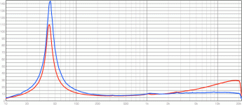

No.
The Zobel is there to try and keep the impedance down to 8 ohms in the HF region where it rises.
Attached is an impedance measure for the FE207 (red) vrs the FE206 (blue).
The copper cap on the FE206 flattens the HF impedance, on the FE207 if you need flat impedance you need a zobel. The zobel is there more for the amp than the speaker.
