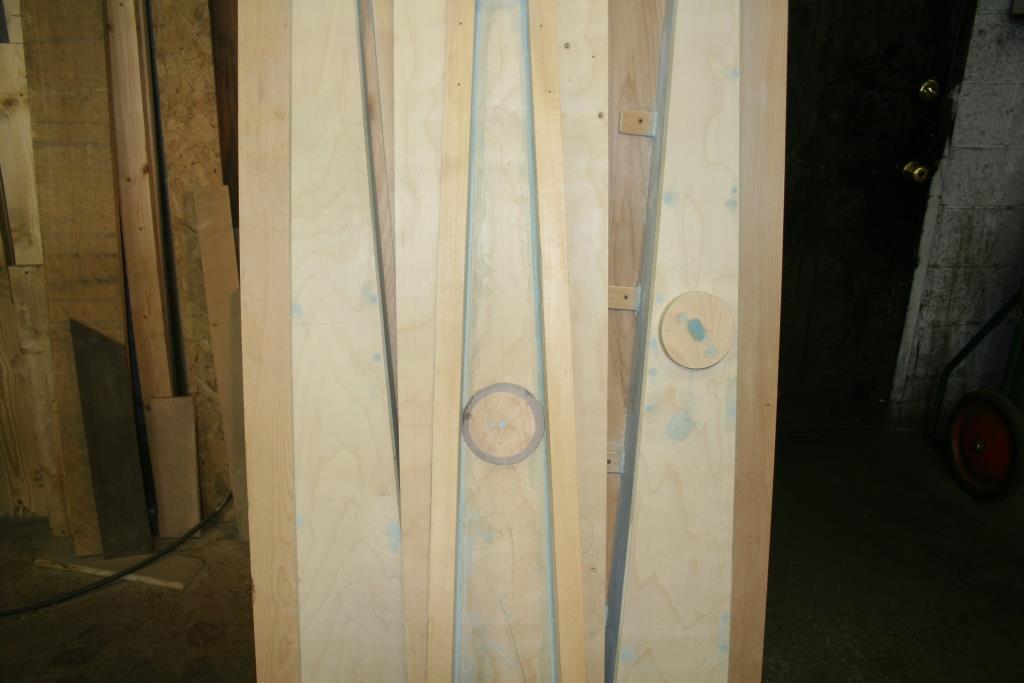

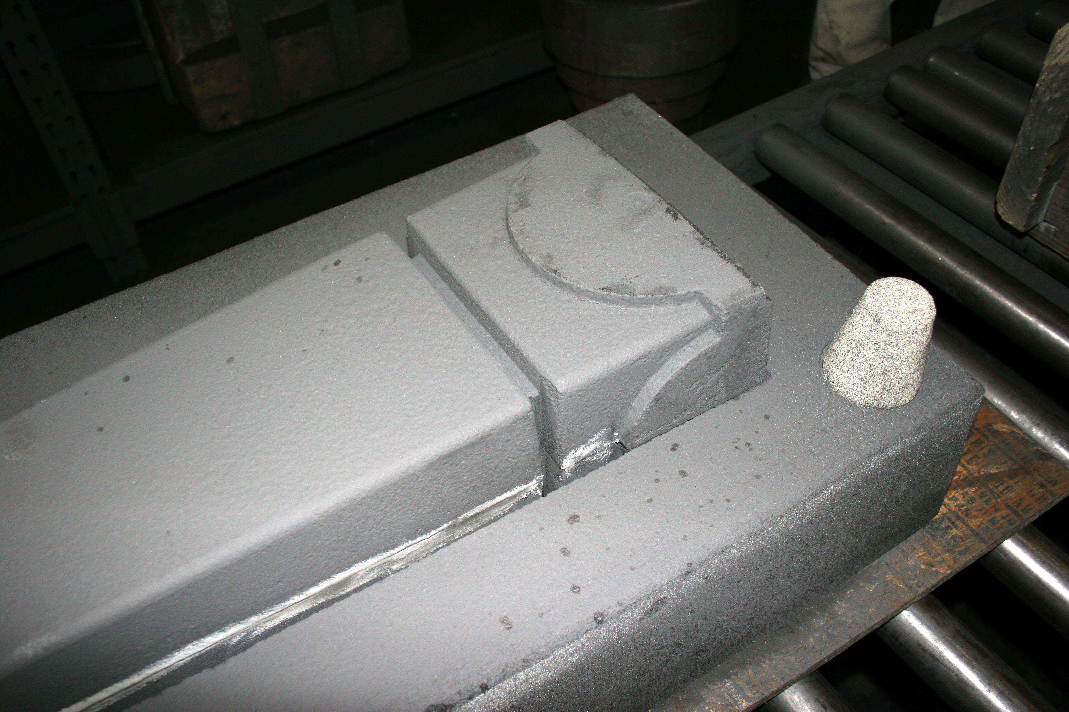

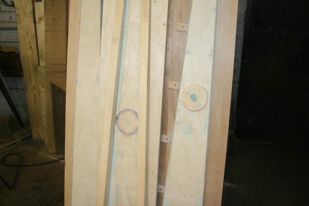

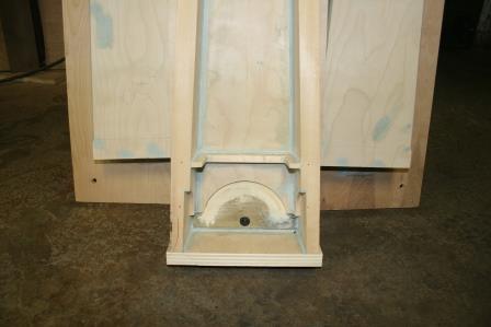

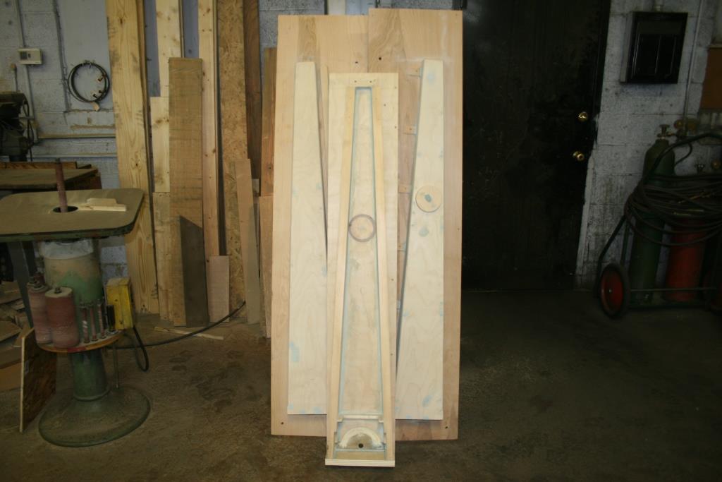

The foundry patterns for the Metal Monster Met are complete. 3/8" wall thickness. Still 100 lbs. in iron and 33 lbs. in aluminum estimated.
They look very slender, but each pattern is only half depth, so it can be deceiving.

Very cool. I'm wondering though - why not go with curved sidewalls and/or heavily radiused edges, since you are casting this thing?
Of course that would make carving the patterns a lot more work, not to mention you may or may not like the look.

Greg,
I think you'll read the form as more "rounded" when you see it in the casting. The sand casting will have considerable texture and I'll work it a bit by hand and then we'll play around with some patina ideas. I think you'll be impressed by what the texture can do to simple forms. I really liked the look of the Met and wanted to pay respect to Steve's original vision of the Met and the subsequent design work in the community.

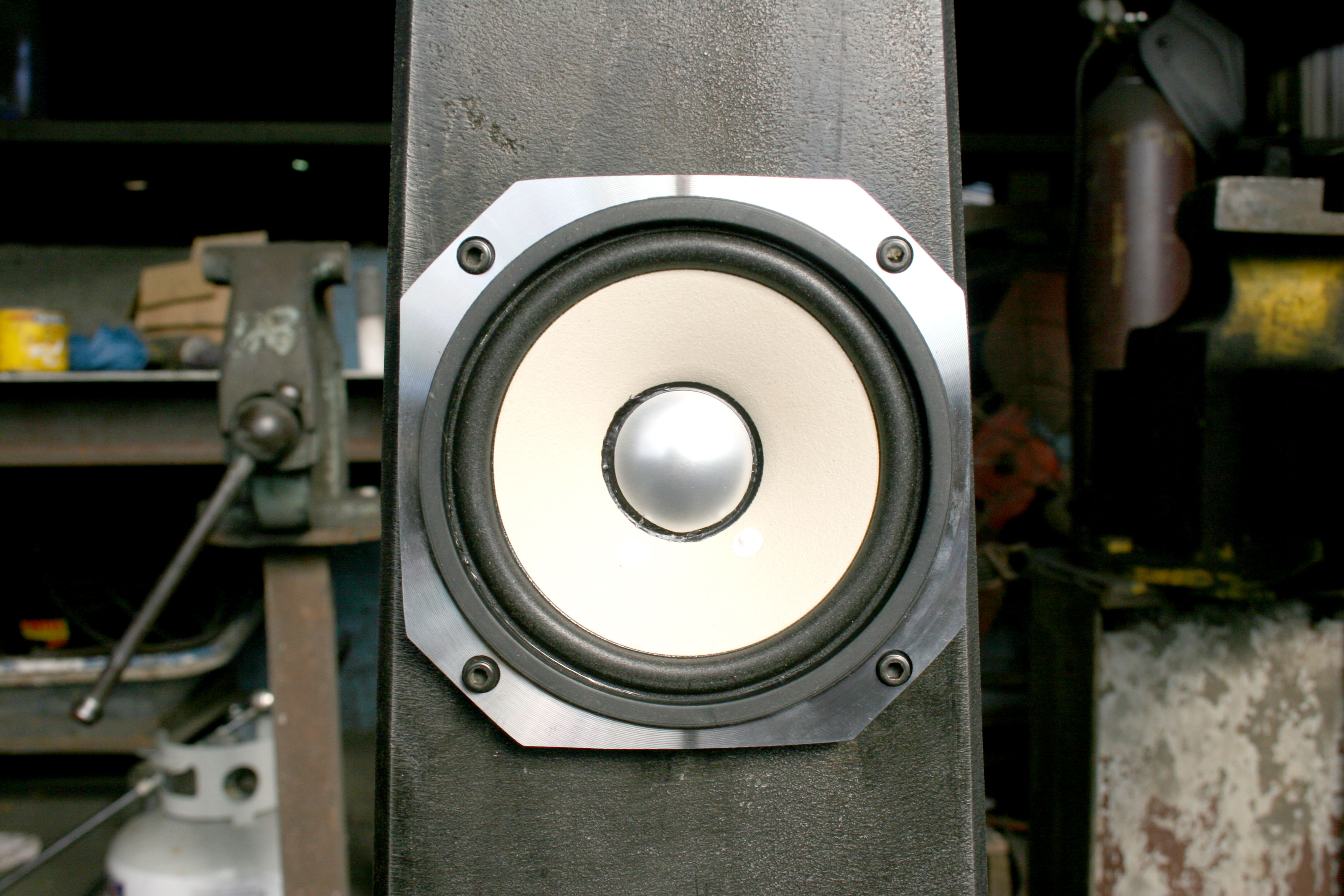

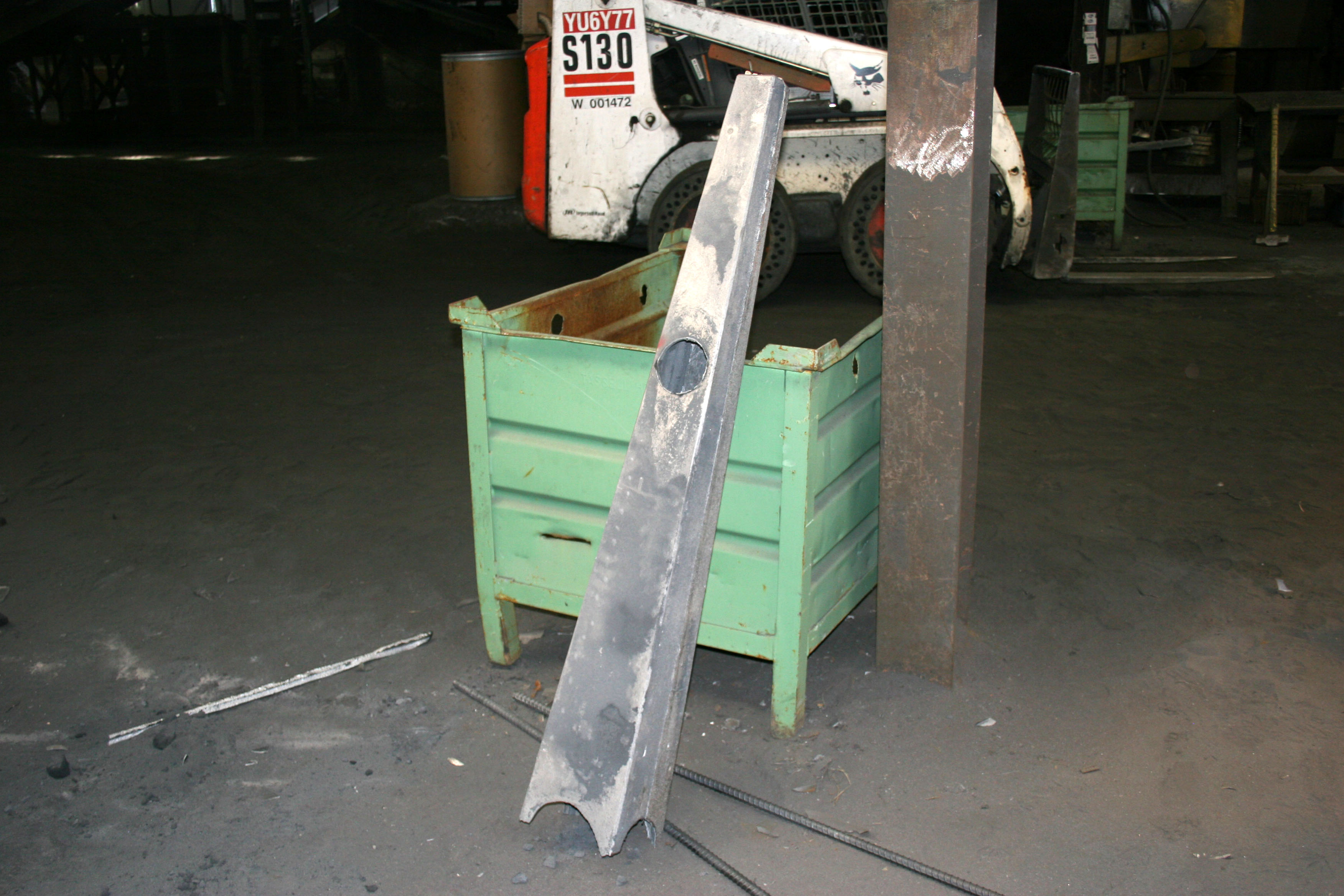

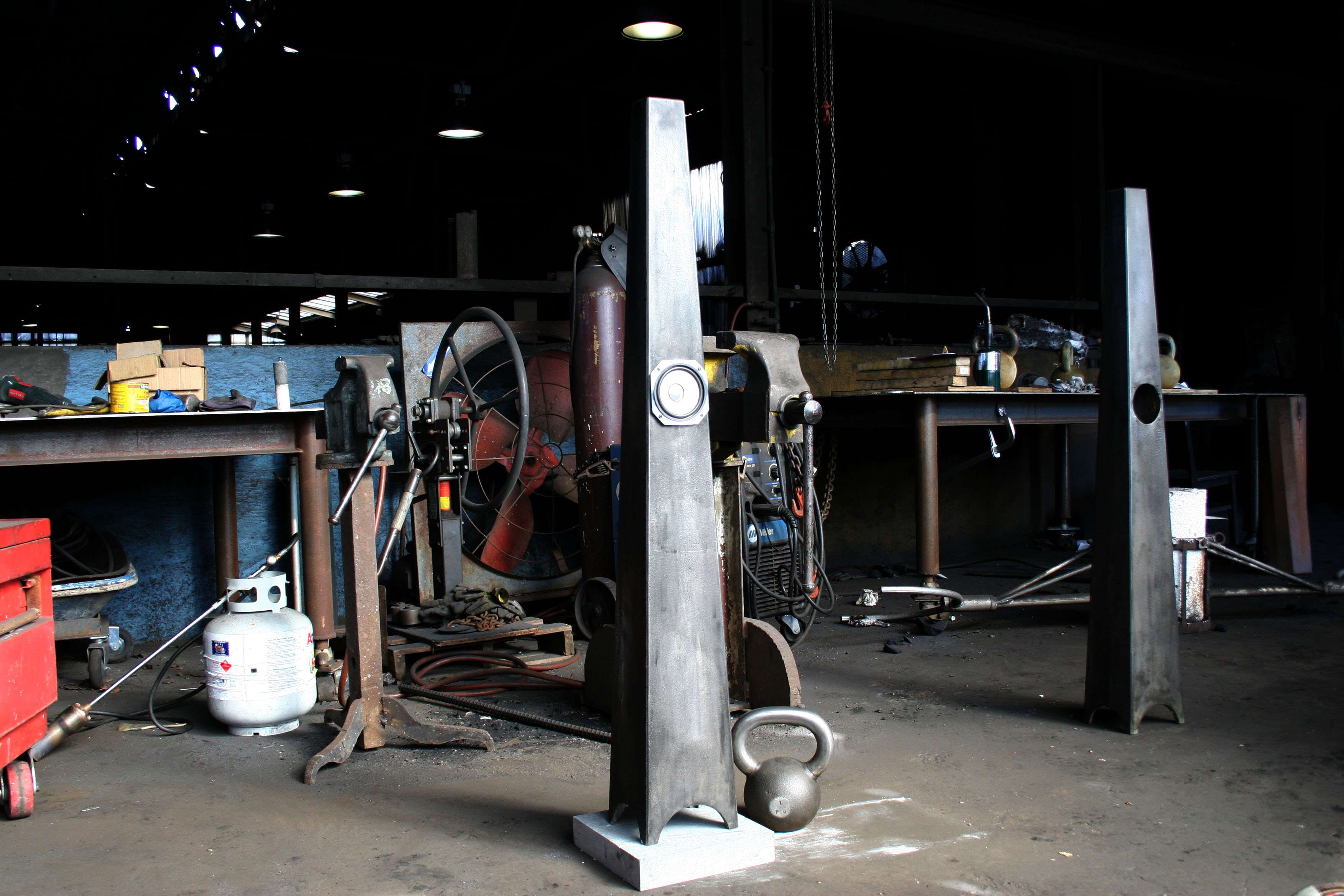

Help, the Metal Monster Met's are alive!
I just wanted to confirm. For the FX120 driver, in the 52" Met design by Jim S., the port should be 3" I.D. by 4" long? It seems huge. I have some 3" PVC pipe though, so I'm good for this.

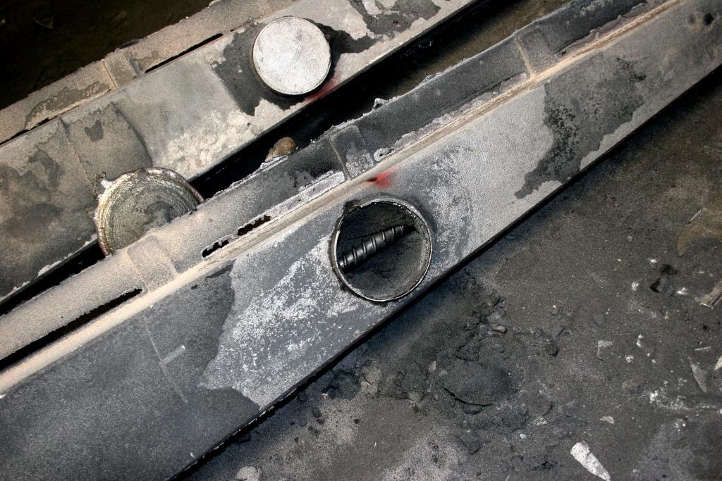

See the pick of the rough castings. Build images to come.

Jamie,
That's right: port is 3" ID X 4" long. No narrow, little chuffy ports here! Designed with MJK's MathCAD worksheets. Not only that, Martin came over & checked them out himself! (That was the time he brought along a tube amp & I discovered that the F120A loves tubes. blew my mind!)

NICE!!!
Finally, the metal metronome!

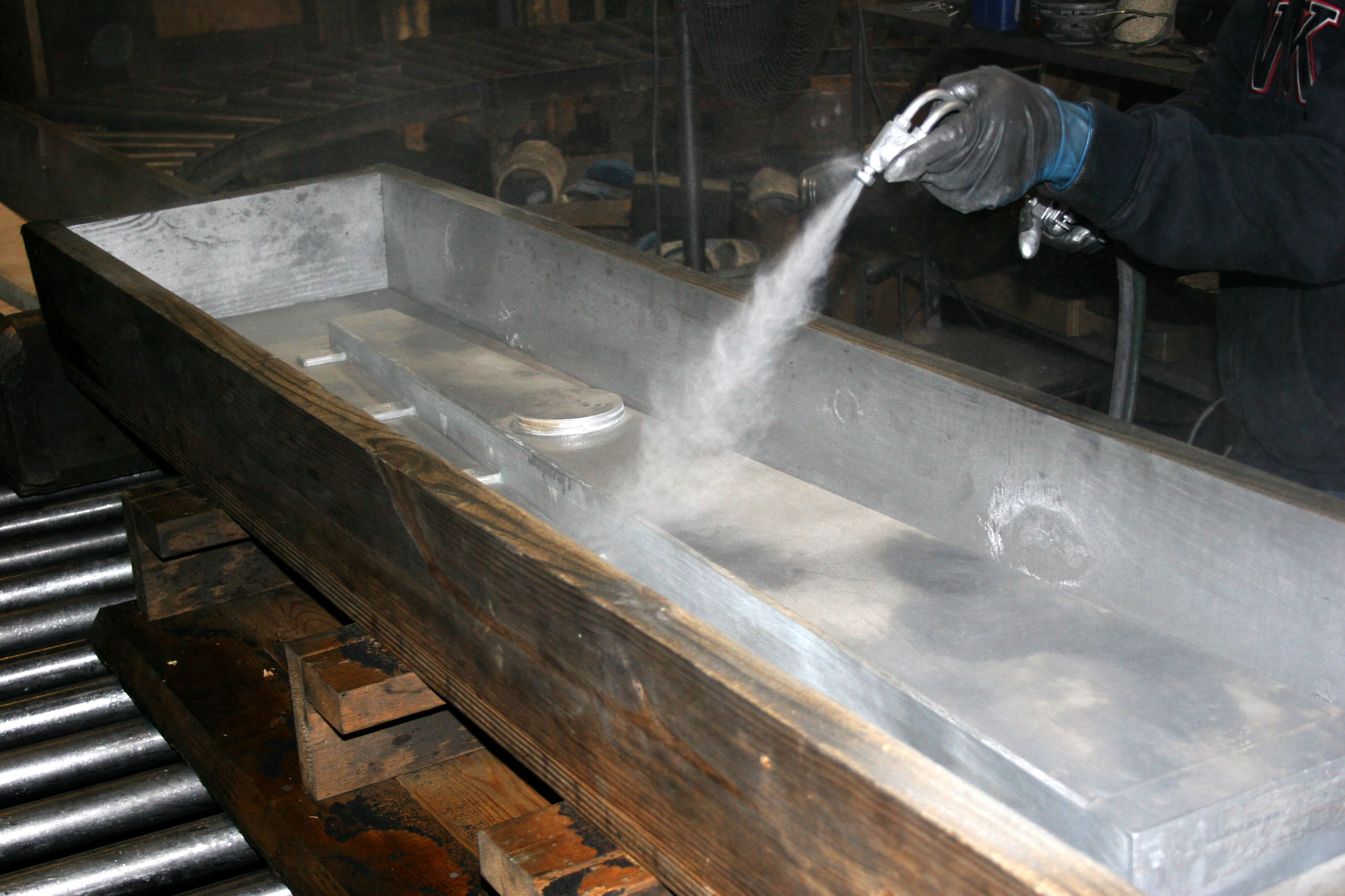

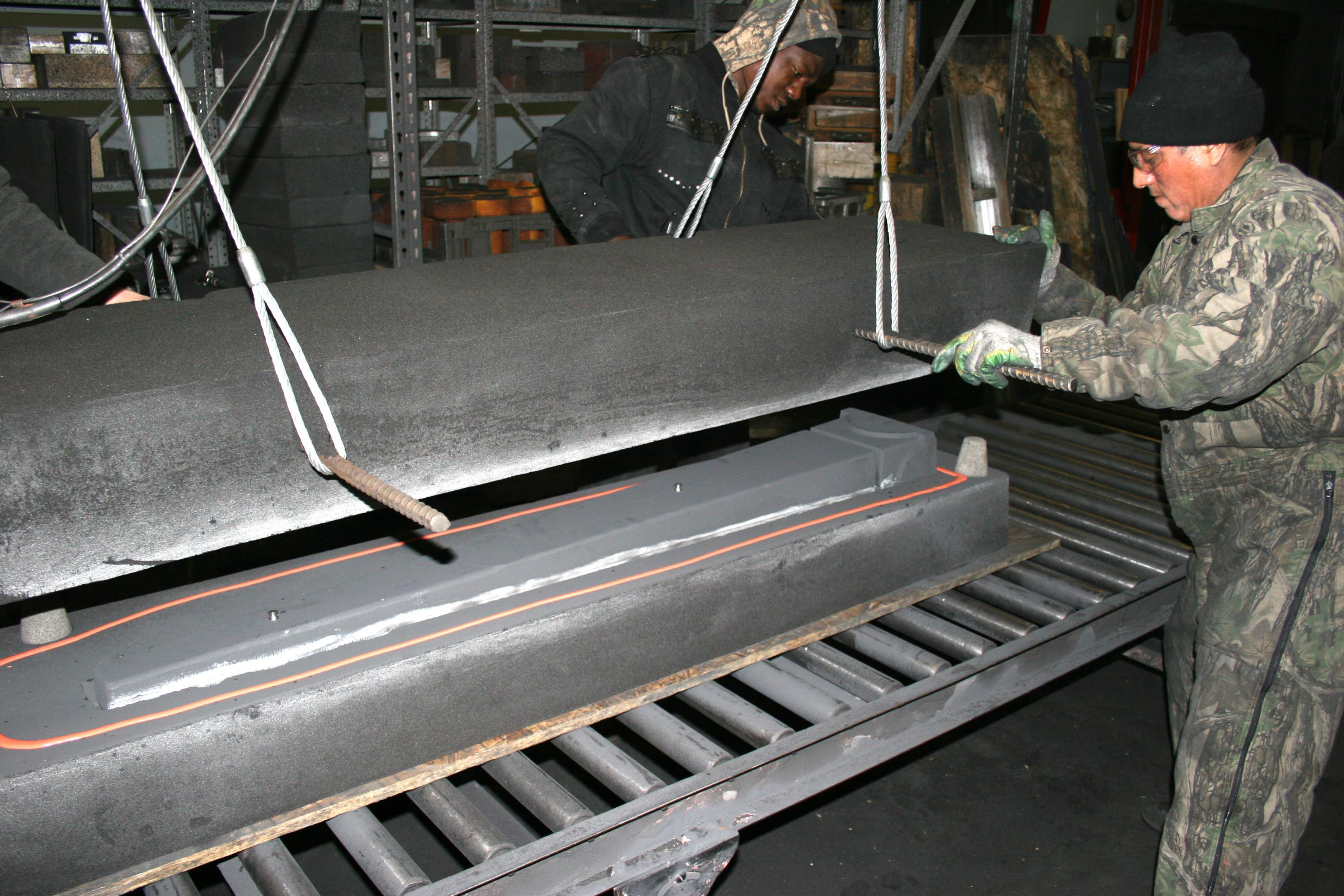

Care to share some pics of the casting process?

I can't wait to see these metal mets come to fruition.

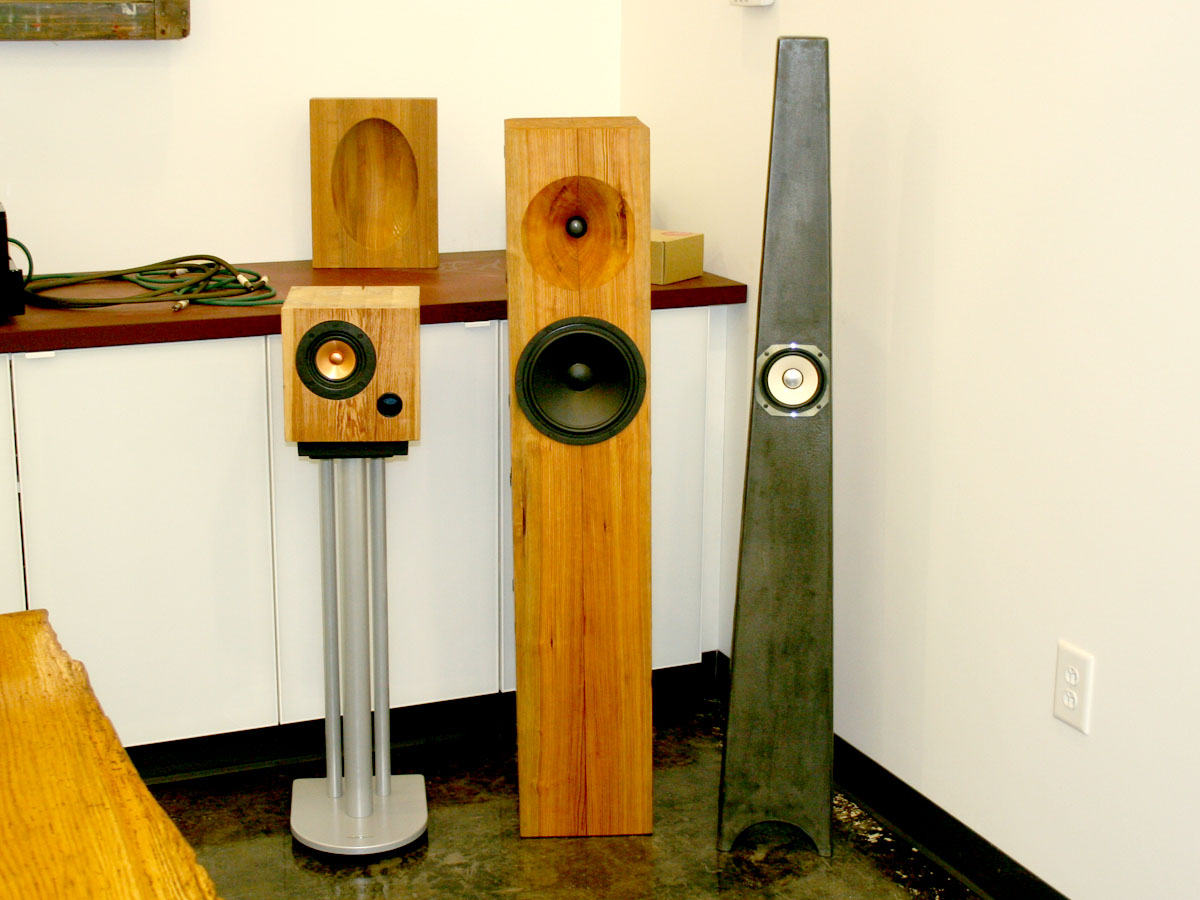

I have finished the Metal Monster Mets and they were debuted at one of our local audio club meetings. I'm still working on trying to make a proper listening impression, but I haven't broken in the drivers or hooked up the Mets properly yet. I have a pair of nicely built FH3's at home with a KT88 push/pull, so I hope to try to make a good comparison. I might need to get some better ears than mine to take a listen though.
Anyway, on with the build photo's.
I've posted a complete set of build images at this link to my Flickr site and I'll post a few here.
Metal Monster Metronome - a set on Flickr
Thanks to everyone for the help. I'm really excited about these Met's and I'm so grateful to have such a well done design to copy.
