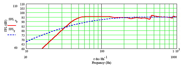

Philips 9710M [Troels measured] with more in room tuning flexibility/extended LF, especially if driven with a high output impedance or other driver needing a larger cab [~192 L/6.78 ft^3 net]:
L= 60"
S(o)= 35"^2
S(L)= 428.75"^2
Zd= 30"
Zp= 60"
density= 0.25 lbs/ft^3
Rp= 2.5"
Lp= 0.75"

The T/S parameters I measured on my pair of ceramic magnet AD9710 were very close to that of Troels' Ticonal model. He seemed to be OK with the Philips recommended volume of ~40L; I found mine a bit too bloomy in ~50L. Interestingly enough, I though they did better in my Karlson K12 with ~36L of back-chamber. I guess the wider gain BW and location behind K-slot helped balance the notoriously Lowther-esque top-end.
They probably would sound great in a large QW design.

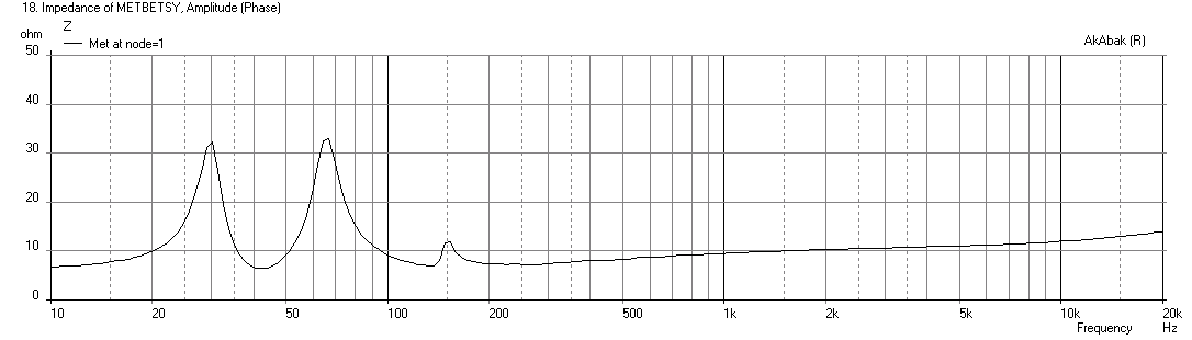

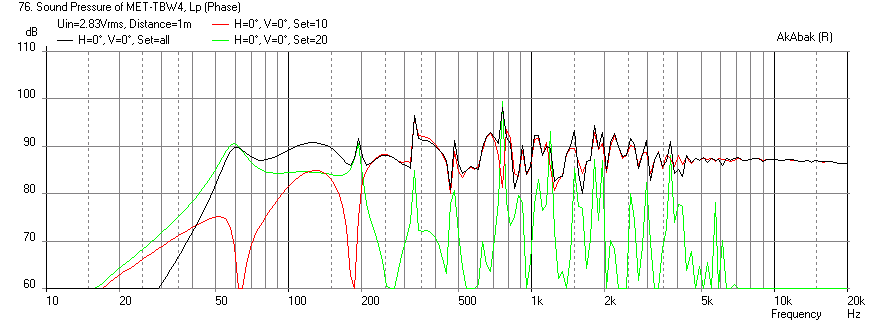

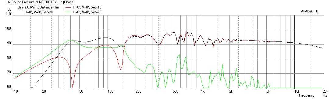

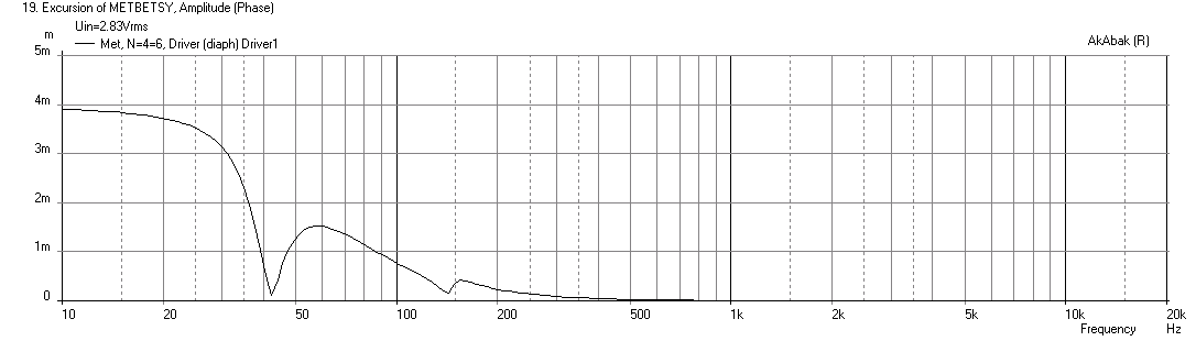

Here is a sim of the Betsy K in a Met that I came up with a while ago.
Design is: 8 in wide x 2 in deep at top, 26 in wide x 16 in deep at bottom, 60 in tall with driver at 23 in from top, 5 in dia x 2.25 in long vent at bottom, 3.5 in tall feet to let vent radiate out. Use stuffing from top to 2 inches below driver. Sim is for placement 60 in from wall 1 watt at 1 meter. Use 1.5 mH + 4 ohm in parallel for BSC.
It is a big speaker - the Met is not as compact as equivalent straight MLTL. Be careful with content below 40 Hz as excursion is large. Use only low power amp (< 5 watts).

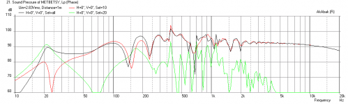

For grins, here is same speaker upside down but vent is at bottom and driver at 37 in from bottom. It is a converging TL rather than expanding, same volume. It goes much deeper but there are dips and peaks.

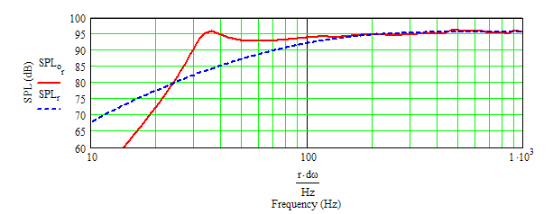

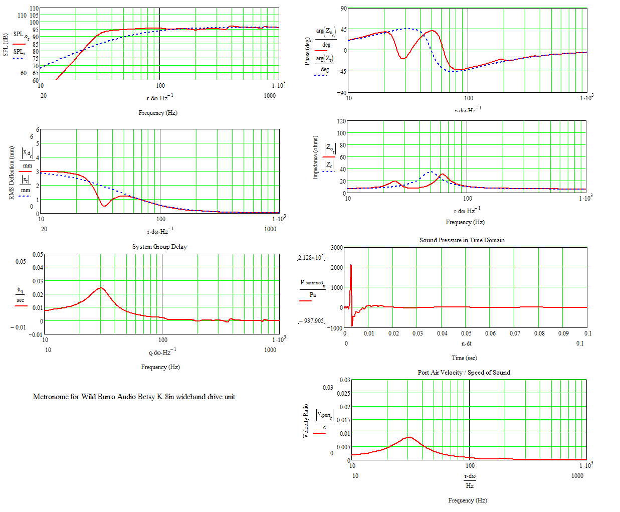

FWIW, this is the Betsy K Metronome I did a few months back for the FH site.
H = 72in
St = 5in x 5in
Sl = 16in x 16in
Zd = 36in
Vent = 4in diameter x 0.75in long
Line cabinet throat, back & one sidewall 1in acoustic fiberglass or similar & adjust as required. It has a very slightly damped alignment; you can increase this via the vent or damping as you see fit.

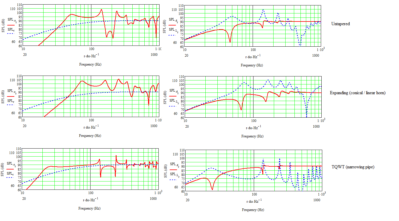

Does a contracting taper somehow increase the magnitude of the peaks and valleys in the frequency response? It would seem that conservation of energy across cross sectional slices through the line would indicate something like this. I might expect some non-linear features/interactions of the velocity field could lessen that, but not enough.
Not really; if anything, it can be the opposite, but this is circumstance dependent.
Assuming the same axial length and a constant internal volume, a narrowing pipe is inherently mass-loaded and has a lower Fb, with typically greater suppression of the harmonic modes. See attached. Three pipes, of the same physical length and total internal volume: untapered, expanding (horn) and narrowing (TQWT in its traditional parlance, i.e. the exact opposite of what is usually called a TQWT today). As you can also see, the horn has the widest gain BW, the TQWT the narrowest. I've left damping out to better illustrate the pipe behaviour -in all cases, these would need some damping & note these are not supposed to be in any way optimal, they're just illustrations.
