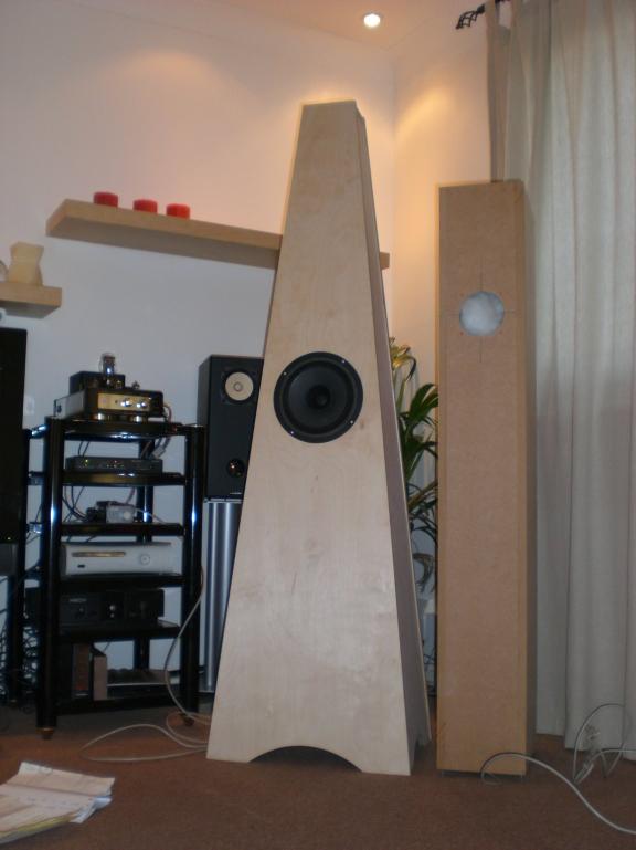

Hello, i wonder if i could have a little advice please, having built iBIB for a fostex 127 and this weekend cut the metronome for the hemp fr8c they both have failed to pass SWMBO aesthetics test and earn residence in the lounge due to their size.
I have not glued the metronomes yet, are there any modifications that could be done to drop a little height or make them smaller ?
I believe the internal volume is approx 79.4 litres using the dimensions from the planet 10 table and have read "Feel free to play with the aspect ratio of the start & finish rectangles -- make sure you leave enough room to mount the driver & fit the magnet."
I think i already know that there is not going to be a substantial change so would like to hear some suggestions for another design and reuse some of the wood, eg the Demetri ?
What drew me to the hemp metronomes were the reports of fantastic imaging and full sound without being too heavy on the bass. How do the Demetris preform in comparison ?
thanks in advance for any help

Should be similar in many respects. You can't cut the height down because the length is part of the resonant tuning -the aspect ratio refers to the WxD dimensions.
The iBIB isn't especially big, so it sounds like your partner isn't going to be too keen on anything other than B£$e unfortunately, so I'd probably check in advance in case Dimitri is too wide.
Scottmoose said:Should be similar in many respects. You can't cut the height down
Well you can loose about 3" by sticking the port out the back, and loosing the arched open area at the bottom. This would also marginally decrease the footprint.
The Monoliths (Mileva & Demetri) started out in concept as a folded Metronome specifically to contribute to WAF. When you stand next to Demetri it doesn't seem that small, but it is less than a meter tall... Mileva is quite diminuative.
The FR8c is not ever going to fit into a really small box, i have successfully shoehorned FE127 into 4.5 liters (ie LS3/5A sized box -- with FE127eN they destroyed the LS3s we had by here (and soon we'll bring up a pair of Spendor BC1s for a compare))
