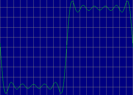

Hi Mike,
that wasn't actually the test I had in mind... though interesting (my first thought was, hmm, tests for channel crosstalk...).
What I had in mind is, if you roll off frequencies which by themselves are inaudible to you as a pure sine wave, does this "soften" regular, sharp transients as encountered in music? Or produce some other audible effect?
For this, complete removal of say, >16 kHz content is not necessary, just a steep rolloff. The most important thing being that level and phase below the cutoff should be as untouched as possible. Say if you hear until 14 kHz, make a cutoff at 16 kHz which at 14 kHz has less than 0.1 dB deviation. If possible. Phase will likely start shifting way below cutoff but that is part of the effect to be tested.

A good A/D converter samples at a much higher samplerate and
downsamples digitally afterwards. This way you don't need a filter
at 22khz that would impact also lower freqs.
The problem with your test could be, that the 48db/oct filter might
introduce artefacts, i have no idea how to be absolutely sure !
The best would be to use equipment working with 192khz samplerate,
and apply filer again digitally ? But who has such equipment...
btw, a correct filter would not really "round" the transients, it looks
more like symetrical ringing.

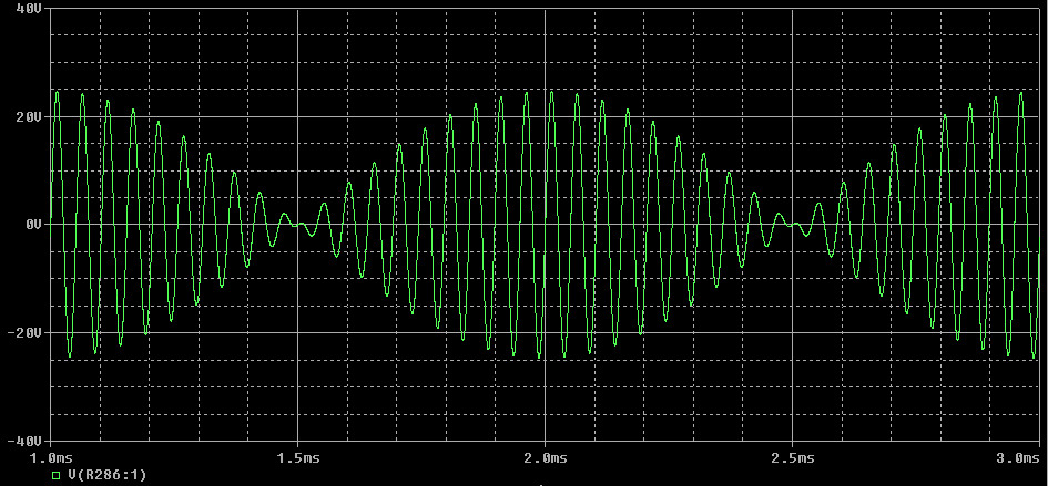

I can actually hear both left and right channels, although the 20kHz was faint. When I played the signal back on my laptop through the built-in speakers I got a nice 1kHz tone alright. Shifting the balance control to either side removed the 1kHz tone. Through the headphones I could only hear the constituent tones - even if I had both caps to one ear. Apparently the intermodulation is created in the output stage of my laptop.MikeB said:Okay, just listened to HF-content...
Here is a simple wave, fs=48khz, left channel is 20khz,right channel is 19khz.
http://www.lf-pro.net/mbittner/TestWave/beep.wav
The pure frequencies are not audible (for me), playing them both
results in a nicely audible 1khz-sinewave... (not subtile)
So much about HF-content not audible ? This seems to negate all
comments like "nobody hears distortions on 20khz signal" ?
If it's true that the ear is very able to "hear" that high frequencies,
keyparameters for amps should be quite different than they used to be ?
Mike

Rune, this signal is quite bad, looking to it's shape, it's simply asking
for problems. It looks like a 20khz modulated with 1khz, but it really
contains only 19 and 20khz !
I think, a bad powersupply is already enough to make the 1khz audible...
Mike

That's my favorite test signal.
It stresses the output transistors at the top of the audio band (where they are worse), NFB is at the lowest level in the audio band.
And it's easy to filter the 1 kHz out for measurements..
