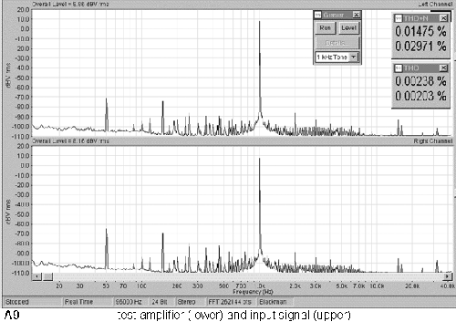

With respect to the latter, how would you like this? Stay tuned, I will be releasing more details as soon as circumstances allow.
Note upper trace is input signal, lower is output (attenuated to match level). Card's lower channel input performance is slightly better.
Rodolfo
