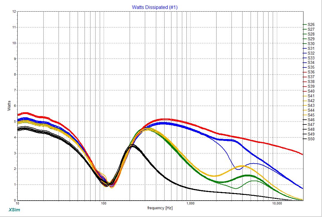

Spending an afternoon trying to figure out how to distribute the impedance curves into valid groups.
It is slightly different than one would need for an unshaded array, as there is some added resistance to certain groups due to the added filters.
Basically the goal is to have an average equal impedance across the board for all groups. Making the average of the peaks line up as well.

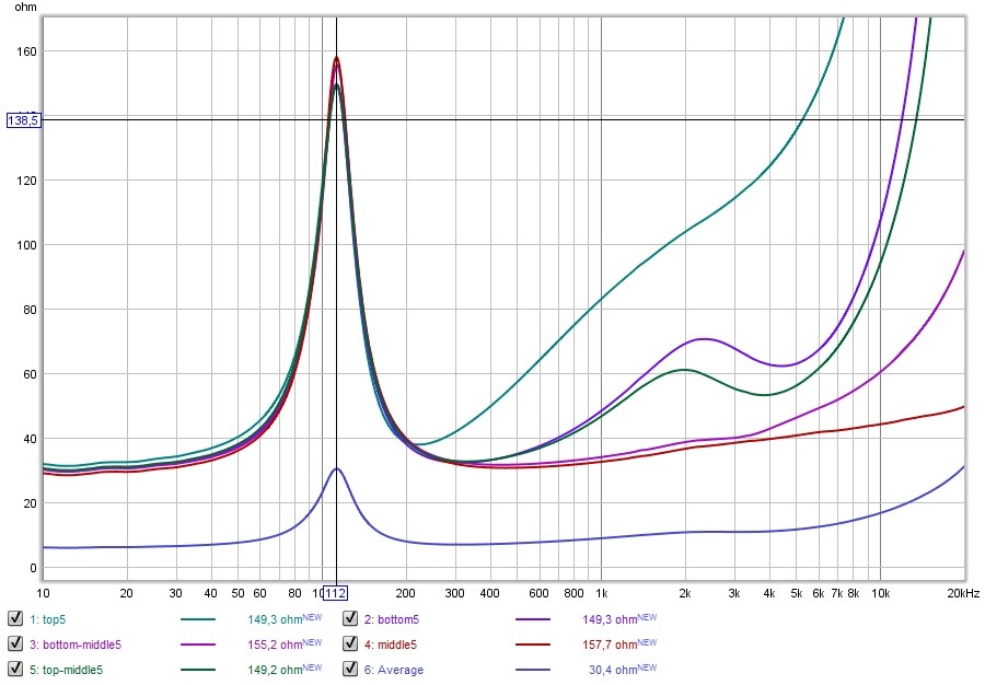

Here's a first attempt, showing all 5 groups and the resulting impedance:
As seen, the groups don't have an exact peak match up, as it's hard to line it up that way due to the added resistance of the added filters.
The peak values line up though, and if all goes well, the other array will be the same. I first divided all drivers into matched pairs,
upon which I started to group them by their peak Hz value. From there on I created groups of 5 to have the average line up at the
same frequency. I could try to get the peaks to match as well, but more importantly, I wanted to see what it did for power distribution

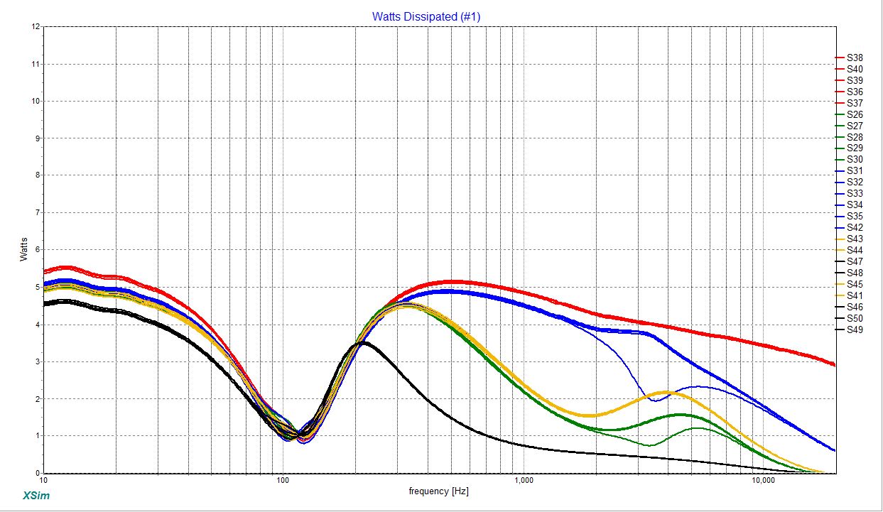

with the filters in-line:
Power distribution with 100 watt applied to the array (8 ohm load, 5 series, 5 x parallel).
Red is the middle unfiltered drivers.
Black is the top group of 5, that only helps out on the bottom end.
Blue is the group that is split above (2 drivers) and below (3 drivers) the middle unfiltered group.
The remaining groups are quite similar, 5 on bottom end, 5 drivers below the black top group and above the split group.
The single line deviations are the notch filters I added later on. (to make up for the split up of the blue group)
I think I can live with this arrangement. Provided the other array looks similar .

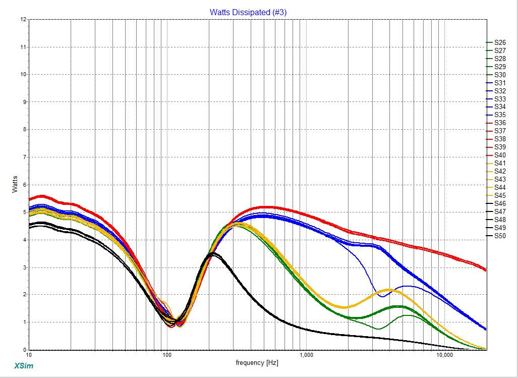

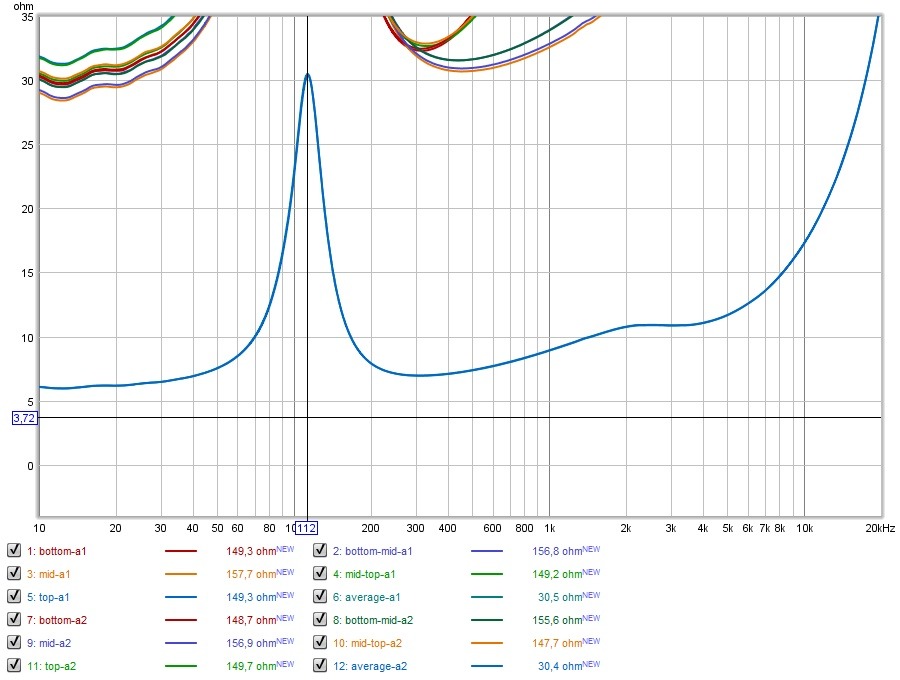

Second array added, I guess the trick worked to first make 2 near identical groups. You can't see much of a difference here.
Power distribution in these groups:
Small, very small differences. I might be able to adjust it just that little bit.
If not, I can be happy with this result though. Looks quite even.
Able to redo it quickly, all done. And saved both of the schematics with driver numbers corresponding to the impedance plots.

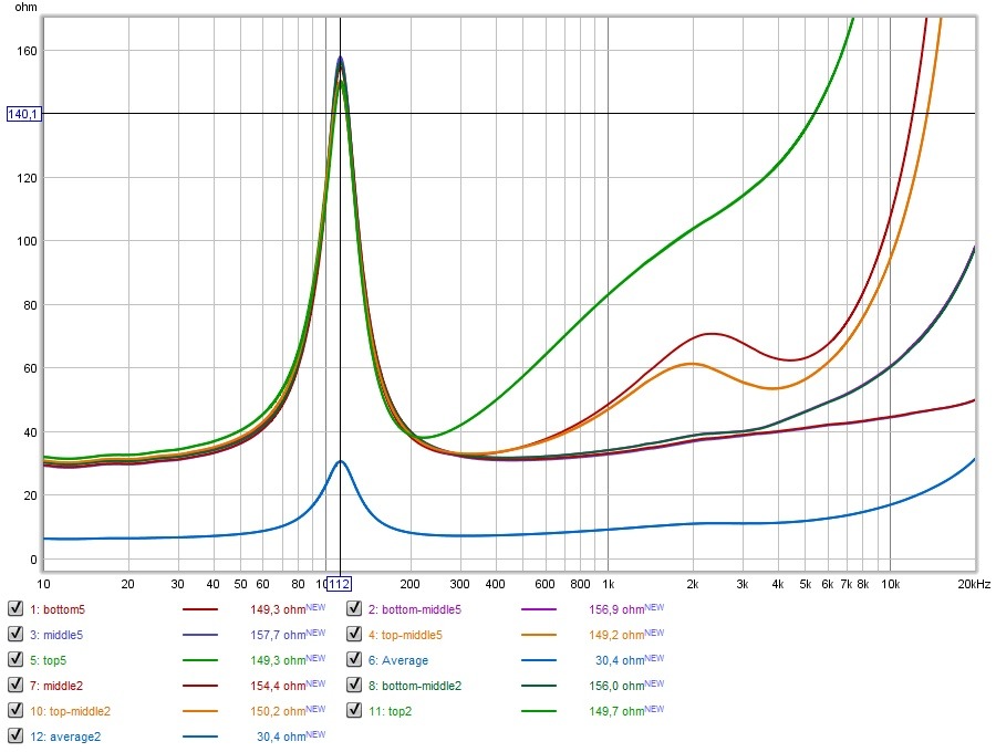

Nice job on the sortingImpedance of all groups and final curves of both arrays.
I tried a few different ways to sort the groups. As far as voltage or power distribution at the impedance peak goes, sorting them by impedance peak definitely had the best results.
That showed a very even distribution of energy at that point. However, the wattage used at the rest of the spectrum showed way larger differences. So in each group of 5 drivers, it looked like they did not (get to) use equal power, at least not as well as the prior way of grouping them.
I did tweak the results slightly to get each group as closely bundled as I could for power consumption over the widest area, while keeping an eye on the deviation at impedance peak.
