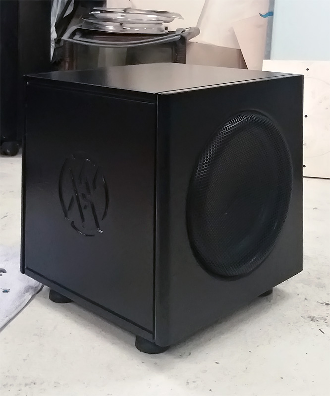

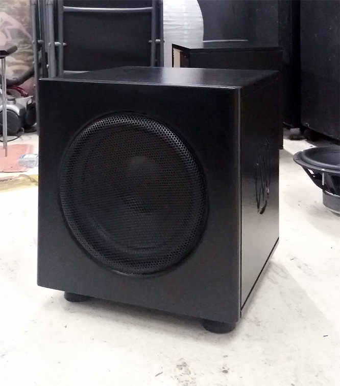

The protective screens are indeed about 289mm which means I need to cut into my fancy fresh layer of epoxy/boat paint ...
I wish I would have taken this "cat threat" more serious when I was still in the design phase. It has been on my mind, but why didn't I act on it sooner, oh well... off to the garage to see what i can do about it now.

Cat protector is on...
I had to cut a groove to fit it (original hole was 280mm, protector was ~290mm).
I used the router table and covered the surface of the table with a towel to protect the paint. Worked like a charm. I glued the protector in place (Bison Polymax, a rubbery glue) and also used small nails to make sure it will stay there. Space between dustcap and the grille is just over 25mm to cover x-mech (not x-max) distance. The screen is bent inwards in the middle, the surrounds have plenty of room to move.
Not as pretty as seeing the naked driver but it will do. This Rockford Fosgate protection screen was the most open screen I could find.
