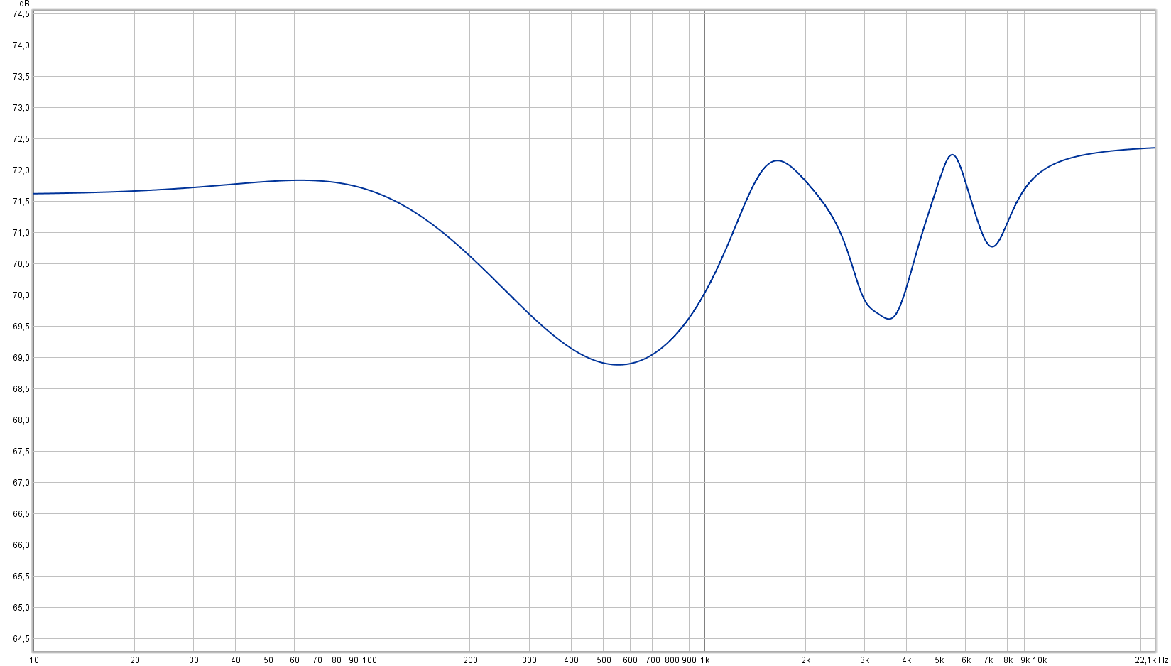

First things first, a comparison of a Dirac pulse in, mid or side out.
Beware of the SPL scale here. 0.5 dB divisions. No boost on mid or side was used.
Another side note: the target used with this mid/side combo is not a flat or slowly declining target. It is a mixed target that does not follow a straight line at all. So don't be thrown off by the dip at high frequencies here.
This was typing all gain and Q settings into Fabfilter like I had them in my old EQ. I suspected to see differences in Q and the way shelf filters would work. The plots show there's truth in that. This still does not account for all the differences I heard though. So I'll need to dig in deeper, which isn't going to be as easy.
I'm hoping BYRTT tries the 64 bit JRiver. Somehow the sound I heard was not as 'sweet' as I was used to. Which could very well be a difference in Asio drivers 32 and 64 bit etc. I will revisit this test after a few releases though.
It isn't the first time I don't like every JRiver update immediately. Usually BYRTT and I are on the same page with that :). It could very well be something on my side, something in my settings. Buffer setting are all the same though.
I'll go on with looking for timing differences between main and ambience channels, as that could be another variable. The JRiver 23 powered ambient channels had more hiss (noise floor) than JRiver 22. That's something weird I cannot explain.
All spectrogram plots look identical, all plots have flawless flat phase.

Yes, I have it set to Maximum as latency isn't an issue. The phase of both corrections is flawless, I guess the differences are a Q interpretation difference. I'll try and find the closest match and try again.
The ambient channels had a very similar delay, no problem there. However I did use an allpass filter in JR22 that's not available within FabFilter (as far as I know). There are differences in the way the ambience processing looks, more bottom end on the JR23 while all settings appear to be the same within JR. That's another puzzle right there.
Hope you can give me some impressions BYRTT. We've always been on the same page with this kind of stuff. Would be good to know if it is JR or a driver difference I'm hearing. I'm hoping to get the 64 bit chain up to speed.

How did you get the mid side responses separately out of Fabfilter?
By switching the mid-side EQ around. As I play a stereo Dirac file all we are going to see the part in the IR that is the same (phantom center). With both pulses identical that means the complete output will represent the phantom part. Same goes for an REW sweep. Feeding it a left only or a right only pulse would work too I guess.
With Voxengo I just cross the left and right outputs after encoding and before decoding, in FabFilter I have to switch the EQ around.
639244d1507471550-towers-25-driver-range-line-array-2000-png
Looks like this EQ is using the same Q values as my EQ plugin. I can see the intended knee at 3400 Hz which also shows up in my graphs.
The parts that are a little more "hot" in the mid compared to the sides are intentional. At ~1750, 5200 and above 8 kHz.

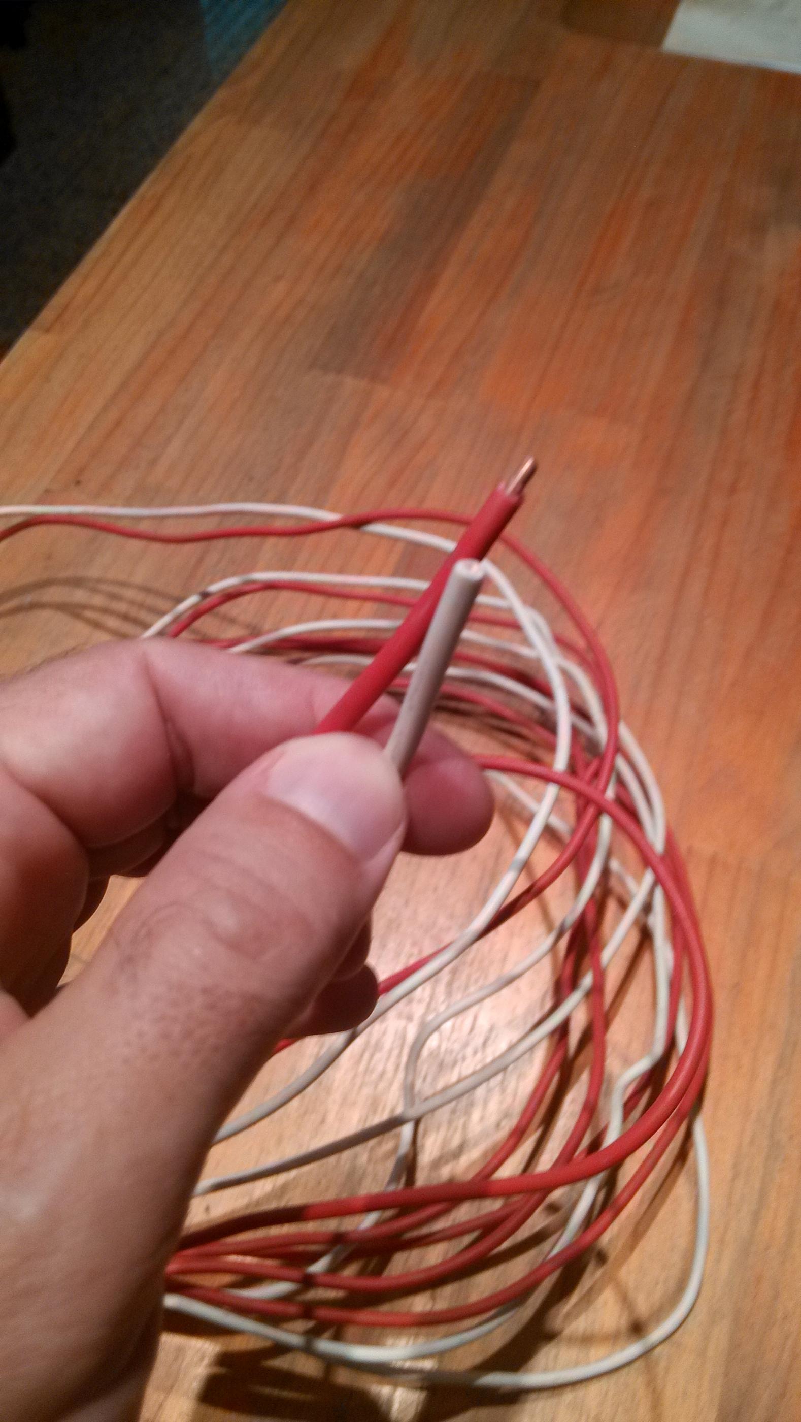

Not wanted to derail from your current direction with 64-bit stuff and ambient channels, but...
A while back, you guys were talking about wires. Got me thinking, and finally re-wred my OB setup.
Previously, I was using cheaper multistrand copper "speaker" wire bought in bulk. I had thought it was good enough.
After reading about your tests with wires, I decided to try solid copper wire.
First things first... it is a pain to work with! I have to bend them into shape, and I have 2 pairs running around... a bit of a challenge.
But, as I did one speaker at a time to compare... the effect is VERY noticeable.
The multistrand wire sounded darker, and the solid wire opened the sound, but a very noticeable margin. I got "air" that was never there before, and things like cymbals just expanded.
So, thanks! I know what I'm going to use in the future from now on. I'll relegate that multistrand wire to LED wiring! :)
I didn't want to skip this discussion, glad you got a better result. You should be able to measure it :).
I agree the solid core is a pain to deal with. I opted for the next best thing, in measurements there wasn't a noticeable difference between the solid stranded wire and my house hold electrical solid copper wire.
The only way for me to try silver if I get sponsors :D.
