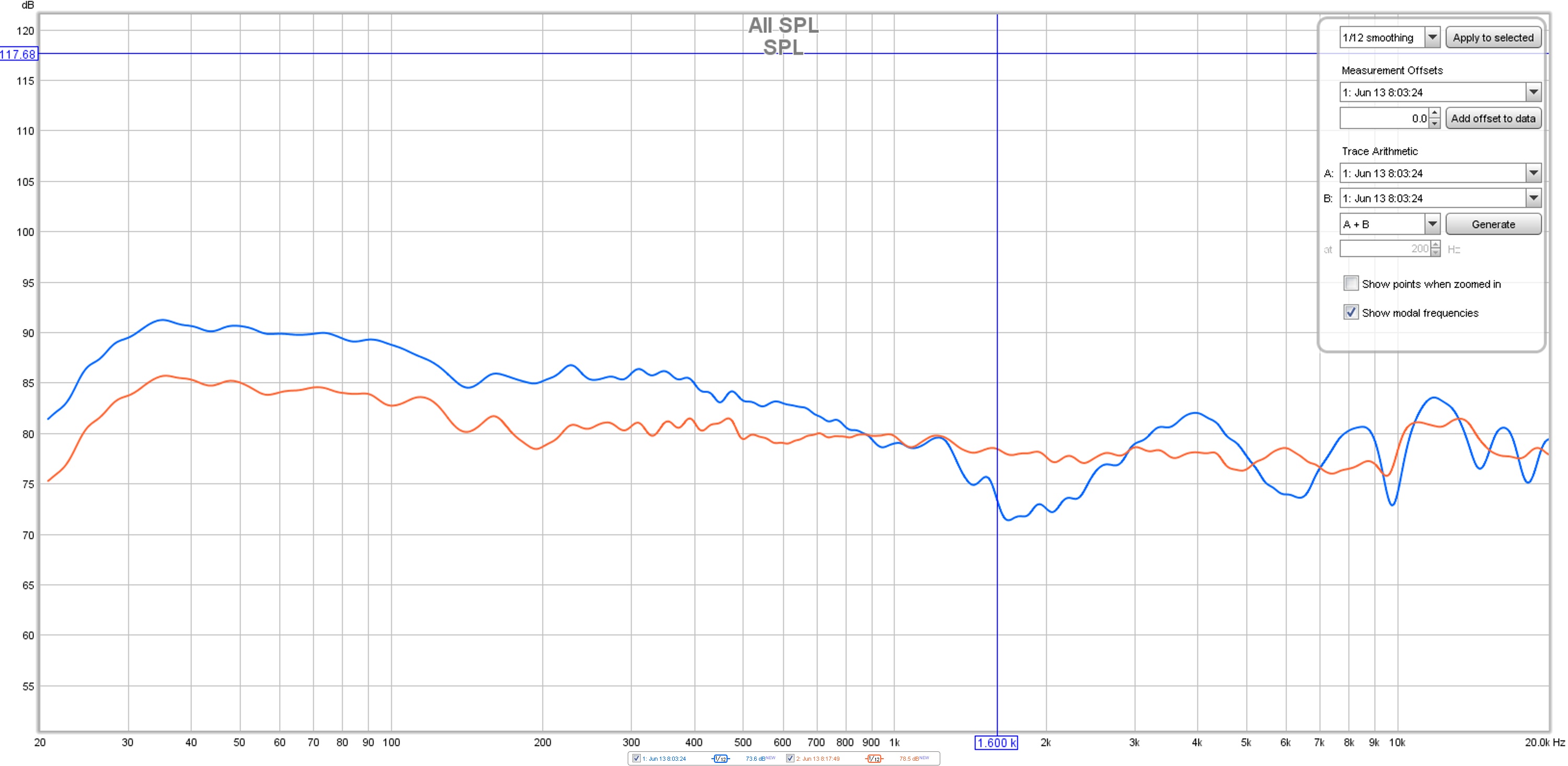

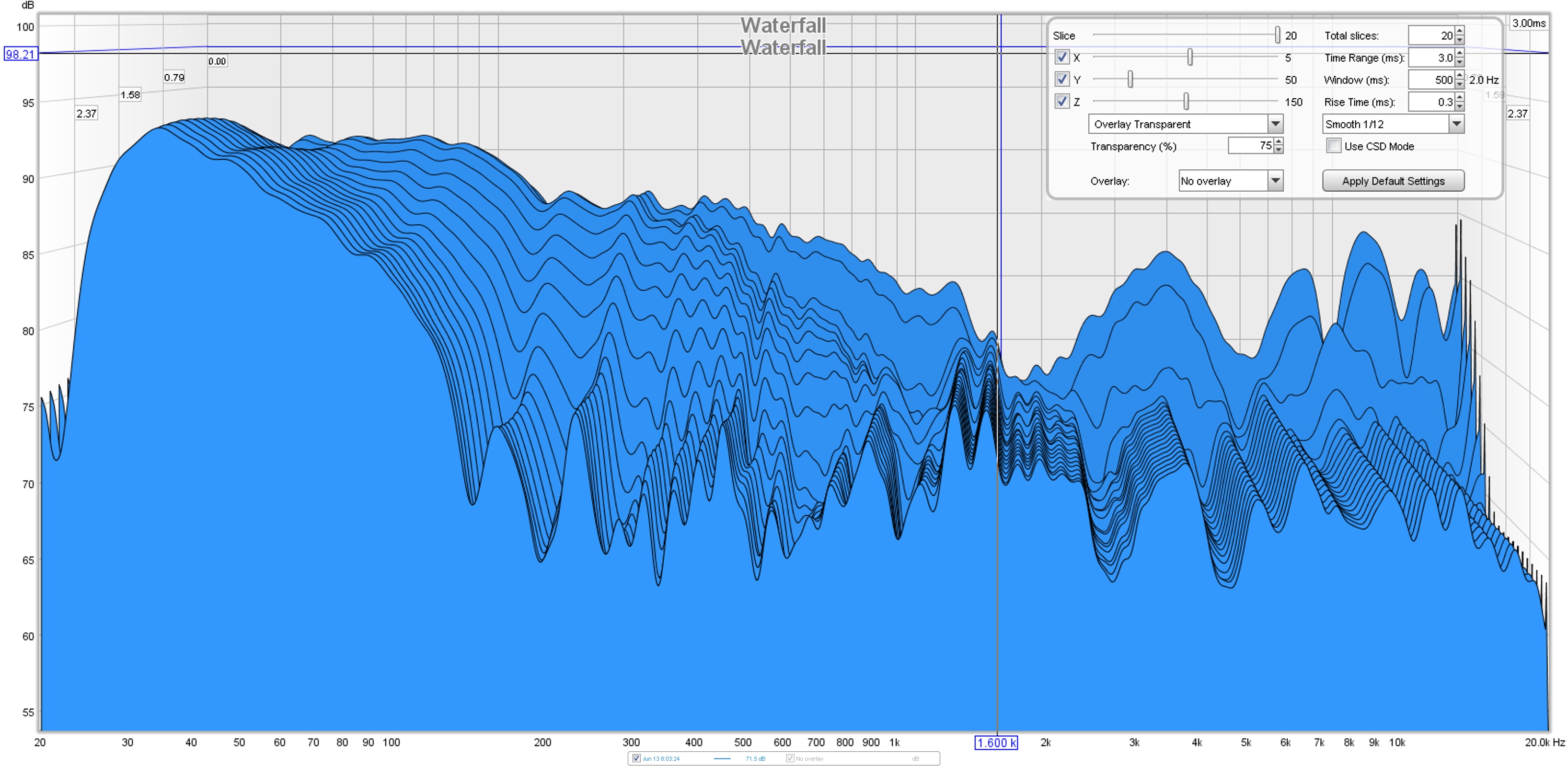

Thanks for taking the time to do those measurements. It becomes pretty clear that any resemblance to my theoretical plots isn't coincidence.
I like your measurement even better than the ones I've seen from Toole. They clearly show the truth of what's happening at the ears. And are a testament of how well adapted our brain is to make something out of that, somthing that still makes sense to us!
One more question, how accurate is that mic position at the left ear and the size of dummy head? I could probably "tune" something for your setup to pré convolve some test tracks for you to listen too. If anyone has the room for it to hear a difference, you have.
Not that accurate. I actually redid the measurement more accurately after my initial post, but didnt share it as to not clutter the thread. The general tendency was there in the first measurement.
I also am not sure if a compressed pink fluffy dummy head adds or subtracts from what is really going on.
Let me think about this a little more now that I am confident I understand the issue better.
