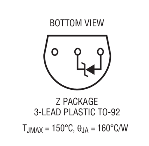

There are 2 long tracks running from the rails via 2x Rs to the opamp.
You just need to cut them halfway, and solder 2x LM329 in between to drop 7V.
If you want another 2V drop, then solder another red LED (HLNP6000) in series.
They are both very low noise, so no need for extra caps.
Patrick
LM329 is a precision Zener with 7V
Reactions: 1 user
TO-92 case, 3 pin , one not used
