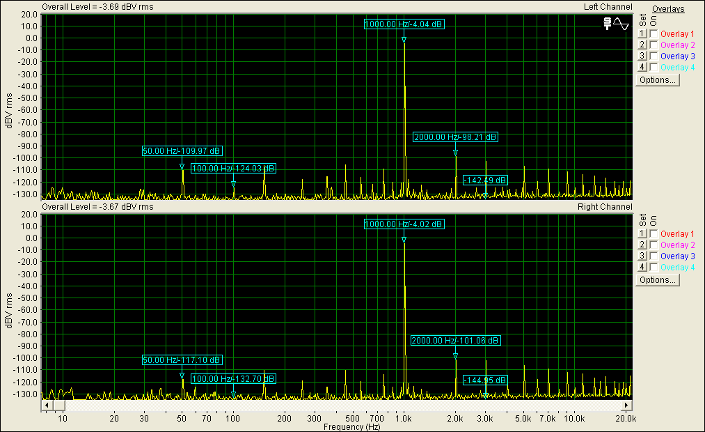

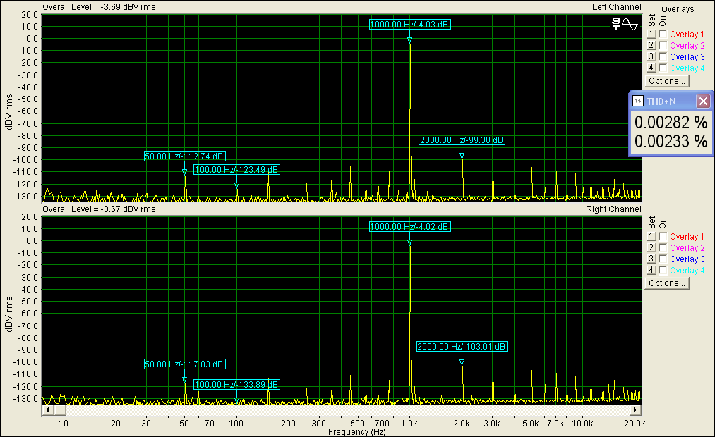

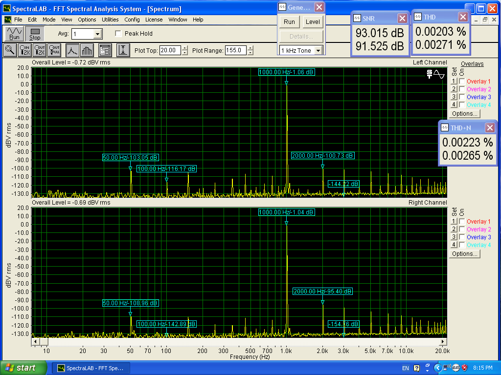

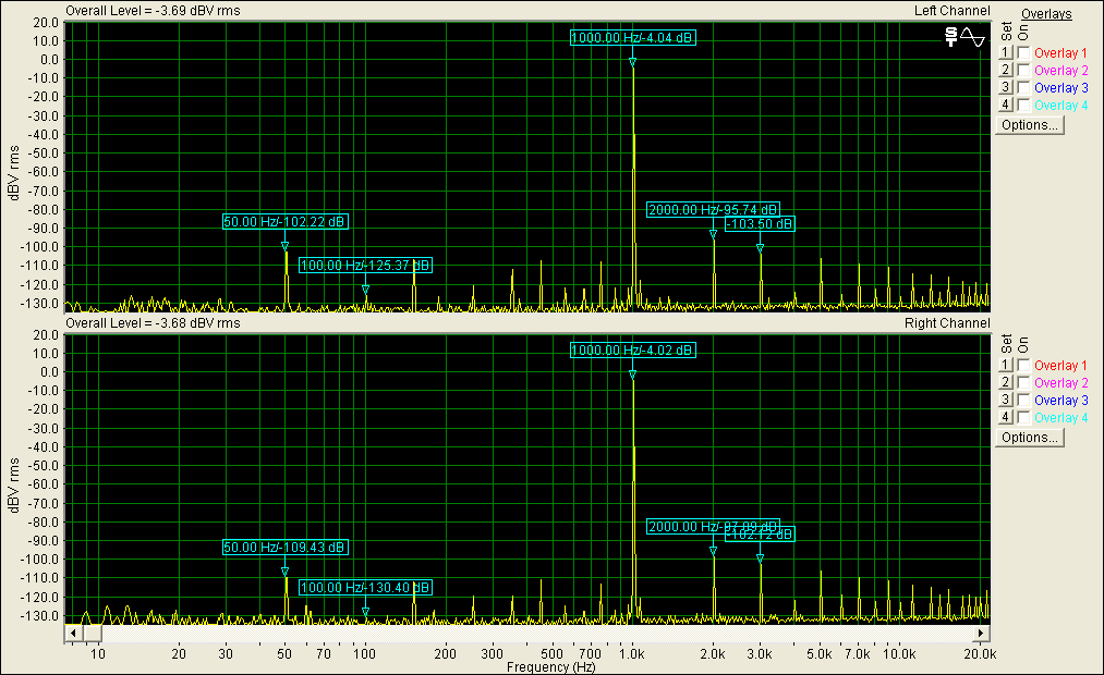

testing Kuarlotron in stereo configuration
here is the stereo version +/-10V
