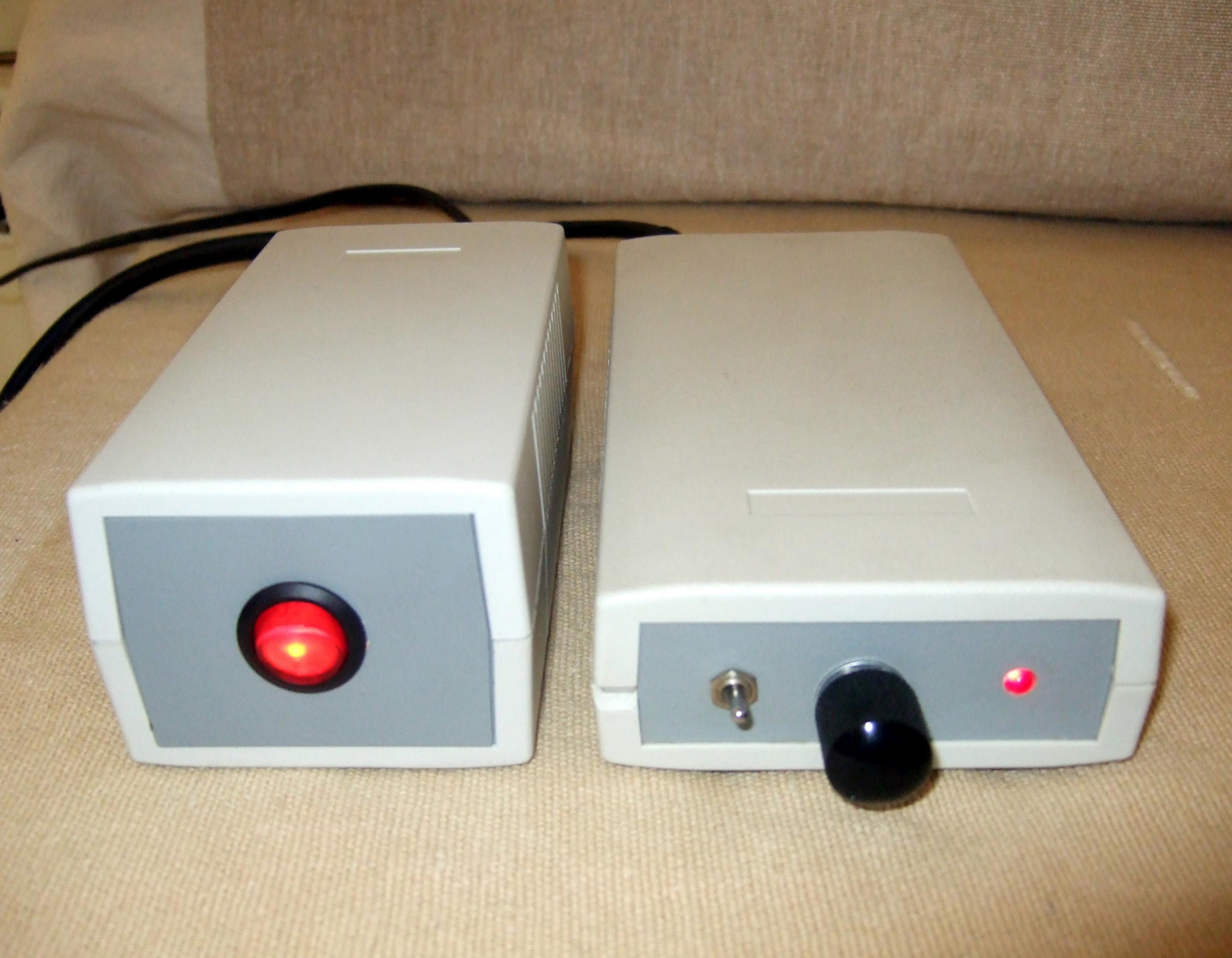

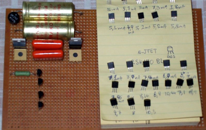

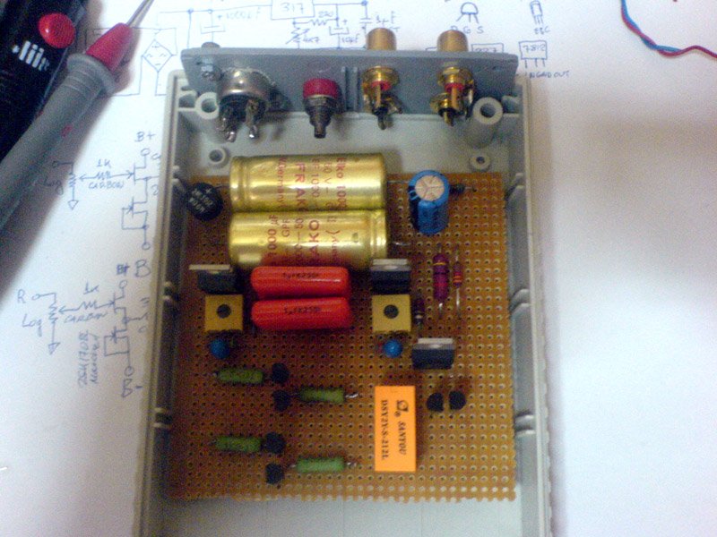

Just for the record, DCB1 was born as a personal project idea in 2008 during a why not DC path argument I put in the Pass B1 thread. Off I went to make a perfboard prototype with LM317-337 to test offset and general behavior. I even tested various rail voltages, pot types and values, it also included the output relay circuit. I was happy with the outcome. All that was done "live".
Jean-Paul spotted the DCB1 idea potential and even pushed by opening a thread for it so to call people's attention to that circuit. I shortly came up with a package design that included dedicated LED ref shunt regs so to try extract even more quality. A couple home etch attempts from members gave positive feedback to the design as a whole.
Then some people wanted to can build an official & finished one. I looked into it even further asking people if they wanted input switching, delay relay etc. Half said yes, half said no, so two versions I decided. One fully equipped and one single input.
First GB attempt was postponed after a volunteer to do the Eagle layout under my guide and then undertake the PCBs distribution left the scene. When the layout was ready and we showed the sketches he got apparently scared by the sheer number of interest that built up fast and went missing in action.
Disappointment lasted a while among the people until two "heroes" came forth on their own initiative to volunteer save the attempt. Namely CRT to do the CAD all over again and Tea-Bag to do the distribution. The weird z spelled names Hypnotize and Mezmerize came from album names of CRT's favorite band SOAD. Rest is history.:)
