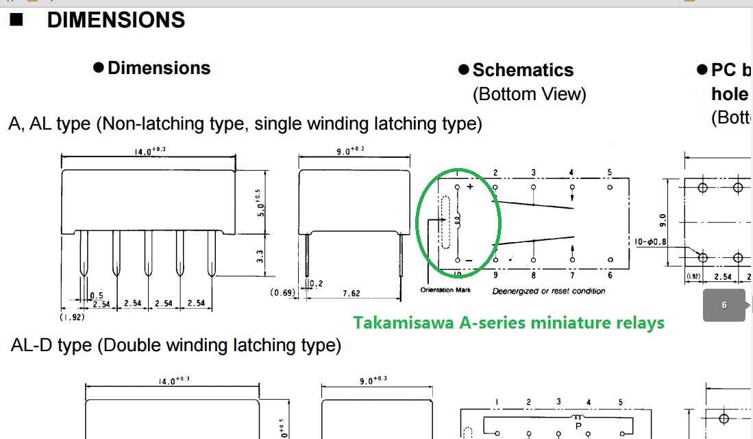

Does anyone see a problem with using the relays like this, to save space on the board?
Looks good to me in general.
Some minor details perhaps could be put into consideration when carrying out the real layout design:
1) miniature relays such as Fujitsu Takamisawa A-series have "helper" permanent magnet in them, and require power to be applied to coil in correct polarity, pin 1 of the relay must be at positive potential (picture attached). Otherwise the relay wont fire despite sufficient current in the coil. Your layout is correct if it is top view shown.
2) If layout is to be made Fujitsu miniature relay compatible, the common positive supply to the coils may have to run on the bottom side of the PCB, As the small relay does not have a skipped pin space between the coil pins and the signal pins.

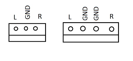

4) Is a 4-conductor input signal connector for each relay more suitable, so that L and R signals can have their individual return/shield back to the RCA jacks? I usually use RG174 to wire off the RCAs, so a 4-pin connector will help in my case.

1: I defaulted to Panasonic AGN. Those Fujitsu relays have still yet another layout than the Panasonic AGN. Maybe it is possible to support them with some trickyness.
2: Maybe not, it depends on whether there is any danger running 12mA through a 10mil or so trace. I doubt it.

4: Ground switching opens a path large for RF ground noises through crosstalk because the grounds are free to radiate noise into other signal lines statically. This is something that could make the relay spacing matter, as well as take up too much space on the board.

AGNs have 2.2mm pin spacing, even smaller than Fujitsu miniature type, perhaps similar to its ultra miniature lines. Anyways I'll take whatever relays you decide to use
A 10-mil trace can pass a lot of current without cooking, This calculator indicates 10-mil 1-oz surface layer trace can do 440mA at 2C rise over 25C ambien with drop of 21mV/in.

Never meant to have ground switched, just one more hole on ground per each stereo channel so that the braid lead of left and right cables coming off the pair of RCA jacks don't have to share a same ground hole.
Yes, that's better.
How much better really? I don't see a point, all grounds must be tied at some point so it will have little effect on the actual noise level.
Users would have to crimp on new connectors, the aim was to have a drop-in replacement. If I'm going to make "improvements" to the original layout, the reason should be compelling.

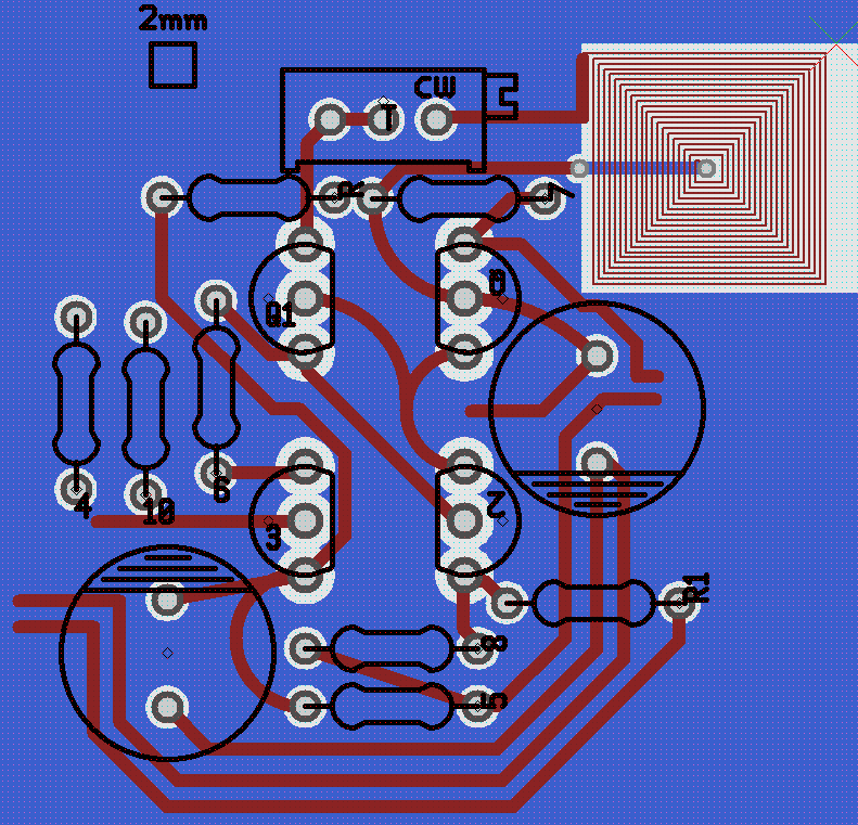

Nice DIY pcb!Hello everyone!
My two cards are completed and just have to make the settings and proceed to testing. They will be positioned one over the other.
Regard's!
Waiting for your test
I have made the settings with a voltage +/-10V (my Borbely - Sulzer) and exactly 5V on TP. The offset voltage output ranges from 0.00 to 0.03 (200mV position on my multimeter) on both cards.

A four-pin connector would make no difference electrically but seems a lot easier for wire crimping as one doesn't have to crimp shield braid ends of two wires onto one terminal of the connector. I don't have a DCB1 buffer and will try to find out how they do it.

Too bad, it's the only way to have entirely equal fields that I've come up with thus far... I plan to use SEPF caps for this however. Same lead spacing etc.
No reply from Joachim yet. Perhaps you should ask him about bypass caps? He might not pass up a contact from you Keantoken.
