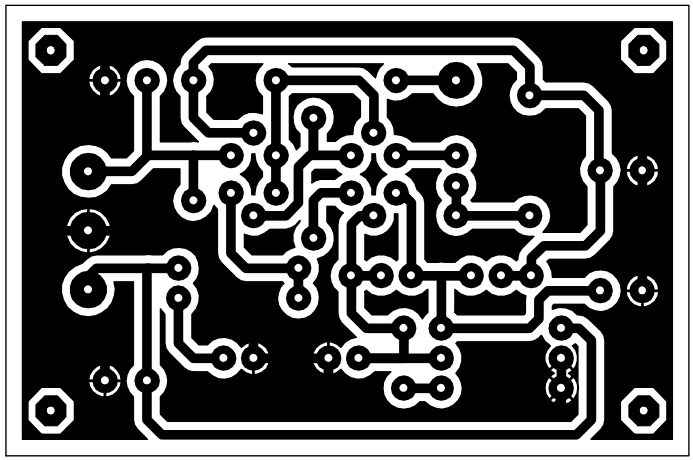

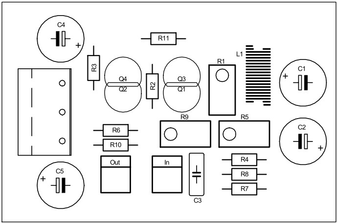

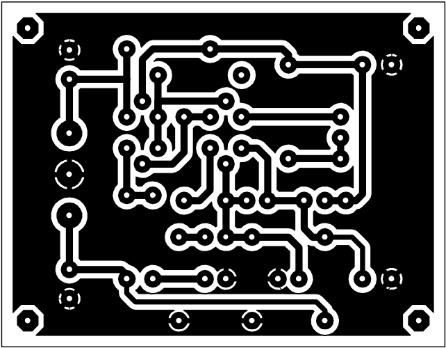

I plan to achieve "Kuartlotron" and for the occasion I drew a small circuit board (not verified).
What is your view on this track?
A quality power supply is needed?
Power supply +/-10V is necessary or +/-15V possible?
Thank you!

I like that one. To reduce the field of some of the traces I would add a ground plane connected to nothing but power ground. Or just cover the bottom in aluminum foil with a sheet of paper in between, if the board has to be single-sided.
+-15V is possible but may not sound right and have higher distortion.
The TL431 used as a shunt regulator is sufficient to meet the needs of the Kuartlotron.
Perhaps a simple link from the power supply input terminal block to the midpoint of the C1, C2 ground connection, straight down the centre of the board beside R5, R9 - this gets rid of the long 'ground return' track around the outside past C4
If you don't mind re-arranging the board a bit, move the TP to next to the R3 position and reconnect R11 above Q3, as this allows room to move the L1 up to below the top track where the TP donut was, move R1 below it ( horizontal) and this opens up the corner to move R5 up where R1 used to be - a bit shorter tracking - not sure if much benefit as this is power supply
(could also move R3 to horizontally above Q4 but a bit of a squeeze with new TP)
Another not so easy one would be to move R4 to between R9 and the 'IN' terminal & C3 - in fact, could nearly swap positions of 'IN' terminal and the R7 & R8 - this would simplify ground return loops
I think 'sikahr' focused more on the ground tracking rather than your more dense component layout - be interesting to see if there's a difference in the 'sound' of the different layouts - what are the measurements?

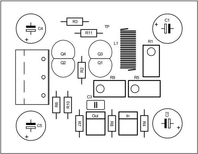

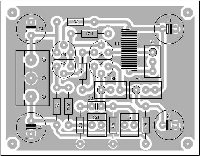

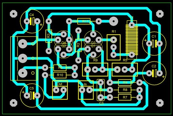

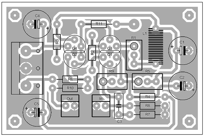

I modified my circuit but it is very hard to beat for me while maintaining a very compact size and one side.
The possibility of double-sided with a ground plane is also a solution with this drawing.
Thank you!

Project16, your ground layout is now causing ground noise because of the voltage gradient through the plane between ground points caused by capacitor currents. This is why I described a second layer ground plane connected to nothing but power ground (the single power ground connector, and nothing else). It would be better to keep the original ground scheme, separate from the ground fill, which again is connected to only a single point.

As 'kt' said in post #234, and if I've got this right myself -
There are the 4 capacitors ('-ve/+ve) to the central 0 volt point on the 3 pin terminal block via this ground plane (I don't like ground plane power supply return paths, myself, but ..) and then there's a separate track to this same pin from the group of R7, R8 and the IN and OUT terminals - even in this simple ground scheme, these some design considerations!
Now, as this central ground goes to the central 0 volt point of the power supply and usually continues out to the transformer, does this get connected to chassis earth point directly, or via a 'floating resistor' for a 'ground loop breaker', and where is it attached - remember, the IN & OUT ground terminals are also connected to the signal IC shield mesh and directly to the associated 'stages'
A question - If the continuous ground plane is used, should it continue above/below the planar inductor, or avoid this area?
New territory for me, and it doesn't appear to be at all significant in this circuit and more of a design question, but does any 'noise' from the power supply, or the IC shields (if you use them) get transferred to the ground plane and back into the active circuit this way and do high frequency rules, etc, still apply here ?
It would be a good thing if the plane shorts out the portion of the inductor's field that passes through other components. This way there is less interaction with potentially nonlinear magnetic materials like leads, screws, etc. Better yet, put the inductor on the opposite side of the ground plane to the components so the plane is between them. I don't think the bulk of the magnetic field will pass through the plane so I don't think there will be a problem with the inductance changing.
