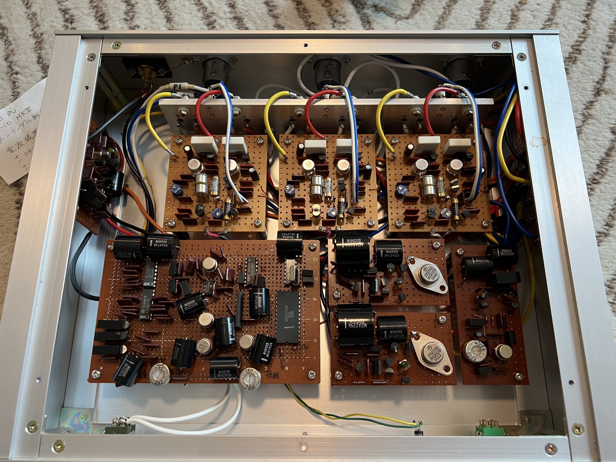

That’s just the PSU - you need the board inside the MK2A chassis. Remember on the MK3 the external box is not just the PSU but the entirety of control. There’s nothing inside the motor chassis except a breakout board with a few transistor and diode on it for the brakes and strobe and buttons.

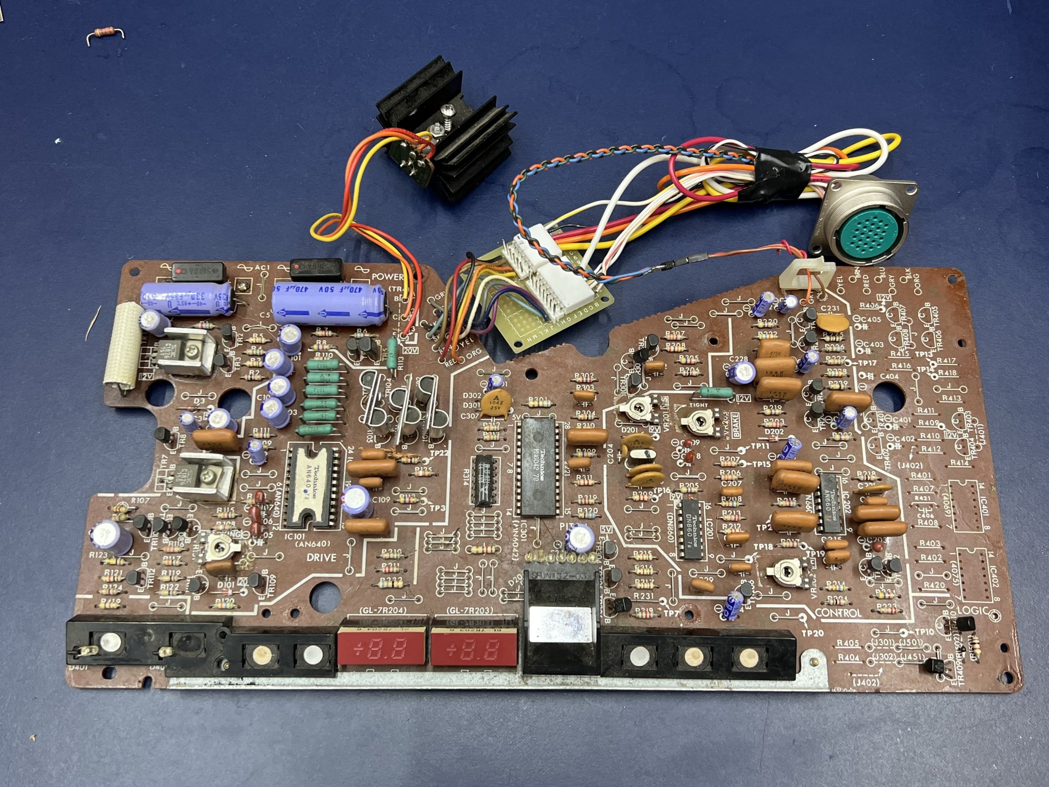

That makes sense, thanks. Obviously I haven't studied the schematic in any detail yet. So I'd like to find a parts only Mk2A if possible (or SL1300/1400/1500). Would I be able to use the board from one of those donors or would they just supply the ICs? Certainly the SL1300, etc. would be less expensive than SP-10Mk2A.
This is that SL board wired to connect to a MK3 motor.
Joined 2014
This photo is very helpful. Does it have the improved output stage needed to avoid hand-starting? This is very encouraging - so I will purchase the Mk3 if still available. Do you have any interest in selling the board in that photo? I assume it would benefit from you MN6042 replacement.
No, this is just the stock board with the mating connector for the MK3 motor attached - https://www.mouser.com/ProductDetail/656-SRCN2A2524S.
SL-1300/1400/1500MK2 (SL) uses one 20V rail for the motor, so it's driven with a virtual center for +/-10V approximately. SP-10MK2A (MK2A) does a bit better with a 32V supply, but is still virtual center so +/-15V. On the MK2A there are level-shifters on the P side. The MK3 has +/-32V supplies so the motor drive is +/-32V - double what the MK2A will swing. Of course levels-shifters for both P and N on that one.
The other benefit of the MK2A is that it has all the same adjustments as the MK3, while the SL platform doesn't. The if the MK2A isn't strong enough to command the motor for your situation then I'd look at replicating the MK3 output stage on a breadboard and integrating it on to the MK2A board, but it may just be good enough "out of the box".
The SL platforms aren't known for having MN6042 issues - only the SP-15 and MK3. It was hypothesized that the issues are due to poor or no gate protection on an early MOS design. That could very well be as I think the largest practical difference between the platforms is environmental - people don't tend to use the ground lug on the motor chassis for the SP-15 or MK3, whereas on the SL's it's connected to the arm/phono ground internally.
