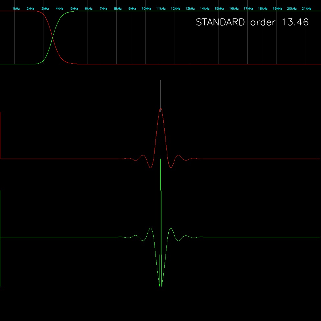

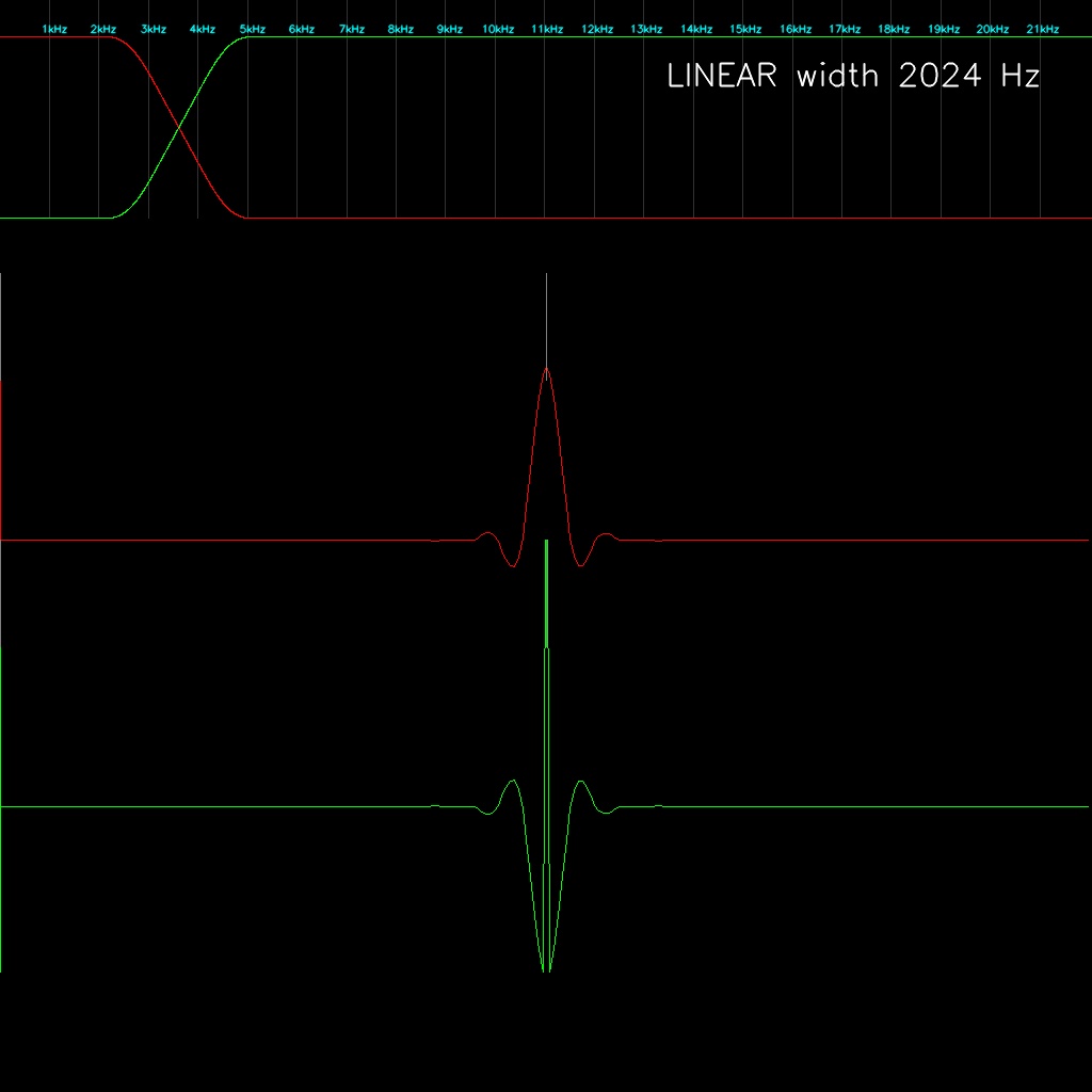

I haven't got round to anything more advanced yet, but I did try simply reducing the width of the raised cosine window that I multiply the impulse response with. This does, in fact, result in the rounding off of the corners of the linear crossover. Presumably, the ultra-sharpness of the corners was possible because of the low amplitude, but extended, ringing on either side of the central impulse which is now gone. I enclose a screenshot of the new rounded linear crossover, plus a 'standard' filter with a similar level of suppression of the frequencies at the edge of the crossover region. I'm thinking that the rounded linear crossover is a pretty good compromise.
A bit light on details, I know, but I'll endeavour to pull it all together with better on-screen stats and those log scales!

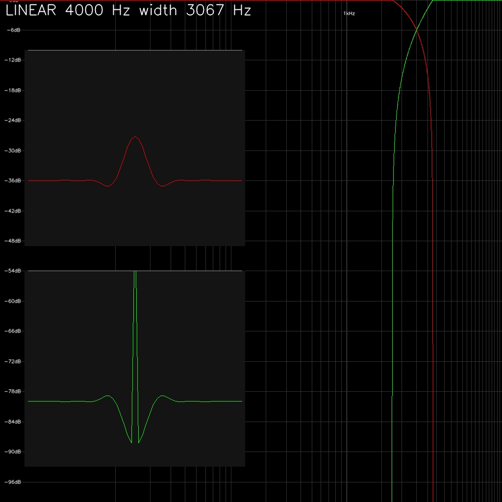

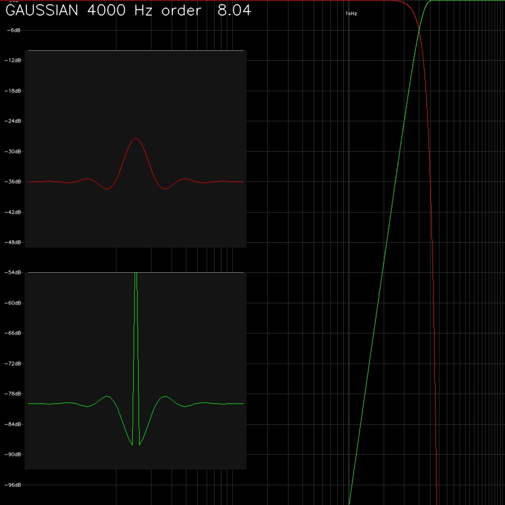

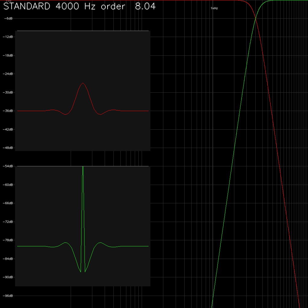

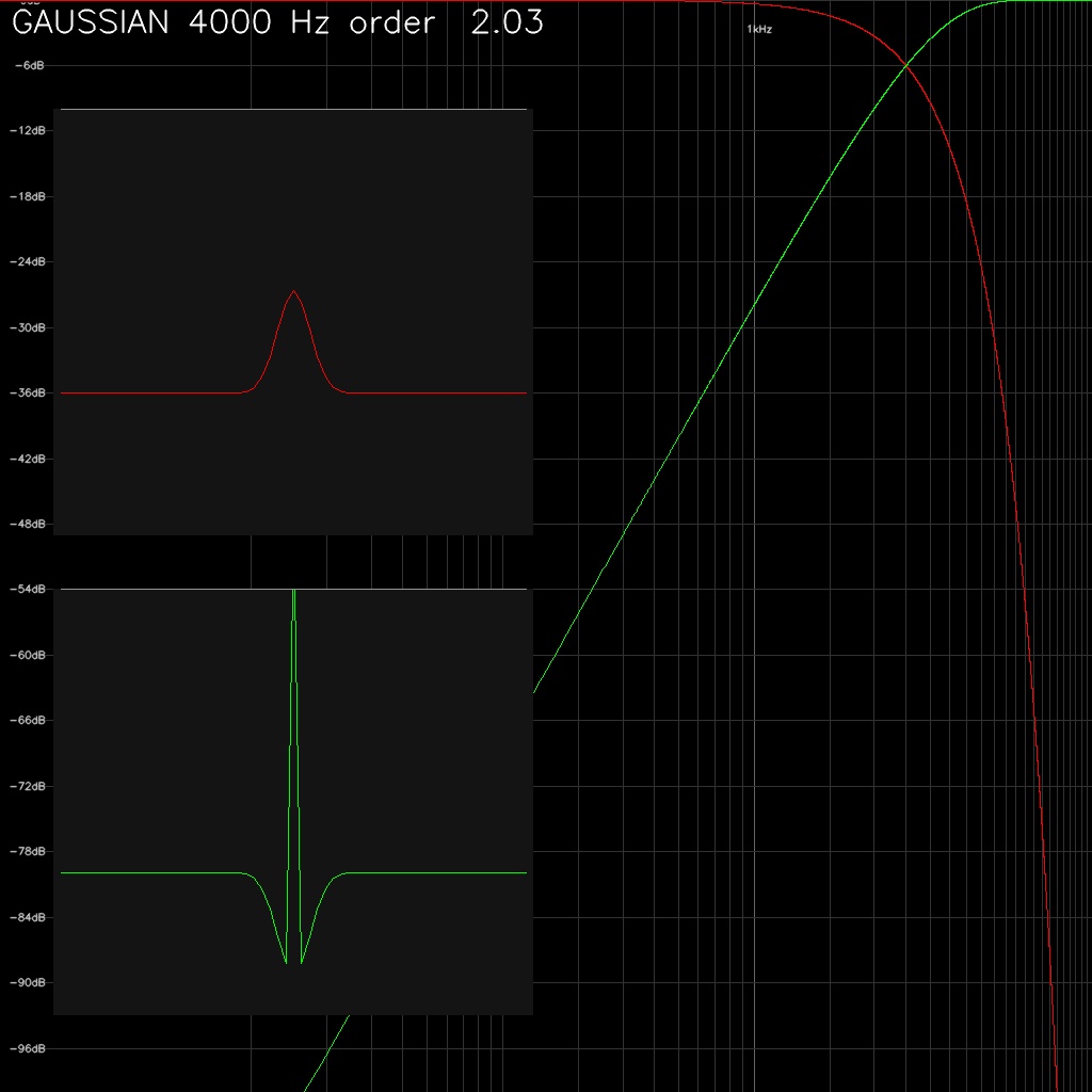

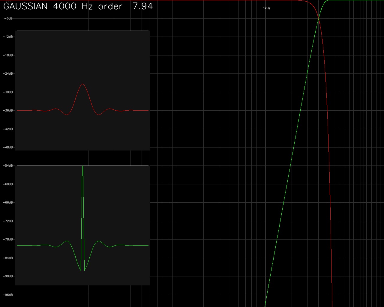

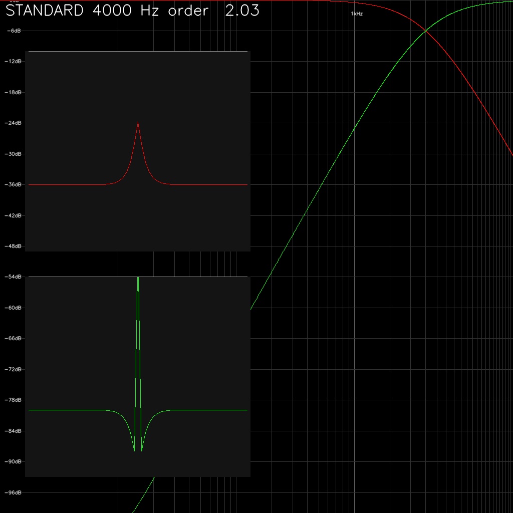

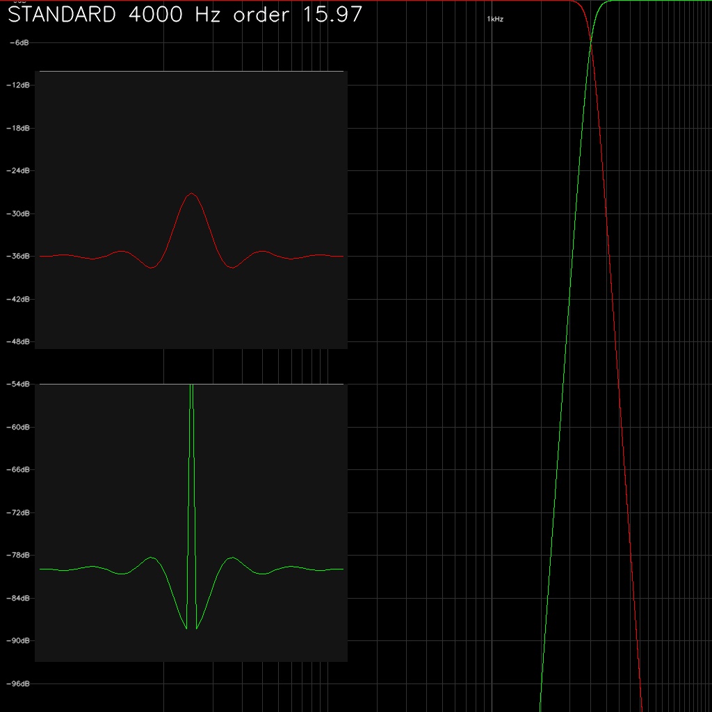

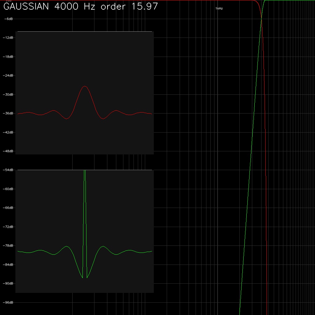

Finally some plots with log/log scales. (More prettifying to do yet, though)
The 'standard' crossovers are as the formula mentioned previously (Q = 0.5).
The Gaussian is as per the formula you supplied a few pages ago.
The experimental linear crossover is shown with a wide window i.e. sharp corners on the lin/lin plot.
I can switch/sweep between shapes, cutoff frequency, order and window width in real time while listening to the result.

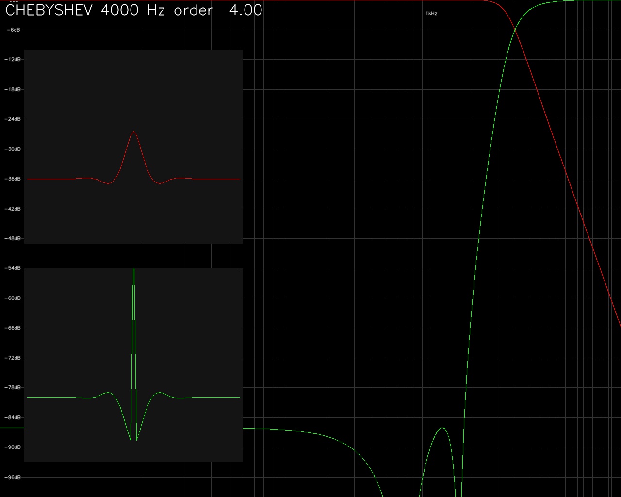

I think we're on the same wavelength, so to speak. I enclose a screenshot of another filter type I've included: the Chebyshev* (but it's not obvious I've gained much by it, in terms of selectivity vs. ripple and overshoot).
Chebyshev filter - Wikipedia, the free encyclopedia
Steph, a while ago you were talking about numerical methods for optimising the filter. Could you just go over how you envisage that working? I think you were talking about starting with a basic prototype impulse response, and adjusting a window to influence its ripple and the resulting frequency response for optimum measurements.
*Ripple factor in this case 0.01
cutoff frequency is not the usual definition, which complicates things a bit

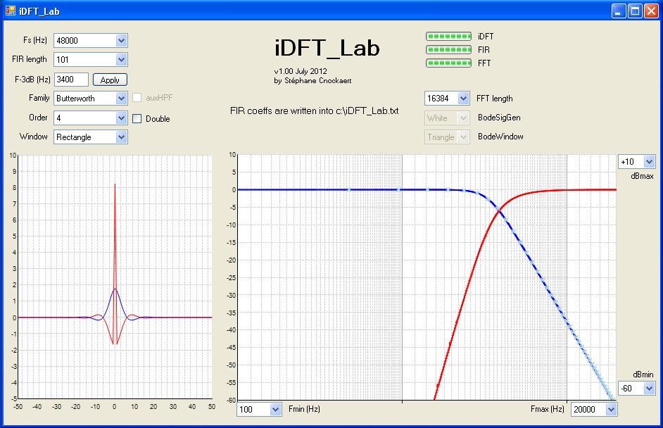

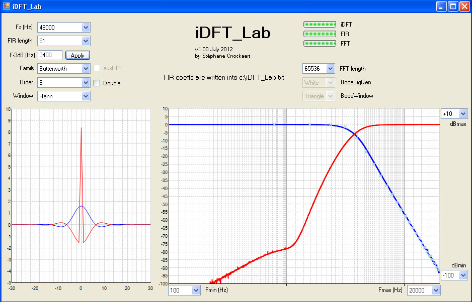

Yes that's why I did FIR_Lab, as a starting point, to open my eyes.
Afterwards I did iDFT_Lab. Using iDFT_Lab I realized there are many degrees of freedom, especially when you can arbitrary define the lowpass sharpness (Brickwall - Asymptot - Butterworth - Bessel) and lowpass slope (equivalent from 1st order to 6th order). You can consider "my" Asymptot as "your" Cheybychev. This is the advantage of the iDFT approach, cleaner than Cheybychev.
A nice generalization would be to define a "sharpness" parameter that's continuously variable, allowing to go from Asymptot (max. sharpness) to Bessel (min. sharpness), as target lowpass. Then introduce the "equivalent order" for defining the slope. Any idea welcome.
As usual there is no free lunch. The sharper the transition band, the longer and more intense preshoot and ringing. I have included the "double" option for emulating all Linkwitz-Riley amplitude behaviors, when selecting the Butterworth sharpness.
Very important is to keep an eye on the complementary highpass slope. Due to the fact that a Bessel lowpass is close to Gaussian (especially high order Bessel), we see that all complementary highpass built from a Bessel lowpass are only 2nd order. Which is insufficient in most practical cases.
I tried refining iDFT-Lab, adding an auxiliary highpass on the higpass (needed when the highpass slope is only 2nd-order), but that's far from easy when asking for a pure LPF + HPF reconstruction. What you take out from the highpass, you need to give it back through the lowpass. This implies a second DFT + iDFT stage. Such feature is not yet enabled in iDFT_Lab.

I'm attaching as .zip the various tools I have developed. They are quite handy, enabling to taste the digital reality, intuitively.
  • iDFT_Lab.zip
  • FIR_Lab.zip
  • IIR_Lab_mini.zip
  • IIR_Lab.zip

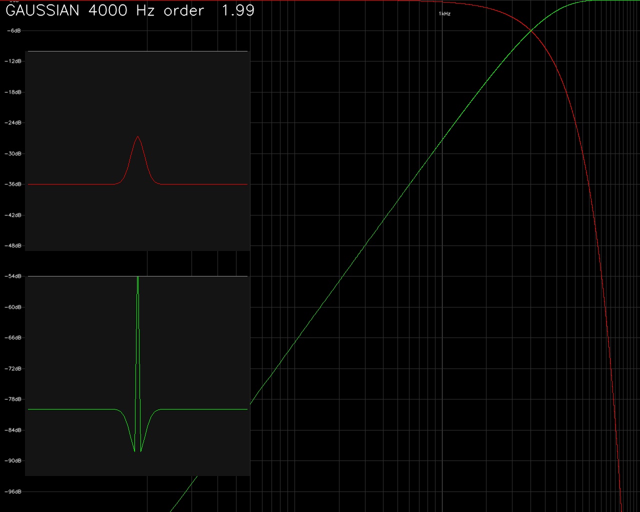

Could you explain this further? I think I am misunderstanding what you mean, here. If I plot a 2nd order Gaussian, and an 8th order (using gberchin's formula from a few pages back), I seem to get the 'correct' slope on the highpass.

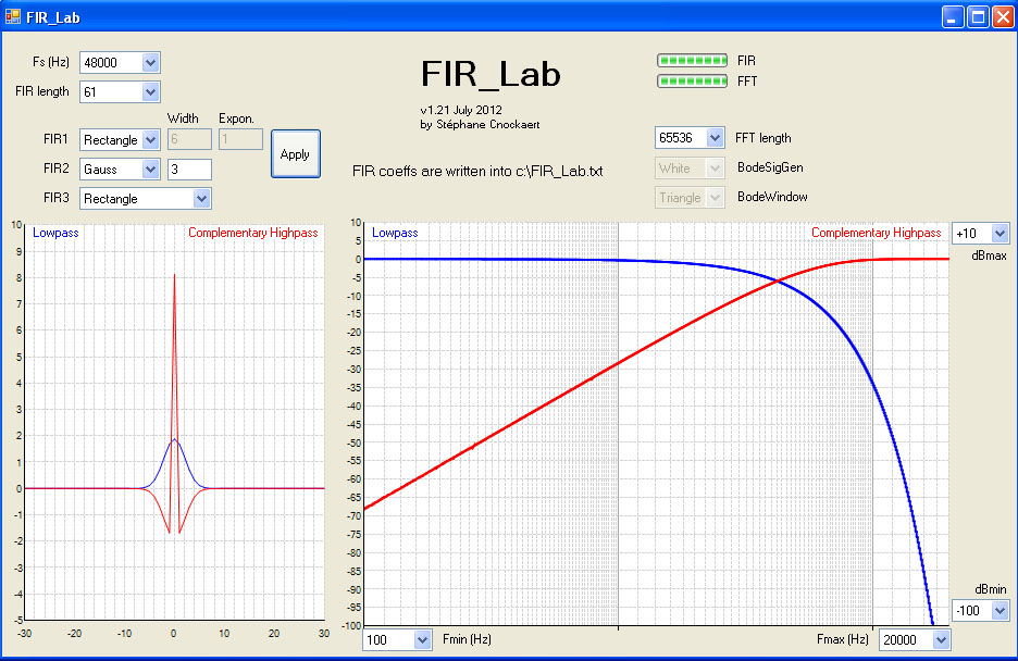

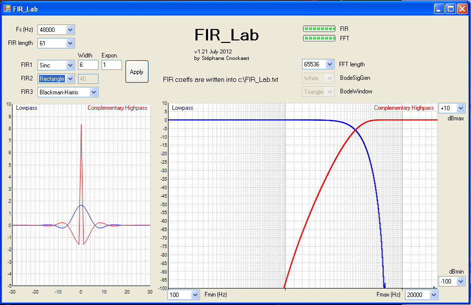

Today I have no time to scan the entire thread. I vaguely remember that Berchin wrote that one must remain cautious about the wording. I vaguely remember Berchin wrote that "Gaussian" means nothing else than applying a Gauss curve as FIR, plus some windowing as an option. This is fundamental. You need to audit the source code of your "high order Gauss" then possibly rename it to "Sinus cardinal windowed by xxx" or anything like this.
FIR_Lab indicates that your "high order Gauss" may be a 61-tap FIR Sinus cardinal (having a certain natural frequency) windowed by Blackman-Harris.
As soon as you introduce Gauss as supplementary window (try FIR2 on FIR_Lab and play with the Gauss width), your highpass slope decreases.
FIR_Lab enables to replace any FIR by a rectangle window. This way you can determine who (FIR1, FIR2 or FIR3) is actually governing the FIR spectral behavior.
See the attached files.

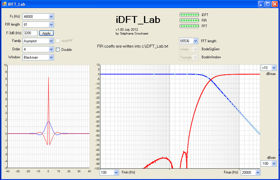

I enclose a screenshot of another filter type I've included: the Chebyshev. But it's not obvious I've gained much by it, in terms of selectivity vs. ripple and overshoot.
In iDFT_Lab, use Asymptot with Blackman windowing for emulating Chebyshev. As you can see, a 81-tap FIR is adequate. See attached .jpg.
Ah yes, you are quite right about my example being only 'Gaussian derived'.

Point for discussion: my naive 'linear crossover' gives excellent attenuation of frequencies at the outer reaches of the crossover region, but visibly low amplitude ringing and overshoot around the central impulse. The ringing, however, extends for a long time albeit at a very low level. We could 'round off the corners' of the frequency response directly (as seen on a lin/lin scale) to reduce the duration of the ringing, or we could window the impulse response to achieve the same thing. But in short, if we're designing a digital crossover filter, why do we need the maths and the filter 'brands'?
