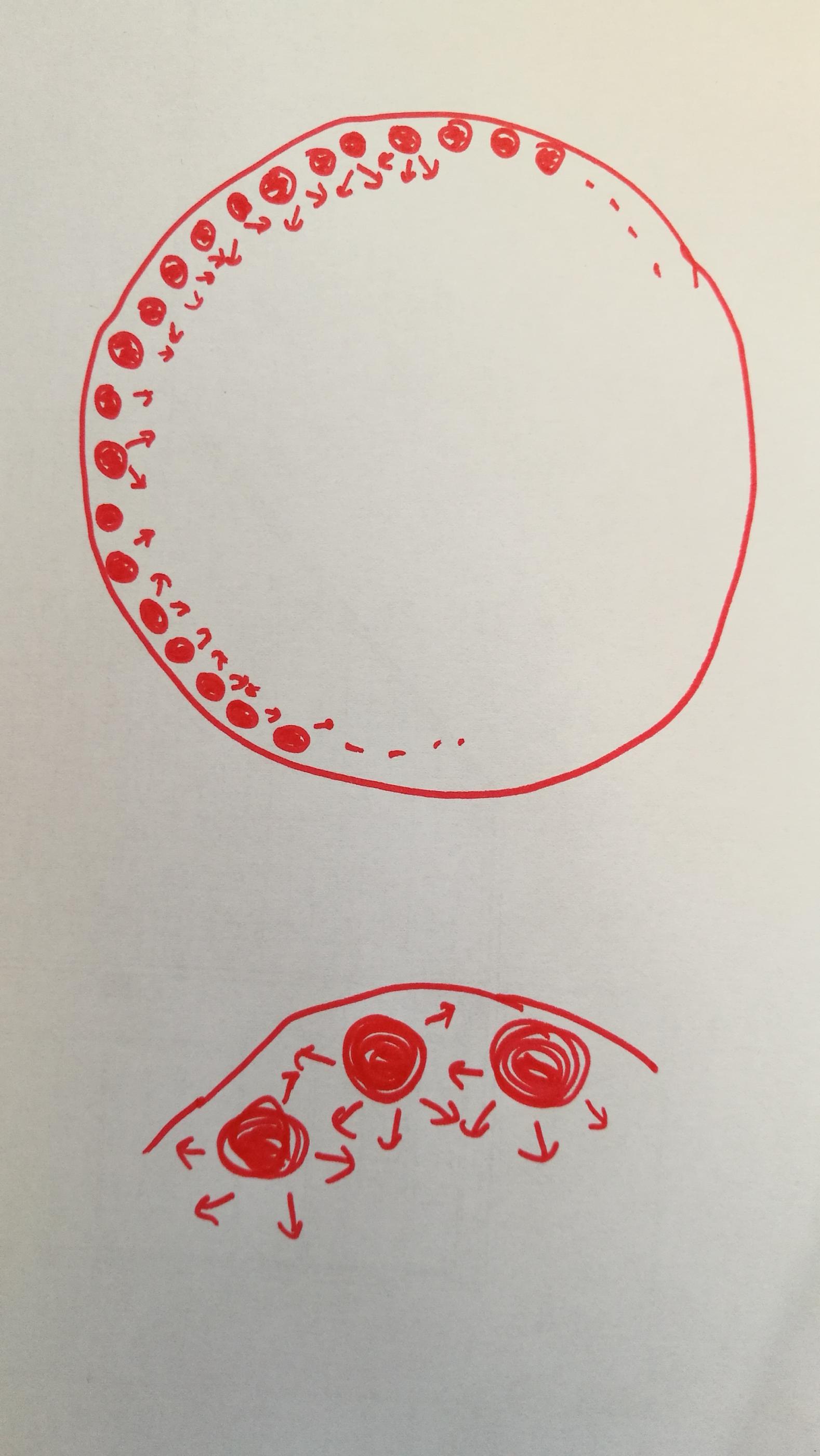

Thank you very much for your suggestion but 109 cm is really much for my project, probably (I think) due to the small diameter, so I'll go to a closed box. However, regardless of the loading typology I fear that the principle weakness of my idea is the ring portion of cabinet just around the magnet, forming a really strict duct just near the point of emission and possible source of harmful internal reflections as detected by Troel in his article (I can't chamfer this zone because there's not enough space): see red zone in this drawing:
So there are two solutions:
- covering magnet's or hole surface involved in this ring with a thin layer of right damping, hoping this won't obstruct emission;
- or a more radical solution, inverting driver's mounting leaving magnet at sight! I'll be able to adjust phase mounting it further back and inverting poles; usign this second I'll be free to treat internal surfaces as I'll want. At this purpose, may there be any difference in emission quality between front and rear for a mid-range driver?

Hello, finally I began to make some measurement, and I must say that neither frontward nor backward solution works well even with felt or other dampening, because in both I have a 1.0 khz dip which produces a sense of metallic taste in listening.
So here's what I'll be able to do without destroying everything:
I can build a bigger and deeper flange using multiple properly chamfered wood rings ending in an exponential polypropylene reflex tube, as visible in image, forming a path without parallel surfaces with a shape similar to what was previously suggested in this thread.
What do you think about?
Won't it be a problem the quite circular shape of the path section near the driver, in which however there's not any parallel surfaces?
How long is the pipe, approximate net volume of the bulge [less driver]? I mean a dip at ~ 1 kHz is ~34400/2/1000 = ~17.2 cm/6.77".

Hello, you're welcome! I didn't remember well, seeing saved graph in effect dip is at around 600 Hz and in effect your formula is perfect because 34400/2/600 = about 28 cm which is exactly my pipe lenght, as you can see here from the following gated measurements of midrange in the original project's straight pipe:
midrange reverse-mounted with felt all around internal surfaces of pipe;
midrange reverse-mounted without any damping;
tweeter's response, just for a reference.
It's clear that mid's response isn't quite good and I can ensure that this is very very listenable..
