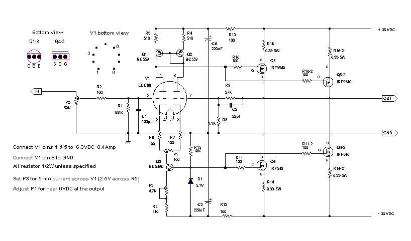

I would use the 6080/6AS7 over any tube for use in a hybrid amplifier, no matter the filament current, but by the sounds of what Wavebourn is describing.... I can't define the design that I plan on using as an hybrid amplifier because it is class "AB".
If only I understood the circuit topology more, because to me it is quite complicated to understand the mixing of tubes and SS, all I really want to do is get rid of the unfindable FET input on the circuit I have, and replace it with a tube instead, if it was so simple to do so...
But because this thread is for the class "A" amplifier hybrid circuit I probably can't get much help, although, for me the ultimate hybrid would be one that will run in class "A" up to a cirtian output level then go into class "AB" mode but the only amplifier that I have ever read that actually does that is this one...

The only fets that I have large amounts of are IRF630's and 640's and one or two 9640's, what I am trying to acomplish is to use the stuff that I have to build a half decent amplifier, but all that I have are BJT's and not only that but they are more than sufficient to produce the power output I want ( 100 watts 8 ohms).
I have gathered much information about hybrid amplifiers just from reading this thread, but not enough to confidently design one myself without some help from others.
But I think I will stick with your idea of using a tube preamp at the input, but I really want to get rid of the fet chip at the LTP ( I think) on the input of the amplifier for the reason that I would never find a replacement.
The only hybrid circuit I could potentially build is the one I showed earlier using 6SN7's.

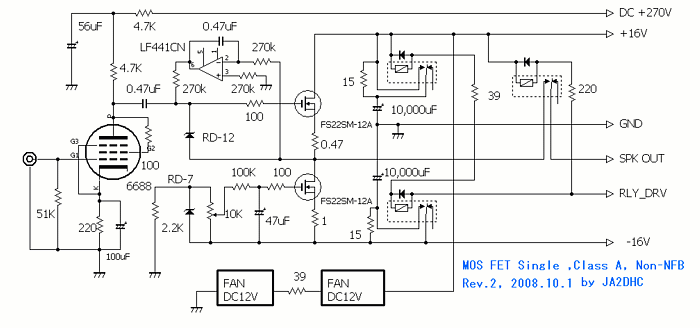

Hi, folks!,
I am now working on 100W Class-D hybrid whose schematic is shown in
my Web as below.
http://ja1cty.servehttp.com/class-d/ClassD-AMP.gif
Due to much less power consumption, it will be nice in Summer season.

Wow, that is the strangest design I have ever seen, how did you ever work it out? The circuit looks so unuasual to me that it doesn't look like it would even work, but it being class "D" would make it very efficient, too bad this thread is for class "A" hybrids but I'd sure like to try this circuit using the parts I have...
