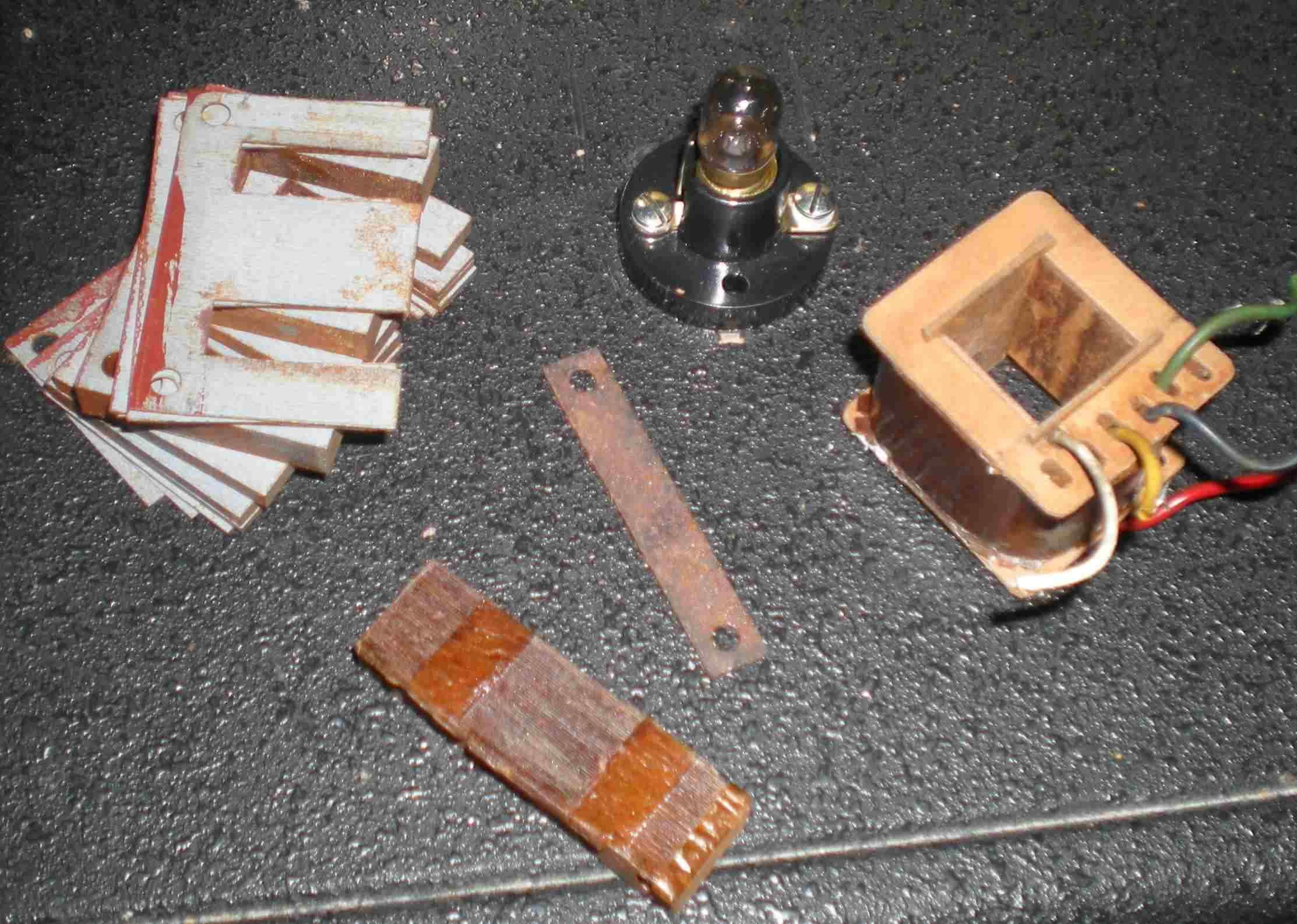

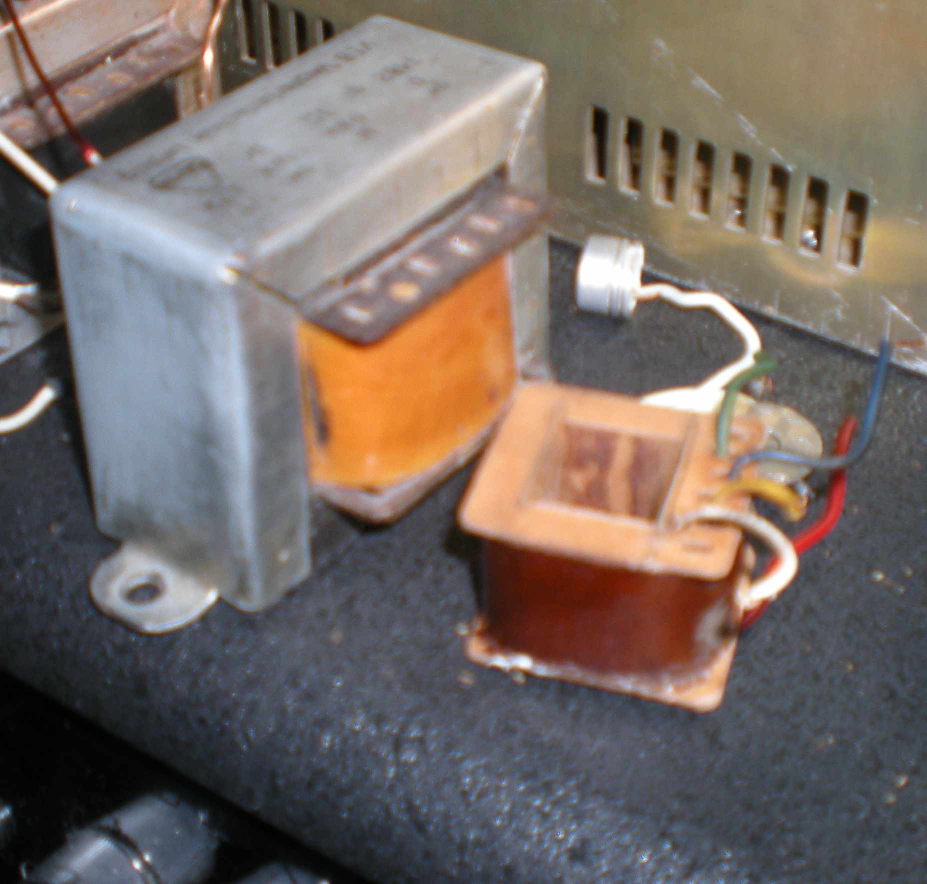

Minussss3db- Yes, the output transformer saturates and that makes a mess of power chords, bass notes, etc. I suspect it saturates because of its core - too small. I haven't had time to test the telefunken OT, this one I'm sure it has a gap but same core size so I will find out soon enough if it was the lack of a gap or the OT is just too small.

Negative feedback - A solution to some problems but, damn, this thing sounds boring with it.
Different OT - Didn't even try, checked for the gap, found it easily, LEGO friendly OT. As you can see Telefunken were also cheapskates.
It was pretty, it could play some tunes, it had a good life (a little short though).
BZZZZ BZZZZ....chainsaw sound in the background.....

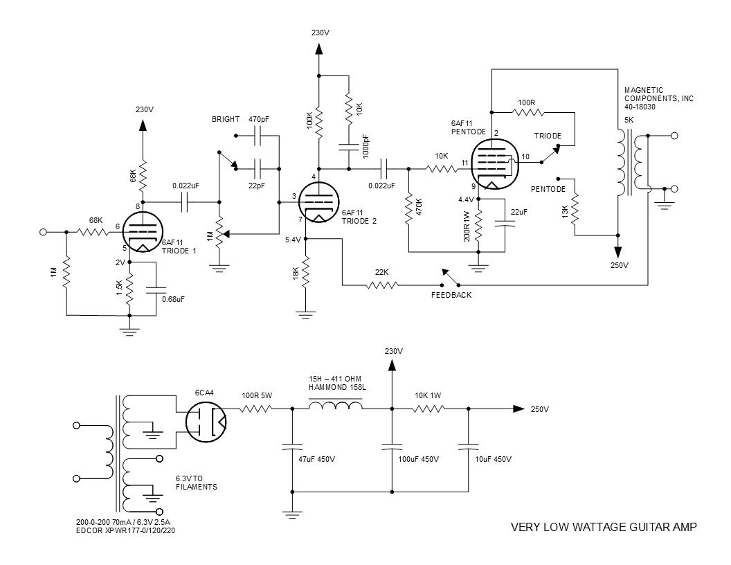

Another user asked for a schematic of the 6AF11 guitar amp I built so I thought I would also post it just in case anyone else may be interested.
I know, the power supply is WAY overkill and would work just as well and be much cheaper as solid state. If fact, I believe that voltage doubler circuit I saw somewhere in this thread that uses the Triad isolation transformer would be ideal along with a small filament transformer.
I already had all those parts and wanted a tube rectifier power supply circuit so that's the only reason I did it that way. The 6X4 would also work and is much less expensive if you really wanted to stick with a tube rectifier. In fact the PT shown in the schematic is not the exact one I used. It was a custom unit at a higher secondary voltage. I had to use a very large dropping resistor. I just picked an Edcor unit for this schematic that would make it close to what I actually built. That 15H choke sure makes it quiet though!

Scott, thanks for posting the schematic! It's a nice little amp, and how very nifty to come up with an entire three-stage guitar amp heated by a single filament in one bottle!
For a minute I thought the 18 k value of the cathode resistor for Triode 2 was a typo. Then I saw the "5.4V" marking at the cathode, looked at the tube characteristics, and realized how much bias voltage it takes to throttle this triode down to the point where you can use a 100 k plate load!
