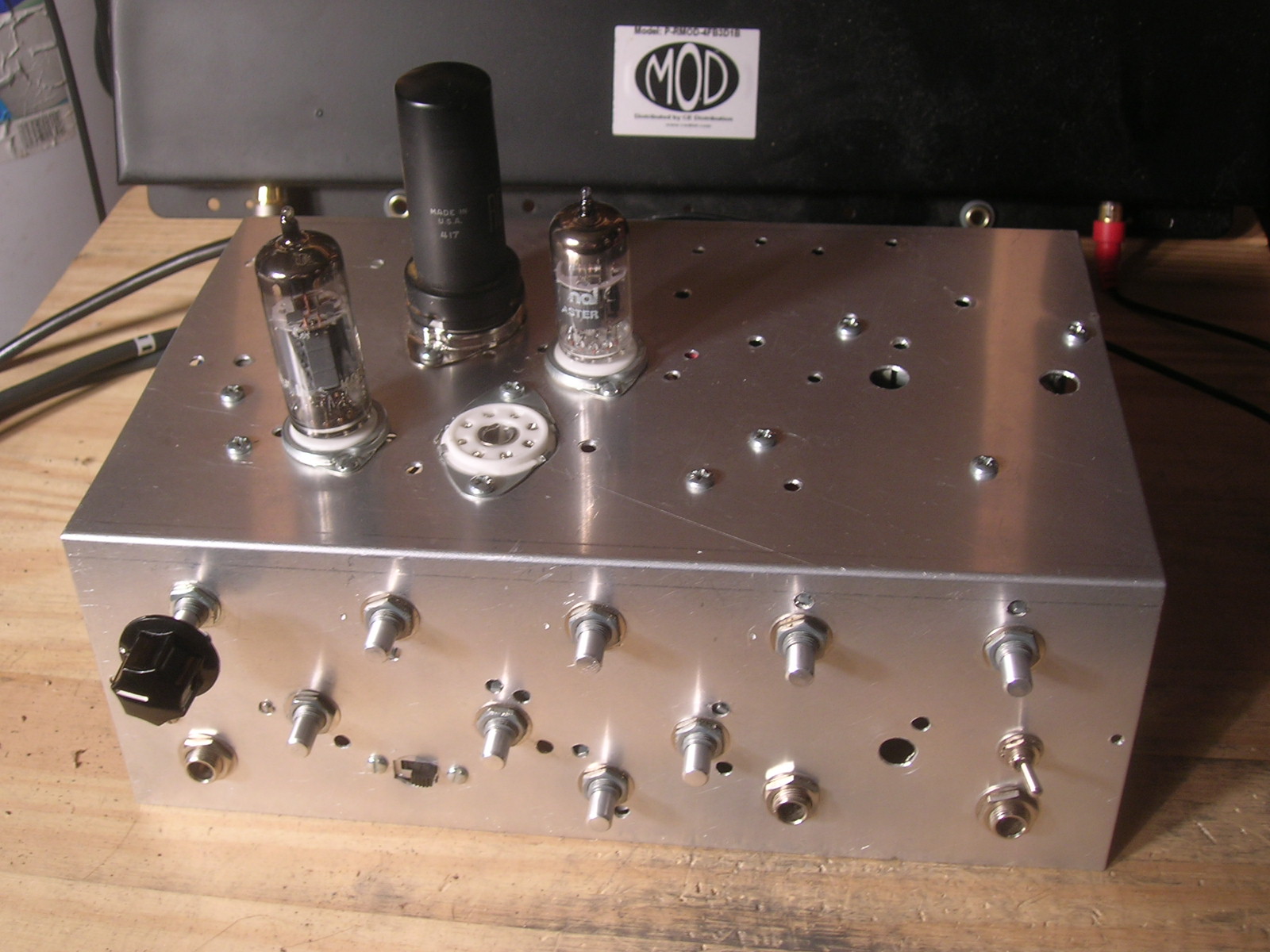

Here's a look at the little critter making all that sound.
Ain't much to look at, I agree. More an experiment than a prototype. The unused tube socket is for the 5-tube version of the amp. (Where's the fifth one go? In the sidecar.)
Not all of the shafts poking through the front panel represent connected pots. Some of them were just for finding out what values to assign to the fixed resistors of a voltage divider and at least one of them is for a control that isn't relevant to the three-tube version of the amp. Even so, not all of the connected pots will necessarily be needed. For example, some people might not feel the need for the reverb mix pot, saving its cost, since the send pot can also be used to control the reverb level at the output. The mid control could conceivably be replaced by a simple switch for someone with only a limited this/that need and a tighter budget.
Likewise, two of the front panel jacks don't connect to anything, which is why they're not in the BOM either. One is for optional footswitches that are not yet been designed into the circuit, but could control both reverb and gain using a stereo (TRS) connection. The other is for an optional headphones circuit.
Knobs? We don't need no gumfounded knobs. Just the one that controls the GAIN. (But if we did need knobs, we could still find a way to fit them in the budget.)
The MOD reverb tank in the picture is a 4FB3D1B. There are others that will work with the amp, too.

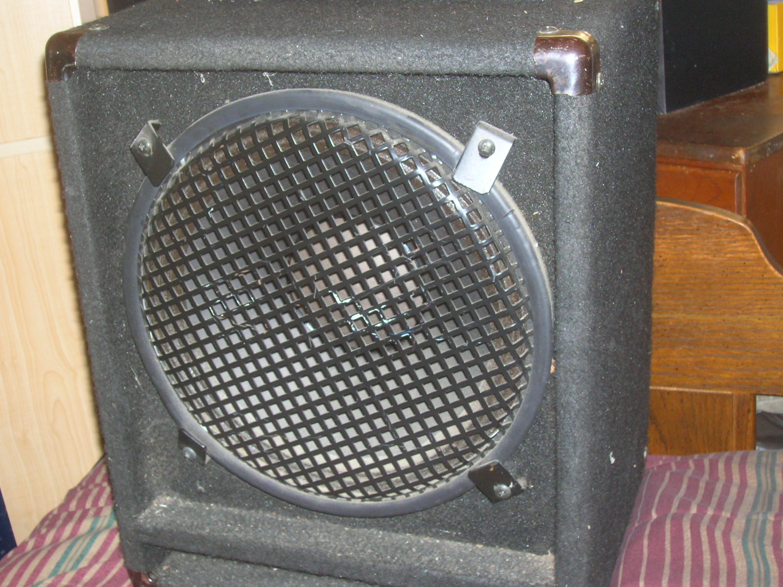

I don't know what kind of 12-inch speaker this is. I've never opened the box to find out.

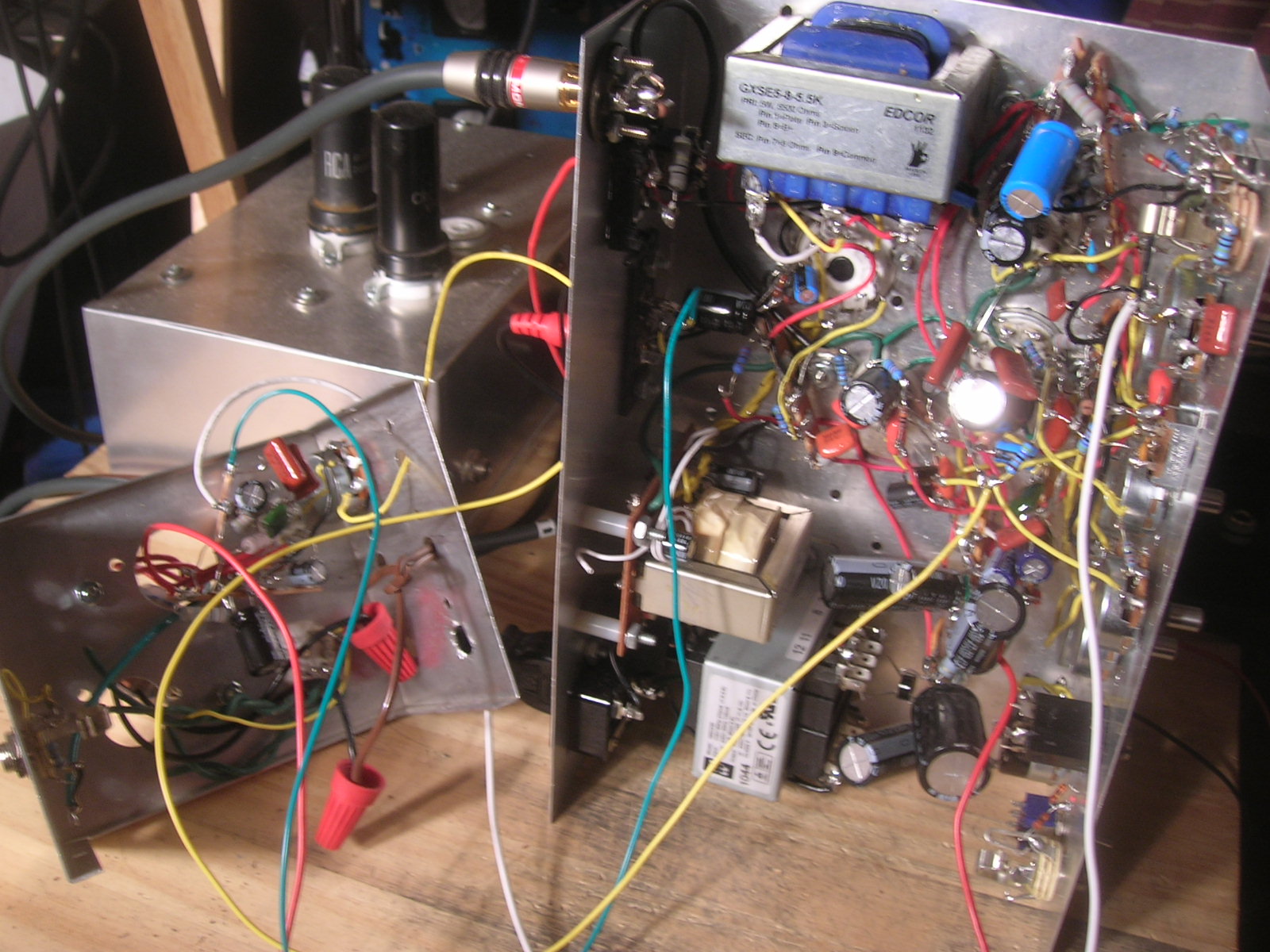

The point-to-point wiring is positively frightening to look at. Next task: find a way to lay out chassis and wiring that makes it less intimidating. Maybe use a tag board instead of terminal strips? I've seen some on eBay.

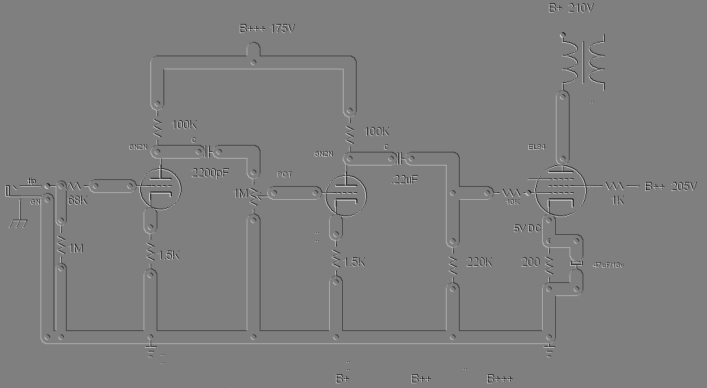

The simple elegance of that amp circuit is jaw-dropping.

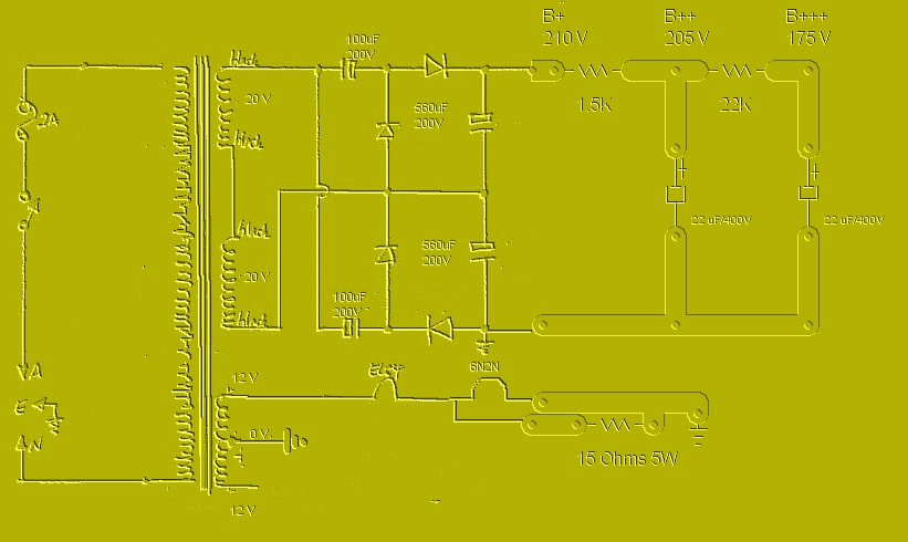

That 15-Ohm / 5W resistor in the filament circuit is pure genius.

I liked your voltage quad solution when I first saw it a week ago, as I said back then.
Either things are very expensive in Madrid, or one of us is going to be abjectly shamed by your total cost of materials.
Printer, there are many types of paraphase splitters, I'm not sure which one are you talking about. Anyway, if Fender didn't have a problem why would you?
They went away from that style of inverter, maybe they had a problem. Just doing a back of napkin calculation it looks like the 12A*7 triode will be biased close to -4 volts but I could be wrong.
Thanks for your kind words Tubekit.
According to the rules I'm out not in. Vintage, unobtainable parts aren't allowed. I expect to be allowed to participate in the poll but that's it. I don't really mind, this challenge is between you and Tubelab, and the ironic thing is that it was so from the very beginning. The rest are mere decorators. Again, I don't mind being a decorator. Maybe Printer does mind but I doubt it. He's having fun just like me, same happens with all the people who are still following this thread. As a bonus, we got one amp we didn't have at the start of this challenge.
Printer, I've experimented with paraphase splitters more than once. I love in particular that phase splitter you posted but I would only use one resistor. Tie the cathodes. Download the Ampeg B15N schematic to know what I'm talking about.

I updated the schematic to include component values. They are lifted right from the board that is used in the amp. Some capacitors may have a higher voltage rating in the spreadsheet because the price is often better on 350 and 400 volt caps. I used surplus 200 volt parts to build the amp, which runs on 160 volts. The spreadsheet will be posted late tomorrow or more likely Friday.
